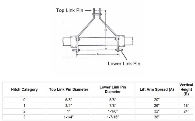

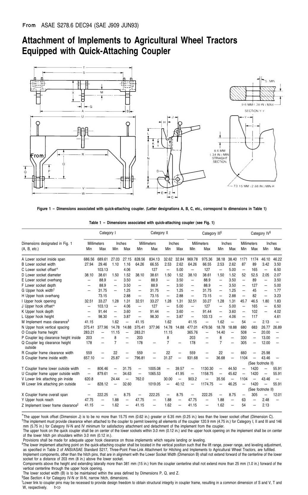

Hi I have a 870 4x4 John Deere, when tractor supply opened in Maine ,I purchased a Speeco quick hitch. then the fun begain ,my lineback hd scraper blade would not fit do to it offsetting so I had to use the yoke adapter problem solved then I bought a tractor supply Quick trailer mover, the pins was class I the top link was class 2 ,and to find out too wide for the speed hitch, so I cut it down and made new pin plates and welded them on to find out the top would not fit.i was so mad I had the wife get me pat's easy change problem solved I thought till I put my 666 john deere blower on it and I could not hitch it up / I made new arms for the blower now it fits problem solved. now to fix the top link clips on the Quick trailer adapter, I cut the old ones off and made some new ones, I just would like to know the class I match Measurements so I can weld the clips back on any info would be great Thanks Mark

Hopefully something here can be of assistance;
