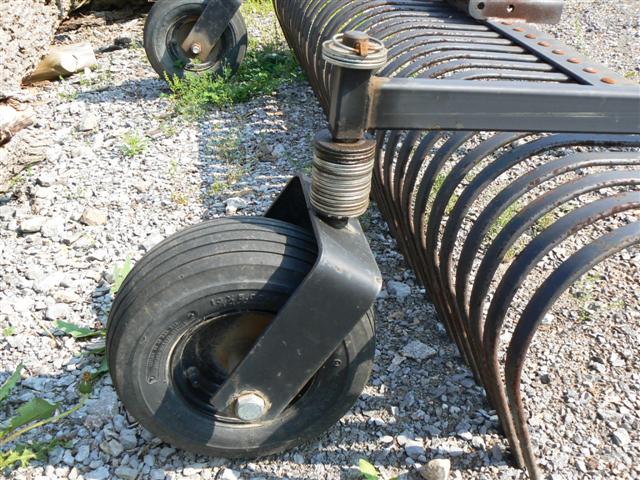

Gauge wheels can be purchased separately with your landscaping rake. You will find they are somewhat expensive, like about $250.00 for a pair. They will help to a certain degree but still may lack the ultra-fine raking you may want to do. The real finish stuff will need to be done by hand.
   / Cat 1 hitch - Float like a Butterfly? #7
Bob 97526, Have posted this before on gage wheels for scraper blade and landscape rake. Caster kits are available from Worksaver. Worksaver Landscape Rakes Good luck, Ron.

For my boxblade I made up some skids, works great, for the rake maybe use UHMW, common puckboard, I tried casters but they allways sink into soft ground where the skid rides on top, remember to make a ramp both ends so when you reverse it can not dig in
