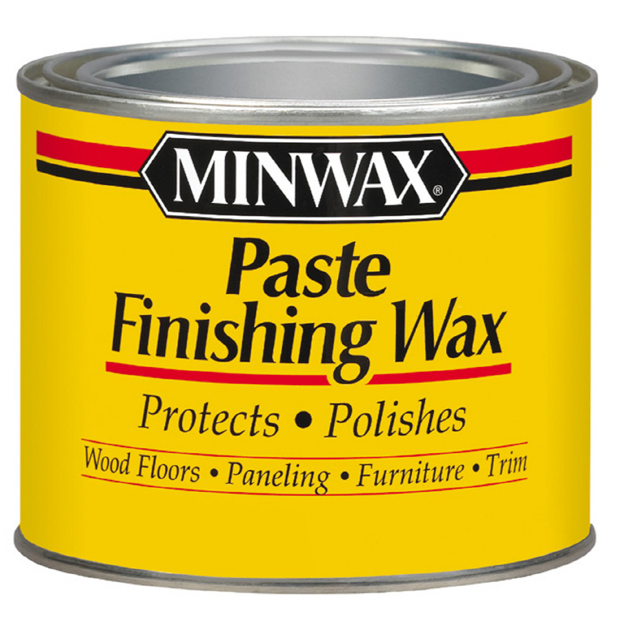

Has a couple rust spots starting...
What can/should I use to coat it with to protect it?
I'm guessing something like mineral oil? (light coat of course)
How about something that I already have on hand, peanut oil?
   / Cast iron routing table.... #2
I like paste furniture wax. Clean up the rust spots with steel wool then apply the wax, it protects and the work piece glides across the surface really nice and smooth.

Yep, don't put any kind of oil on it as it will come off on the wood. Use a wax.

MinWax paste wax is what I use. Cut off a chunk of it and put it in 2 layers of cheesecloth. Rub it on the table top, take a break, and buff it out. It lasts quite a while.
