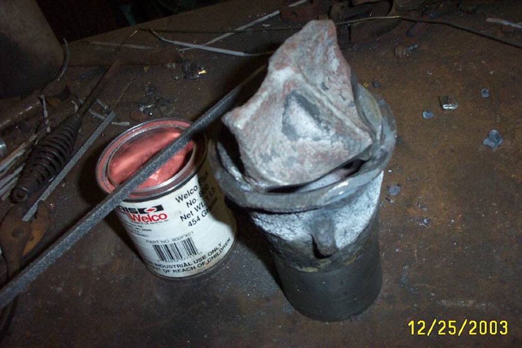

On another tractor forum I belong to the discussion of cast iron repair came up. I ask one of the members there who owns a machine shop, and does a lot of cast iron repair if he would post his technique. Later he replied, and wanted me to email him my telephone number so we could talk welding and cast iron repair. Boy what an education he gave me! I asked him if he would mind me posting his web site here. He also had me look up this other website.
Just thought I'd pass all this along.
Under the picture of George's shop is a link, Many more photos, click on that link!

Boy did I get an education! I thought I had a clue, come to find out I was clue less.:eek:
Here are a couple pictures I snagged off his website that I thought were very interesting.

Yea, we learned about that back in automotive tech school. They called it spray powder welding. That was the preferred method for fixing cracks in cylinder heads and blocks. Neat stuff:thumbsup:
I'm pretty sure that is what yomax4 does. I've never seen a spray power torch.

My limited experience welding castings has been good.
1) V-groove, drill holes at ends of any cracks.
2) Preheat, Ni weld only an inch or less, peen gently and then cool slowly.
3) Repeat #2 until complete.

start with practicing your brazing, i was amazed at how good a joint a properly groved and brazed piece of cast will turn out.
