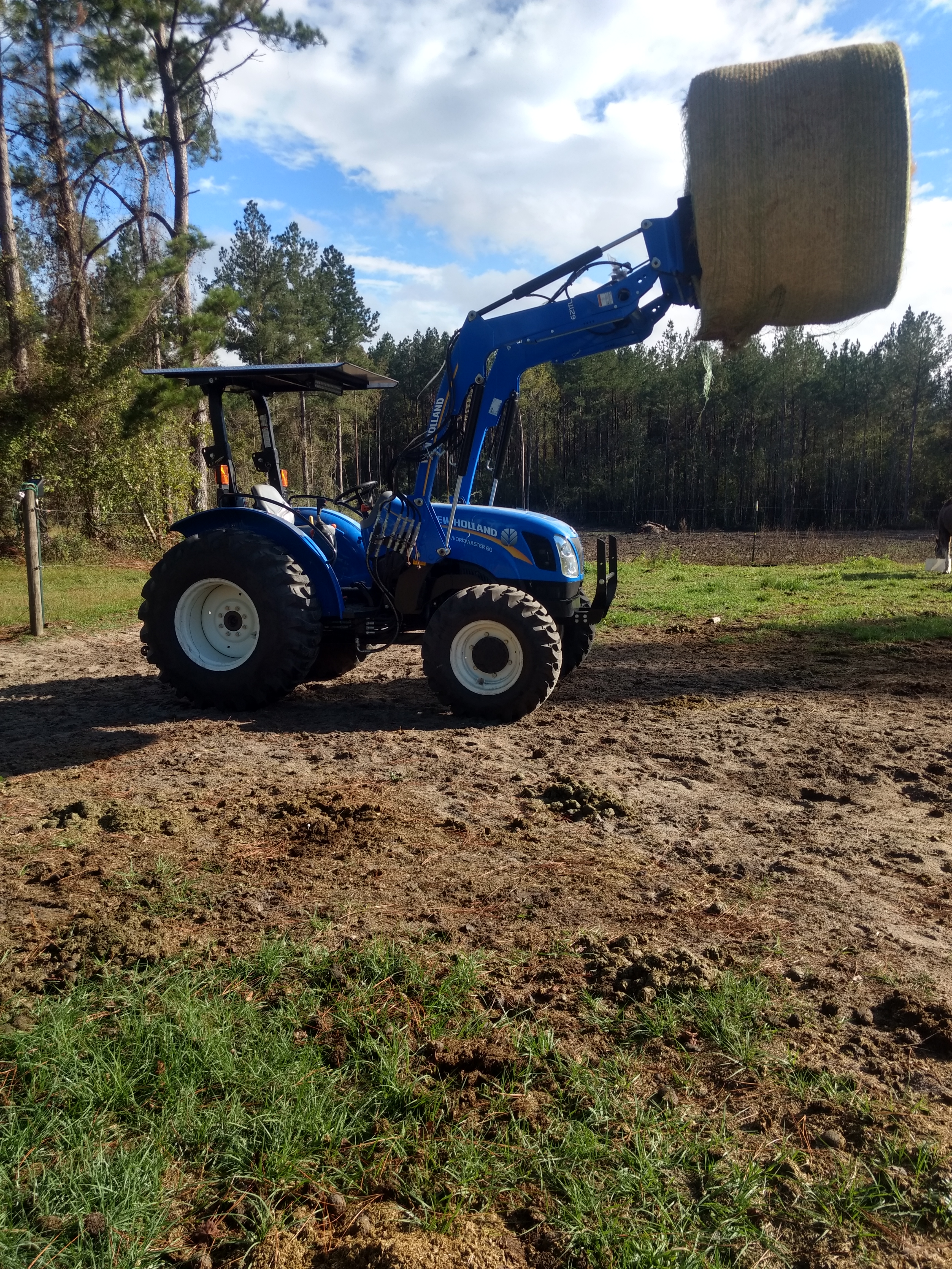

Like Truby said the Workmaster & Case Farmall A series are twins with different paint. Not sure why the loaders they are fit with would be so different but Case does say the 555 loader only has a max Lift of 1782lbs full height at the pins, which is crazy since the NH Workmaster 621 loader is 3550 lbs. Look at several other big leading brands and really research the Loader specs.
I have a Workmaster 60 with 621tl loader and have been nothing but happy with it. I have horses and move/stack round bales, but I don't run a Hay operation so I can't speak how it will hold up to it daily. But I do think I would want a larger and heavier tractor for running big bales around on a daily basis.
Here's a pic of my Workmaster with an 1100 lbs round bale at full height. I only stack two high, but I think there is pretty feasible to be done.
