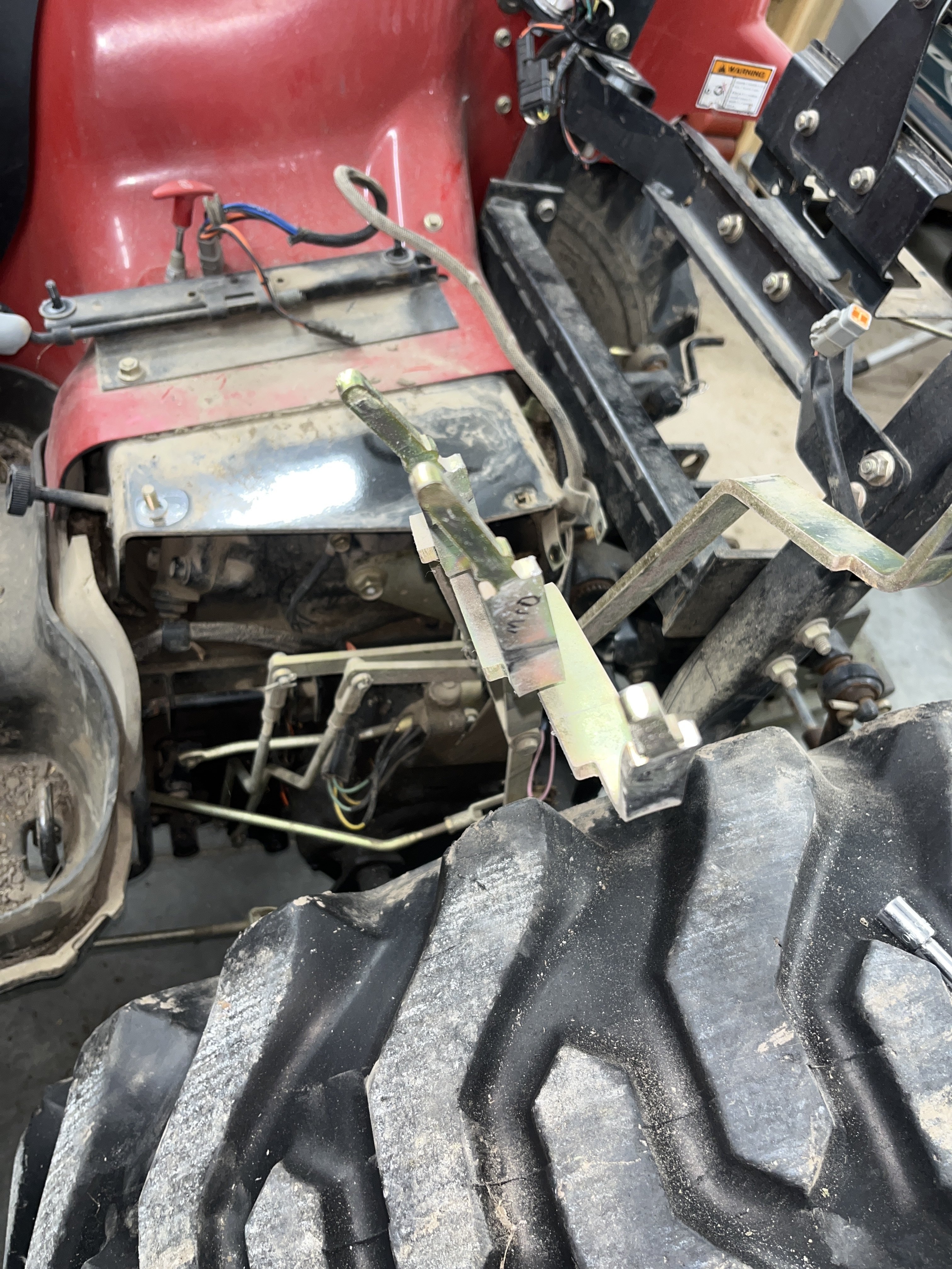

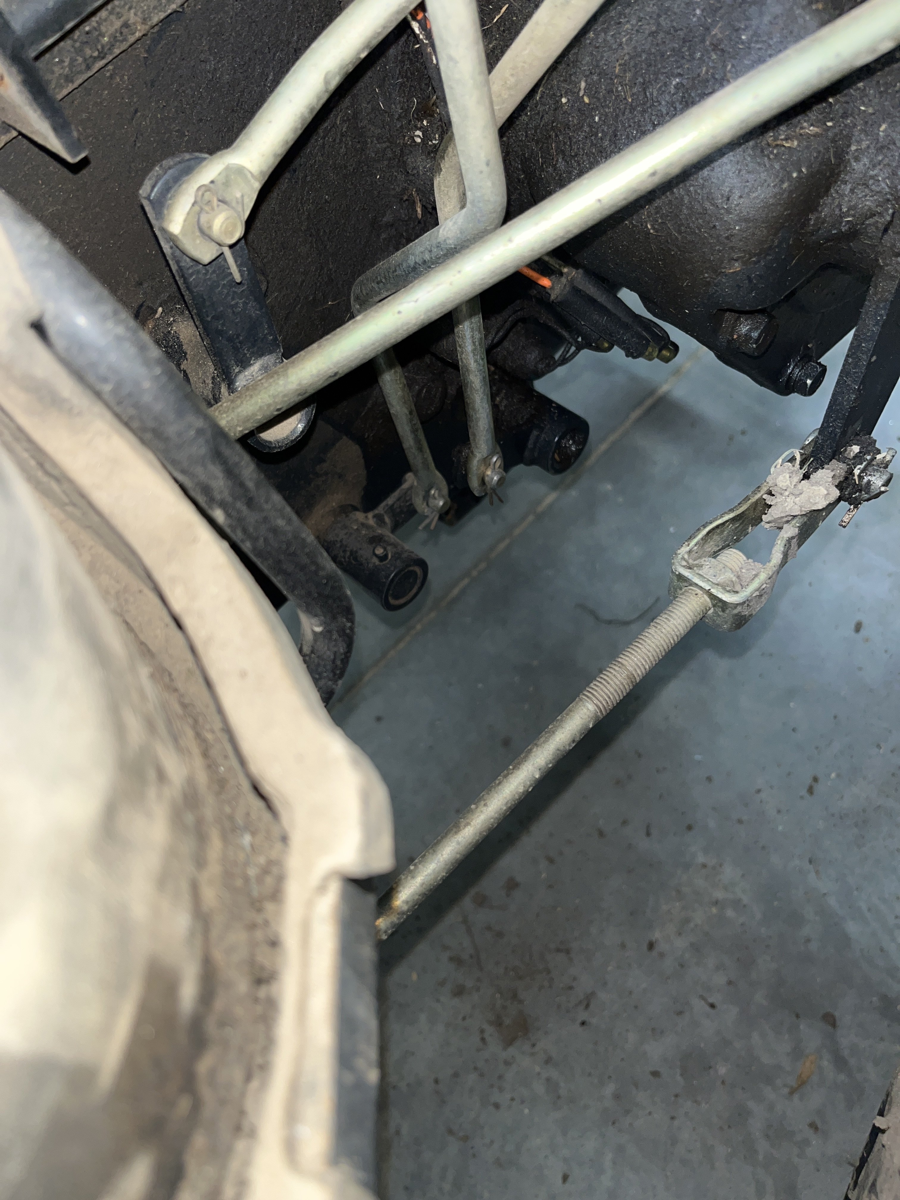

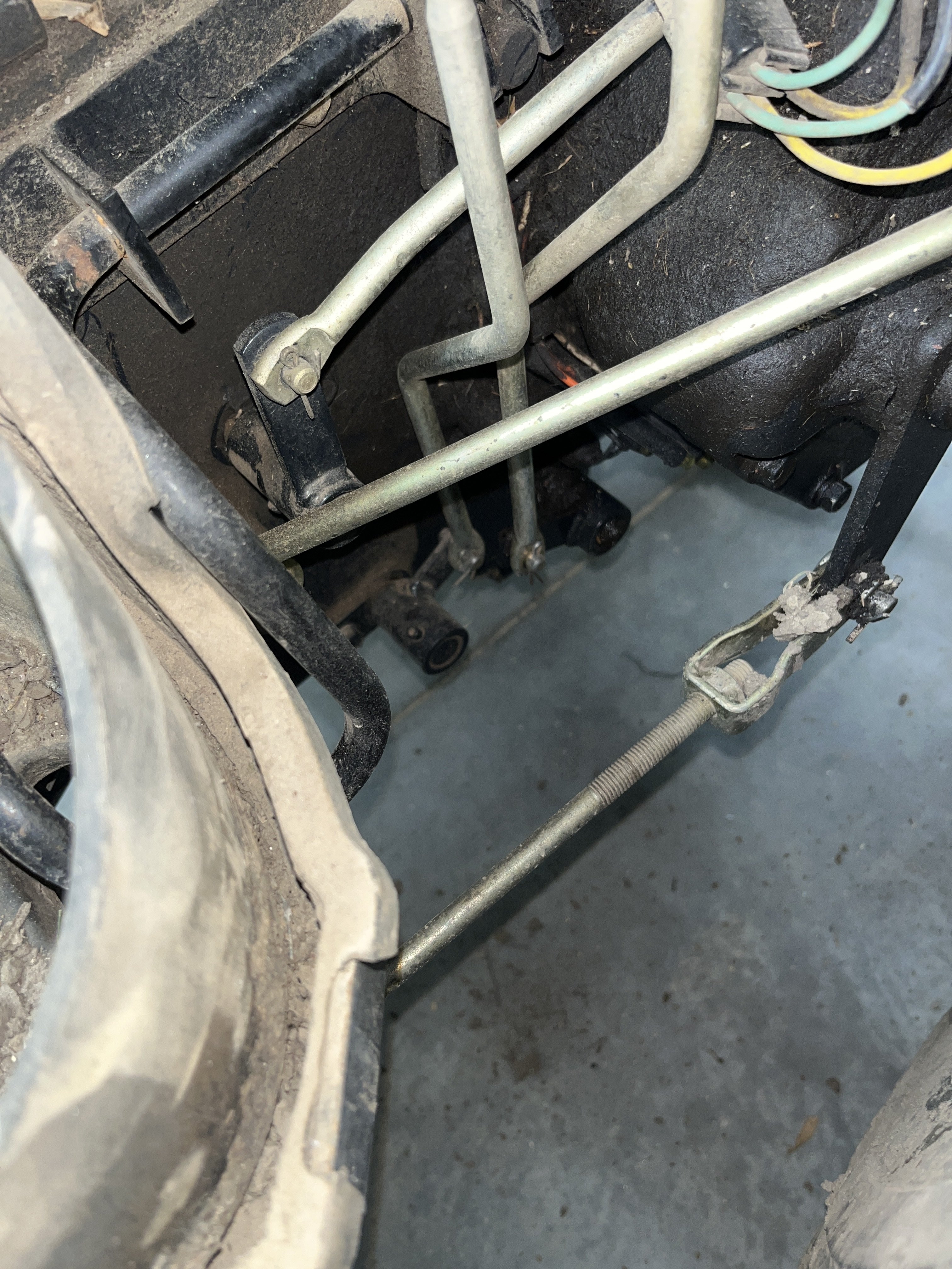

My pto lever dosnt want to stay forward when under load. With nothing attached to the tractor it works as it should. I removed seat and fender and looks like the lever works as it should there too

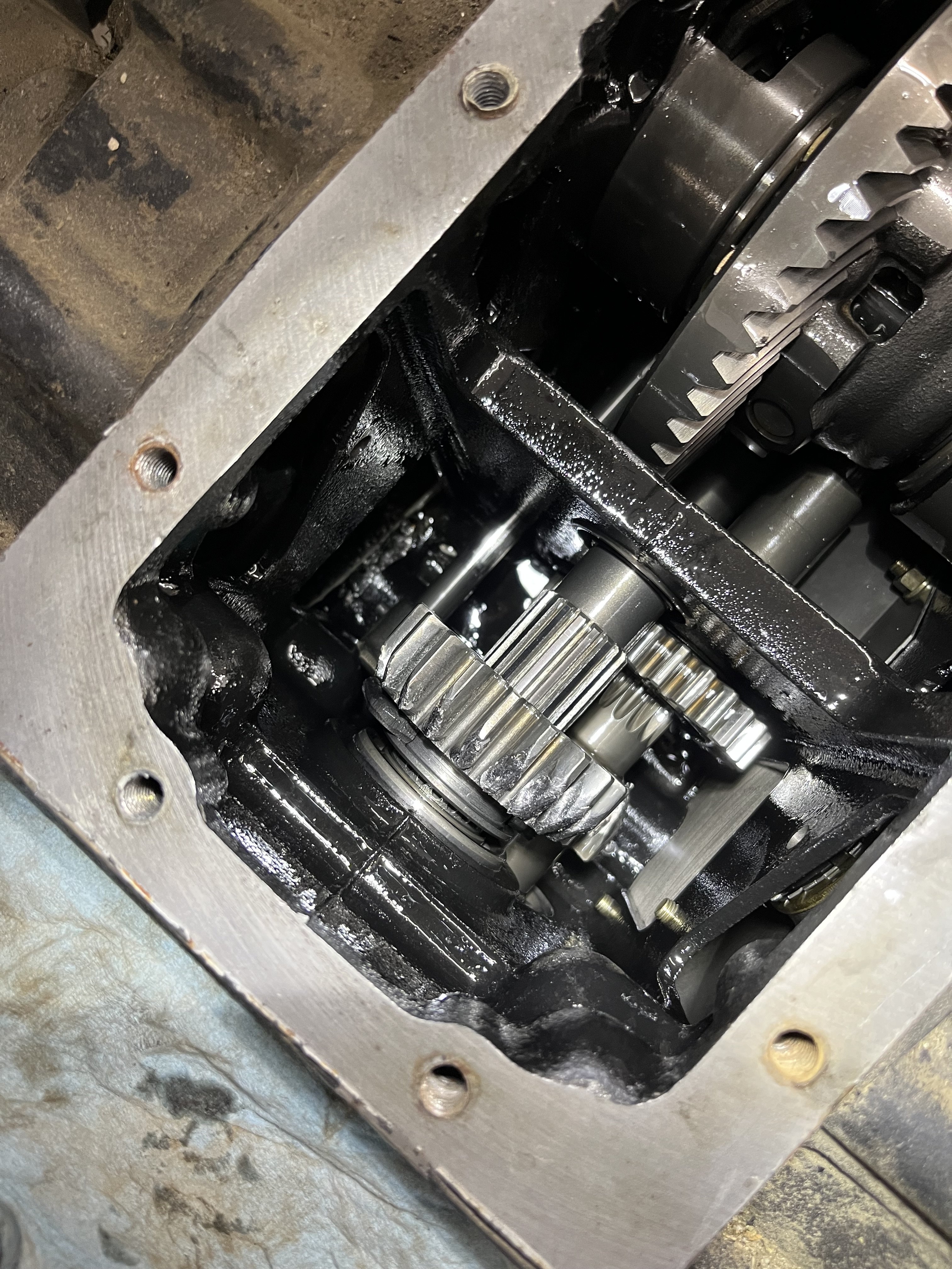

I think you're missing the point. Your problem Isn't with the shift linkage. It's in here.

Thank you. I do agree that it seems inside the transmission.
I am looking to converse on how to fix it. Should i assume that i need to remove both fenders and work toward draining the oil from the transmission and get the top cover off? or is the problem area accessible somehow else?
   / Case-IH DX33 PTO not staying in gear. #10
Please confirm by disconnecting the linkage and checking that both detents are being met before digging into the tranny.
