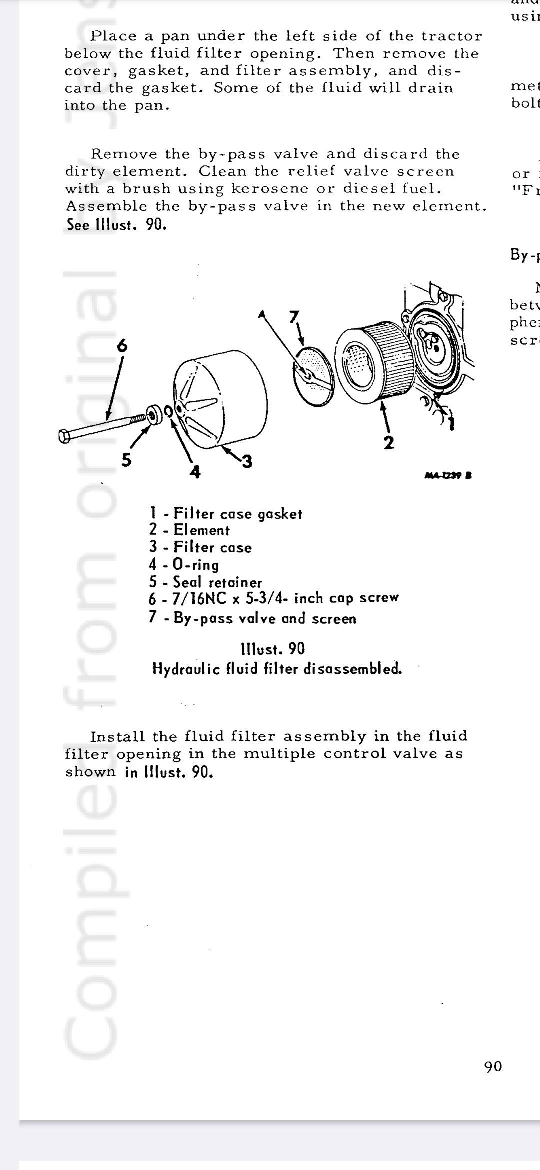

On the way home I was thinking about it and realised that I put the strainer on the wrong side of the filter, so maybe if I fix that it might get working again? I'll find out when I go back and put it the right way around. But then I got to thinking about whether I should replace all of the fluid, hence my original question.

What I mean about the strainer is that I reassembled it in the wrong order. Got number 2 and 7 the wrong way round in this pic. I mention it because I may have fixed the problem by cleaning out the filter but created another problem by reassembling it incorrectly.
Anyway, thanks for mentioning about the loader relief valve. I'll add that to the list of things to check out when im next there.
At the moment the issue is just the loader, but previously the 3pt has also been a problem.
