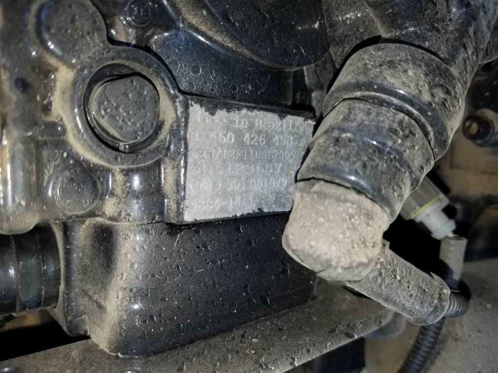

I have a 2009 Case Farmall 95. It started having problems awhile ago.
It will idle normal & sometimes run normal but after a few minutes it will start surging and blowing white smoke from the exhaust.
If you take it back down to idle it seems fine.
It has a Bosch pump.
Here's a couple videos of it running.
Case Farmall 95 - YouTube
Case Farmall 95 @ idle - YouTube

Have you changed your fuel filter lately? That's the first thing I'd be looking at, as they can cause all kinds of problems.

It has a new filter. I also changed all the lines from the tank to the filter. The old ones were so brittle if you moved them they would break.
While I was doing that I drained the tank & checked it. It was clean. No water or trash in the tank.

The next thing I'd check is, are you getting any air bubbles at the injection pump, from a possible air leak...
Does your tractor have a "lift" pump, is it weak?
Is there a screen in the back of the injection pump by chance? My dozer has a little brass screen in the back of the injection pump at the inlet, it was partially plugged and limiting fuel, to the pump.

It has a clear inline strainer before the lift pump & you don't see any bubbles in it.
It does have a mechanical lift pump that works off the engine. It has a lever on the bottom of it to prime the filters.

My 1st thoughts are a weak lift pump..

I also would be checking that lift pump closely...

at 25.00 I wouldn't even bother making a pressure tester..
   / Case Farmall 95 pump or injector troubles.
Have a pump coming. It's supposed to be here Thursday.
The tractor started up & ran normal up to 2400 rpm. I used it to check cows & it ran for about 45 minutes before it acted like it ran out of fuel & died.
It started back up & would only idle after that.
