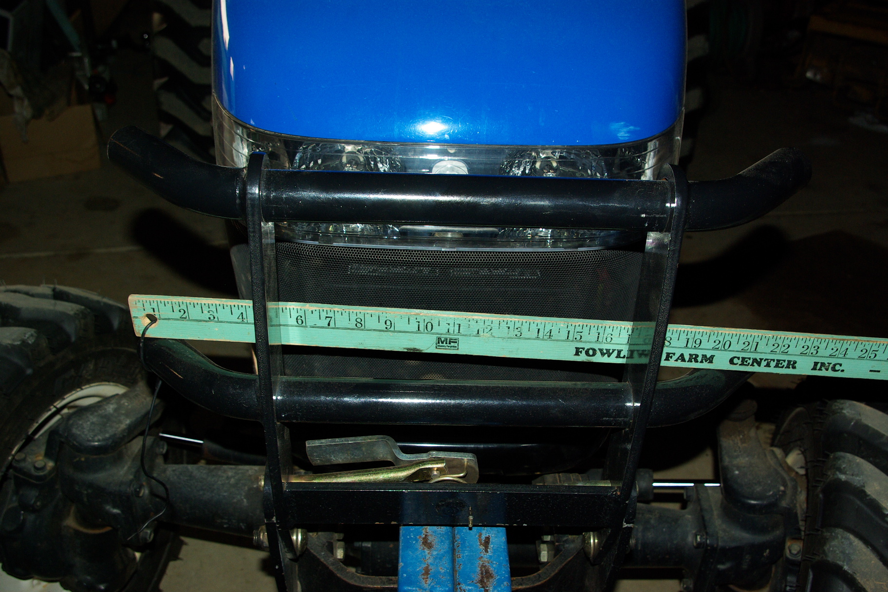

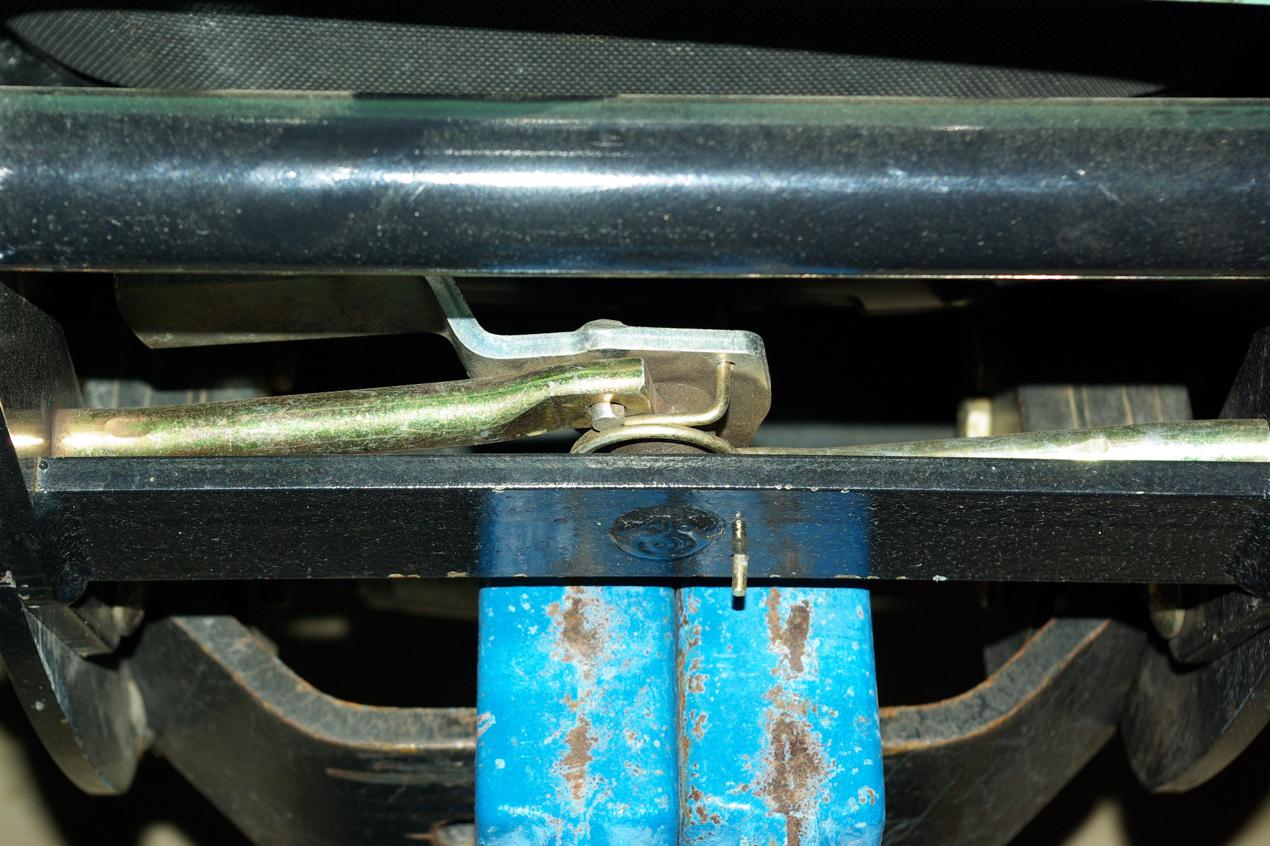

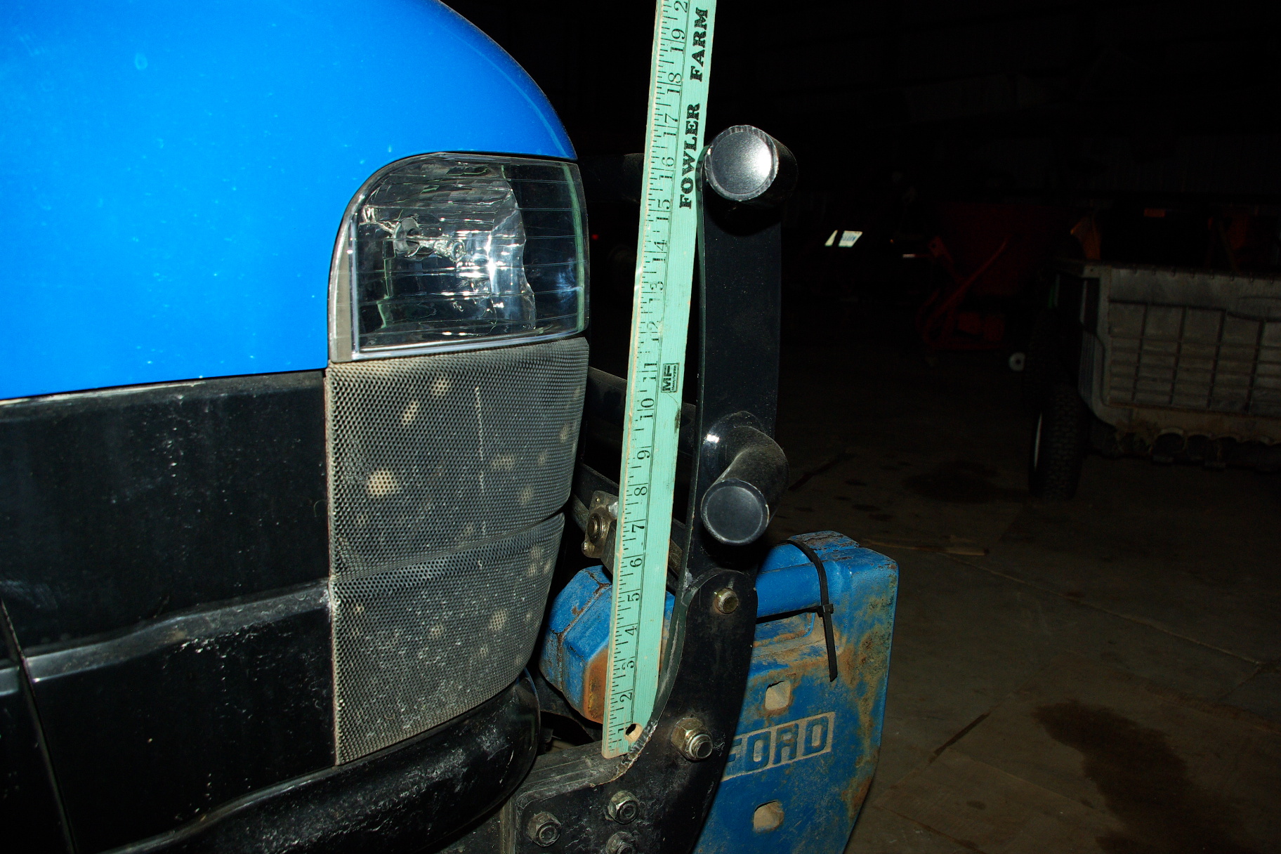

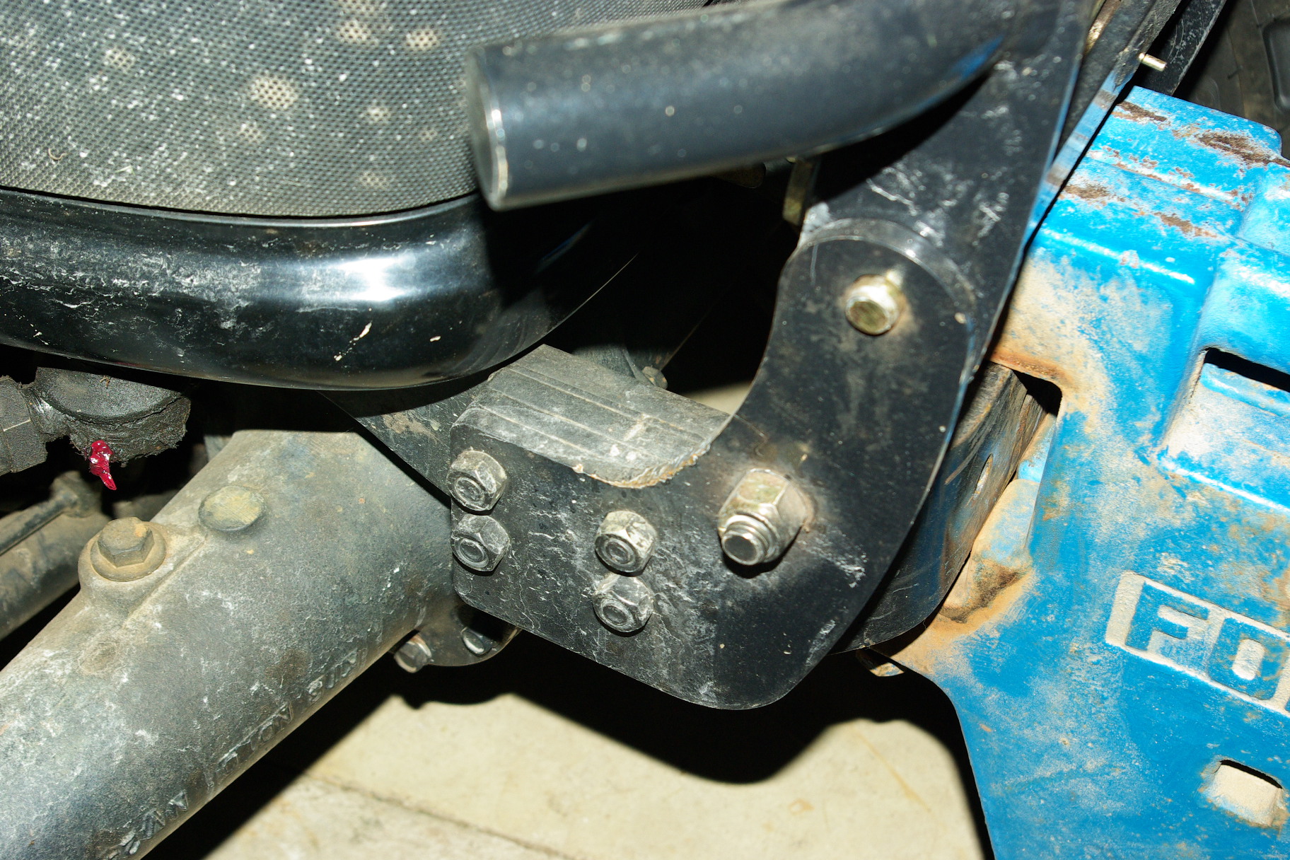

I picked up a like new CASE DX33 Farmall which is just a red TC33DA. It has the 14la loader (CASE LX114) but does not have a grill guard. From a little looking online it will cost me right around $500 for the kit from a dealer, while this is probably the way I will end up going, I do have a nice welding and if possible I will try and make one myself. Also it looks like the guard pivots to allow the hood to open?
Can someone help me out with some basic dimensions to save me some time ? Thanks!!
   / CASE DX33 Farmall (TC33DA) grill guard dimentions #2
Sorry for the delay in response, been farming this week. Here are some photos and hope they help you out. Another option is to Google the part number and you should get some hits on dealers who have that part in stock. Give them and call and they may be willing to make you a deal on the old stock price.
   / CASE DX33 Farmall (TC33DA) grill guard dimentions #3
If you go the homebuilt route, you should consider extending the guard up and over the front portion of the hood to protect from falling debris over the top of the bucket. And yes, the guard does pivot forward to allow hood opening.
Good idea and thanks for the pictures! That will help, if I build it it!
