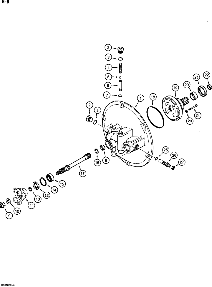

Justin,
A little more info please?
There's a serial # break in the 550 dozers at JAK0013968.
I'm going to assume that he's talking about torque convertor seals also, since the actual transmission seal would require only the removal of the driveshaft between it and the torque convertor for replacement. Also, the torque convertor housing is what bolts to the engine, not the transmission housing.
The torque convertor drives the transmission charge pump, very much like the automatic transmissions in cars. There could be wear on the stub of the convertor that's damaging the seals. There could also be wear in the bushing inside the charge pump that's allowing the stub of the convertor to move enough to damage the seal.
For the later models, after the serial # break the convertor seal is a $21 part. Before the serial # break it's a $40 seal, but both require removal of the convertor housing from the engine.
Take a look at the attached diagram for the later models. Items 20,21 and 22 are the seal and bushings.
Hope this helps!
Mark
