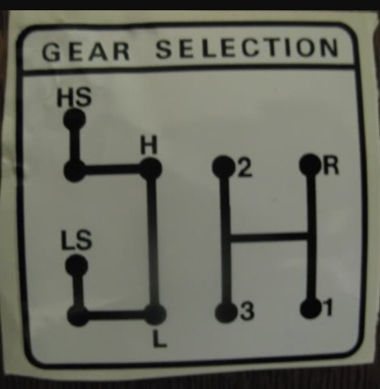

   / CASE/DB 885 Troubleshooting and repair #5
I tried to type this out but a picture borrowed from online is better.
The S will be lower than the main range. So HS is slower than H and LS is slower than L. Seems like there is overlap in HS with L and H. I can't remember ever using it.
LS is great for garden work.

I was thinking the slow low or slow high would be better for loading/unloading off the trailer when I have heavy equipment on the back. I'm not sure what all this tractor will get used for yet, but interesting enough I found the owner's manual to this thing in a file cabinet and it showed just pushing the lever over to the left, not left and up like you show in your decal. I used a sharpie to write on the pattern on the case for now.
