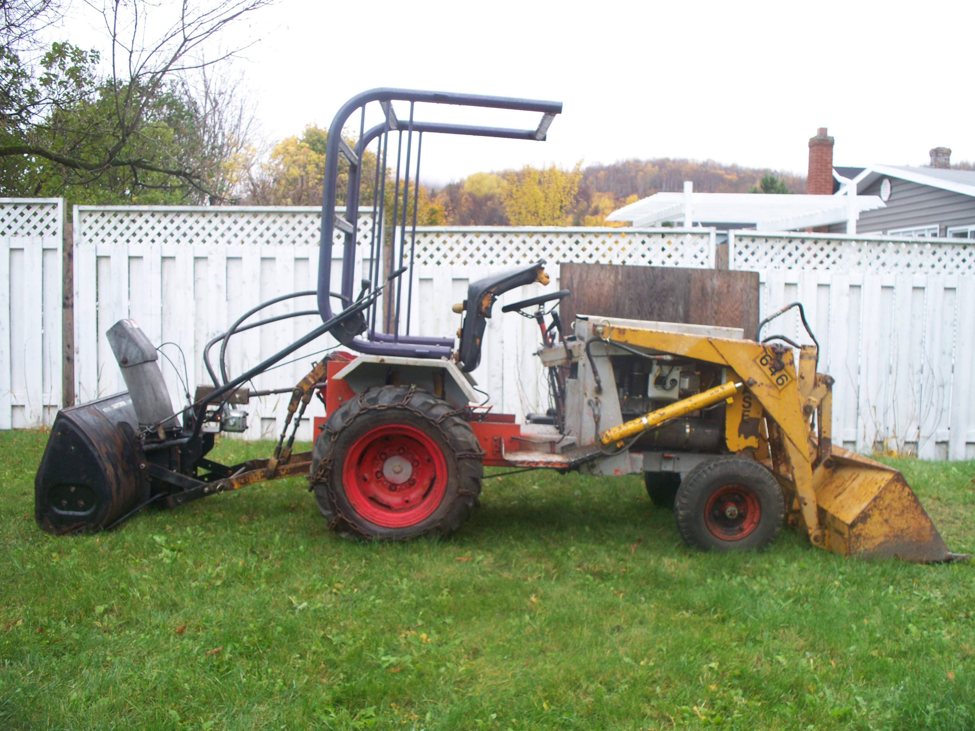

Hello everyone!!! My name is Mirek but I prefer SKUTER Ferst littil histry . I get my CASE 646 bifor 2000 ,disasamble wyth broken engine .First deside to extend frame to get more speis for feet, extention 6" front of transmition dissasamble complitly salage allwhot wos possyble .After clining, paint and assamble . I repower from oryginal 16 Hp Onnan engine to 26 Hp Onnan horyzontal shaft . Work for ower 10 years .At 2001 finishing transport over 20 Ton of gravol engine seeze my folt didynt chek oil . Now repower once agein but with vertical 26 Hp Brigges-stratton engine of cours all hydraulic must be change .Desaided to add snowblower power from maine pomp 12 Gpm .I bot extra valve to run snowblower engine 6 Gpm 9.5 Hp with reduction rpm ~3-1 (42 " Craftsman snowblower ). Valve was maschine to get power beyond.After assamble all together at first December 2014 start working ??? . One was very could and same connection vere not tide enaf so lost oil very fast , leiter figurait that valvs internalli licking as much so if snowblower opereit is not enaf preasure to drive machine .Now dissaid buy new set of valves. Picture attach .If enyone have question please ask. Skuter 100_1729.jpg sory i don`t know how insert pictures.:confused2:
