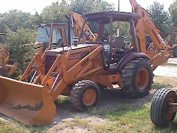

I'm looking at a 1989 Case 580K,4500hrs. 4x4. Bottom line price is $18500. I have never owned a TLB and I am wondering what I need to be concerned about in a used machine like this one. I would appreciate any input.

Looks like fresh paint and hit by vandals as the glass is out. How about all the gauges? fuel tank? vandals are clever sometimes.
Seems like a lot of money for so many hours.
   / Case 580K $18500 #3
Used to be a cab machine and they stripped it.... Possibly to fire damage?? just speculating... All the lights are missing, typical...
Fresh paint and stripped cab don't give me the warm fuzzies...
Picture aside, Stuff like sloppy bushings in the hoe, leaking hoses, seeping gaskets, are clues to rough use.
Check the cylinder rams for scratches or scoring... leaking seals are not the end of the world but are somewhat a pain to change.
Check around the turbo for oil leaks, Could be the turbo seals going out... read as $$$.
Check the radiator for discolored coolant, milky stuff or oil could be head gasket, Rust means it's not been changed recently, if ever.
Check oil, Really dirty is not good, really clean could be a recent change to hide some of the above. Use Gut here...
Bent cab steps is almost normal use.... Rarely see a rig without at least one bent.
About all that comes to mind at the moment...
$18k is typical market asking price on a K these days. For my money, that's high for hours and condition... Heavy options or not... $14k for average up to about $16k for primo condition with cab.

I really appreciate the responses. I think I will probably pass on this particular machine. I'll keep looking around and learning about these machines.
