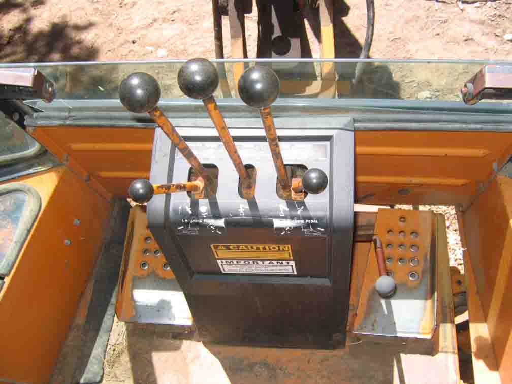

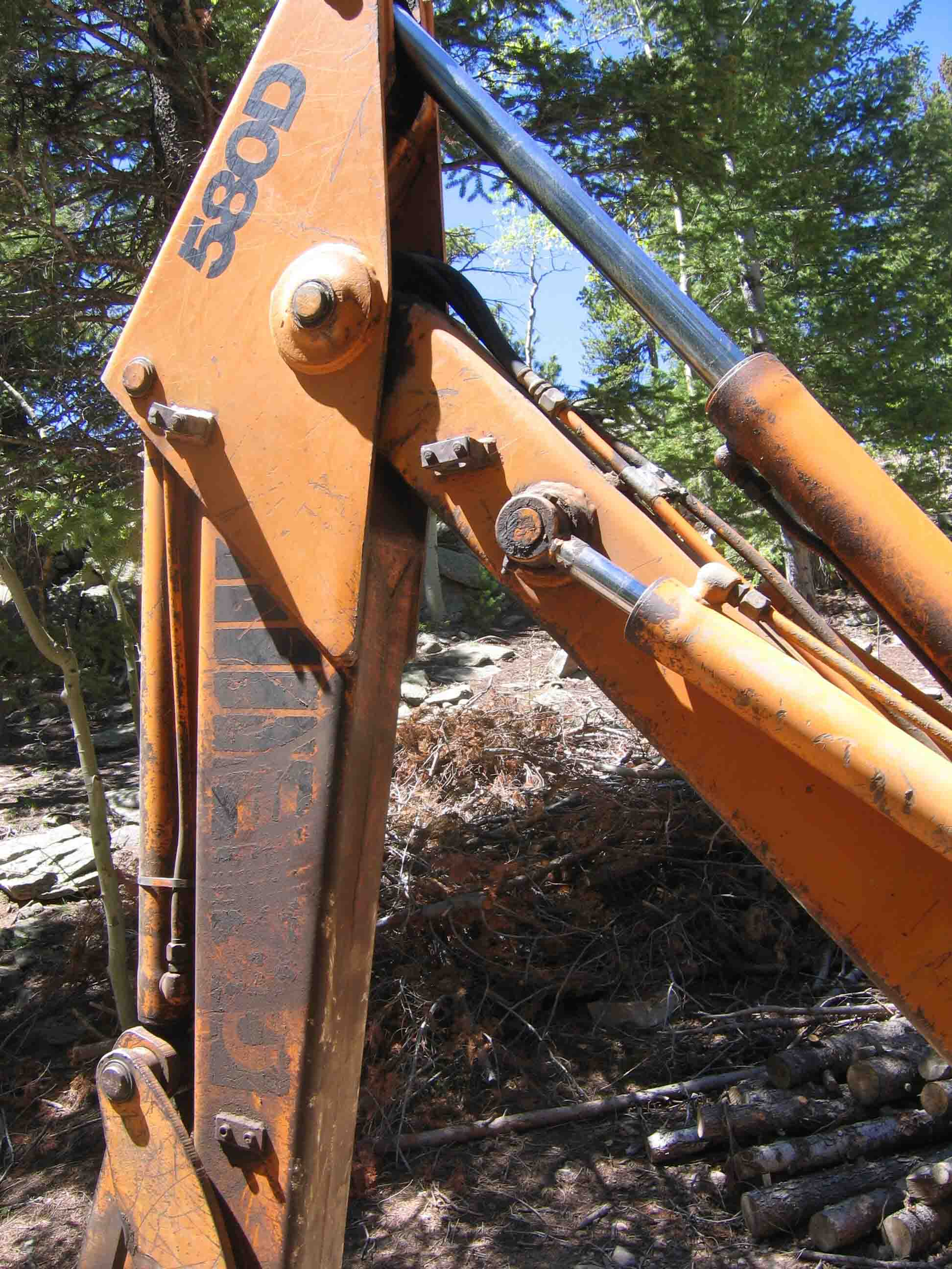

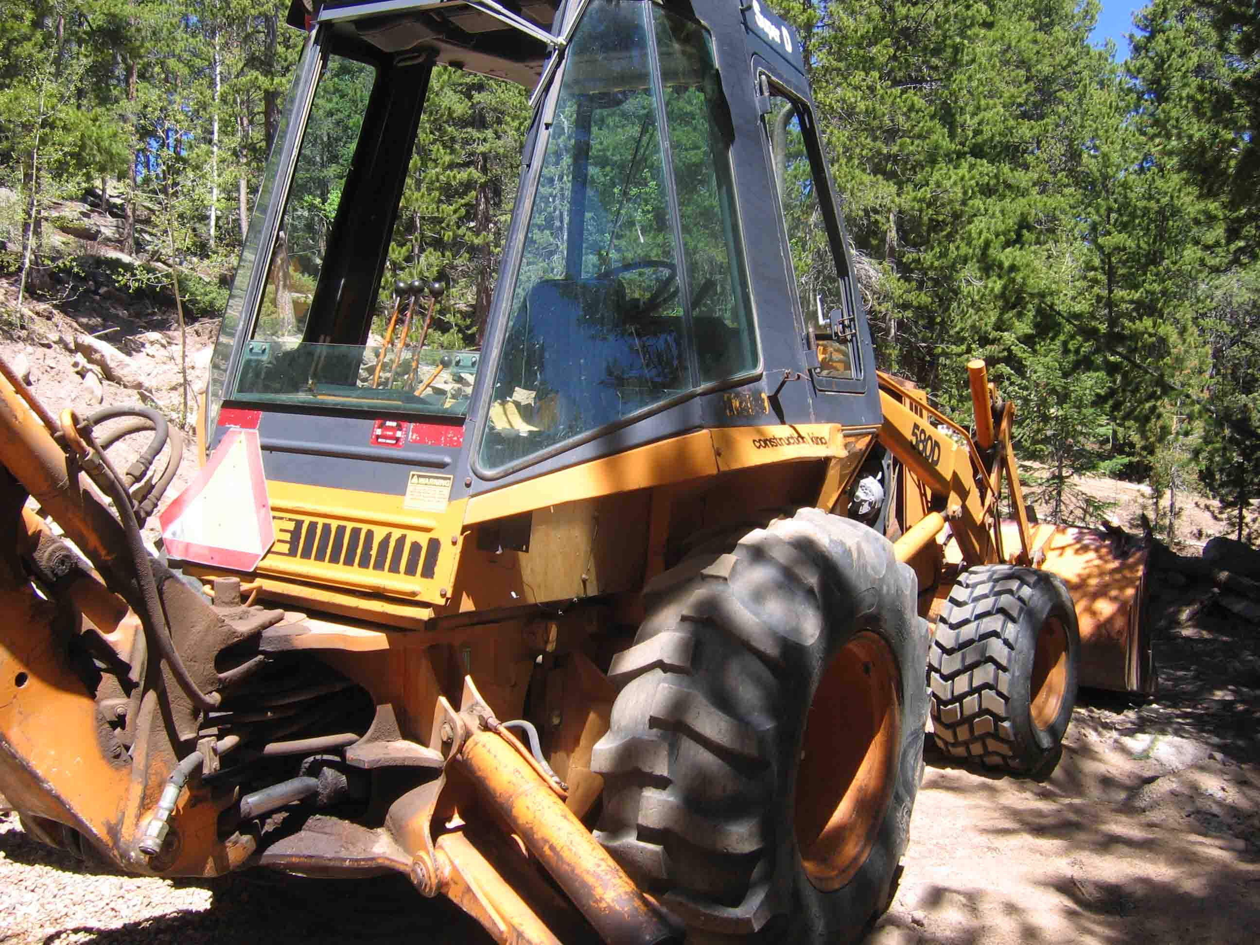

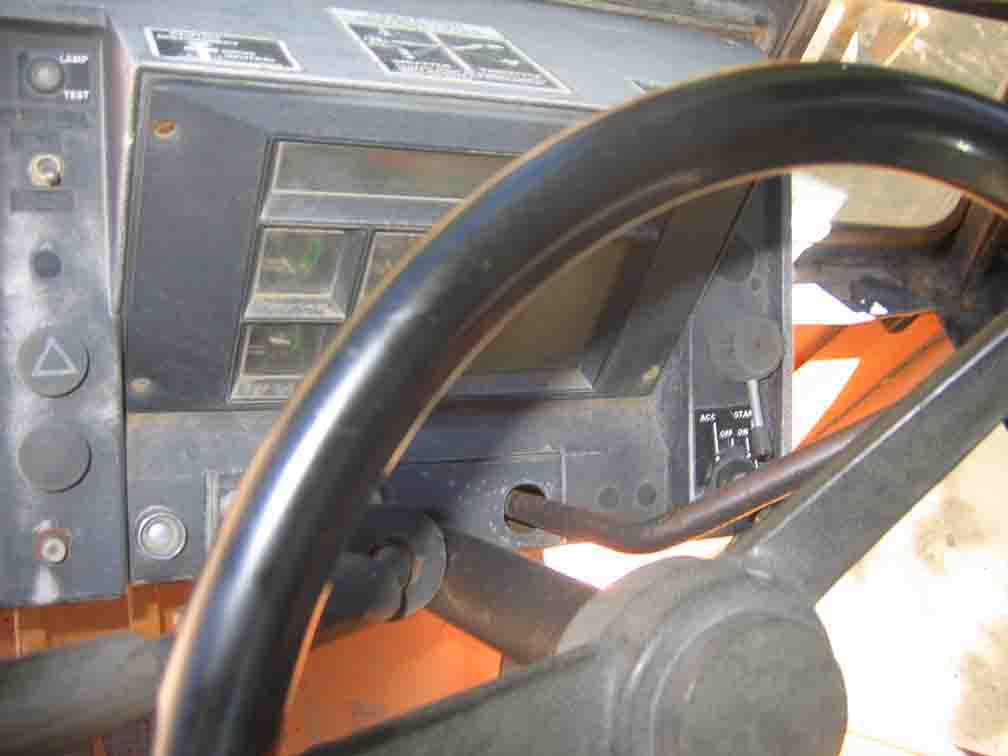

"there's no such thing as a stupid question,only stupid answers" with that said ,,i'm stuck on stupid appearently, i bought a shop manual have been evertwhere on internet ,even talked to ppl, on a 1986 case 580D backhoe i got a line comming out each side the lower backhoe arm where it swivels, with quick releases on them,, what are these lines 4 ,where do they go an is there anyway i can use to operate a hydro. rock hammer ?lines ,just spent the most part of this day with that machine,,the cab is very basic,only the controls in pictures,,. i even played in the dirt with it, i crawed under ,poked it from the rear with a stick n flashlight,i crawed under n followed the lines ,i lost them (2 lines )a top the rear axel ,,either it so common i
m missing it or it just vanished leaving no bolt holes drilled,,,,wires hanging, no handles floping, i been a mechanic for 30+years, an i'm havin the worst blonde moment of my life,,, going to try to enclose pictures,,,,,,,,,,,,thks case loader ooa.jpgIMG_1038 001.jpgbrackets.jpgdash oooa.jpgIMG_1044 004.jpgcase loader ooa.jpg

Those hoses look in bad shape.
They are probably for aux hyd motor driven attachments, or hyd hammers. etc.

My 580B has same controls as yours mostly - in your pic of the boom, I see a few un-used hose clamps on the sides of it - most likely for the missing hoses for what JJ mentioned, or a thumb -
In the pic of the controls, there is one I do NOT have - the side lever that's above the right swing pedal. I'm thinking that's where your QD's are calling home.
Know what you mean about getting lost - if you can, take off the floor plates in the cab. It'll make things a lot easier to see/get at.
Also agree with JJ, those hoses look like they've already died... Steve

Jeez, forgot I'd taken my "travel lock" off years ago, was kind of a PITA and I don't do road travel - duh, 'nuther senior moment.
If you've found no "unspoken for" controls, here's another (desperate) thought - could one of your main controls (like bucket curl) be a joystick? front/back for curl, left/right for thumb, or something similar?
Or, maybe, since the boom hoses and whatever they ran are gone, maybe so is the aux. valve they used to be hooked to. I know, I'm reaching - but please, when you find out the "rest of the story", post back - ya got me curious... Steve

If that hose is a work port hose, remove the QD and place hose in a bucket and operate all the levers to see if one of them supplies fluid to the circuit.
Do you know if you have an aux position anywhere on the BH.
Is there a switch you have to activate for an aux circuit? Like a solenoid to shift a valve to another function?
Plug a hyd gage in the QD and see if and when you have pressure.
What function does the lever on the right side above right pedal.
Could it be a motor valve spool for hyd motors or to operate a thumb.
Some of these are repeat questions because they have not been answered.

The controls in the pic look exactly like mine, just a different looking lock lever. The two short ones are outriggers, right tall one is boom, middle tall one is dipper, left tall one is bucket curl, pedals are left and right swing. My lock looked different, apparently Case figured out the 580B needed at least THAT improvement.
Newer Cases (not sure when) had other options that included joysticks and did away with the pedals.
Yes, the "over center" thing works, IF you have rpm's up enough to have the boom moving fast enough AND you're coordinated enough to PUSH the boom lever at JUST THE RIGHT MOMENT. Newer Cases did away with that method.
Mine also leaks down, takes a couple days and the bucket's on the ground UNLESS I park with the hoe end slightly UPHILL.
Those older ones had the Extend-a-hoe option, but the dipper is more complex - this isn't one of those, nor is mine. Only difference I saw from mine (other than the phantom QD's) are the hose clamps added on the sides of the boom and dipper... Steve

i havent found any switches or levers as of yet, the lever above the right pedal only releases the lock pin 4 the boom ,, i guess i am going to have to follow those 2 lines as best i can an understand where or what connected to.i do n0ot have the extenda boom stick on this machine (that would of been to easy to adapt to)
