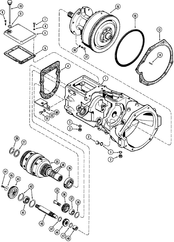

I have a 580B backhoe that spun bearing last yr. We pulled the motor and fixed it and now the motor runs just fine. But, It seems that it developed a pretty good leak right where the motor and the bell housing connect. It is hydro fluid not engine oil.
I am certainly no mechanic but isn't that area dry and therefore it doesn't need a gasket? Why would I have hyro fluid leaking from there.

Power shuttle models show a gasket in between the engine, and torque tube.
Probably best to go to Case Construction, and determine which particular model 580B you have.
CASE
Click on "parts and service", in the menu bar, then "search for parts." Type in your model number, then have a look see, and find what you have.

Did you replace the front shaft seal?
We always count on replacing the front transmission seal any time a engine is split for the transmission.
