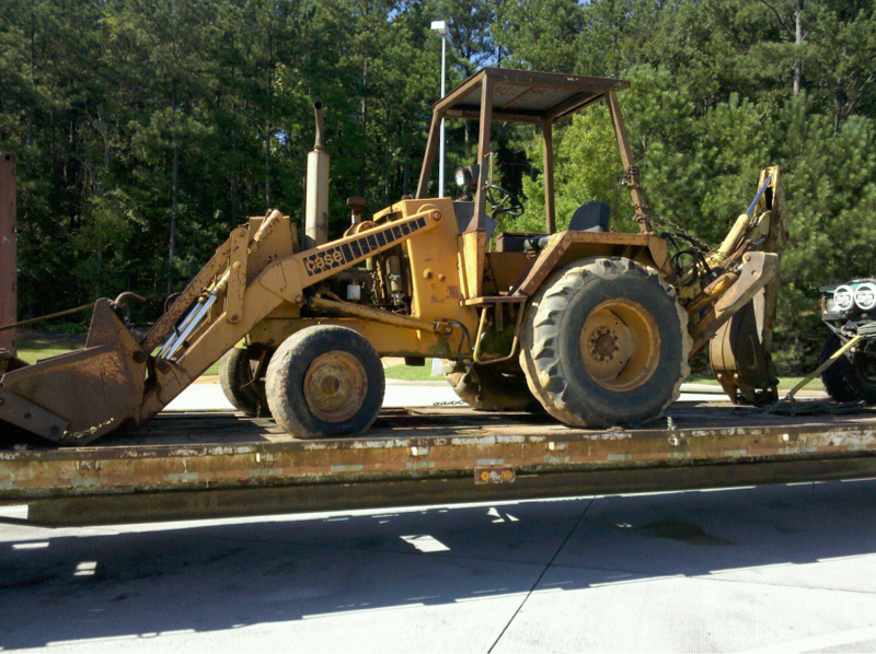

Hey guys!
I'm Steve. I posted up about a year ago that I had bought this acknowledge and finally now, a year later, I found someone to haul it home from Georgia to Arkansas for me. That was tougher then I thought it would be! Lol
Well now that it's home I'm looking it over figuring out what all it needs. It has been parked for almost 2 years so I'm goin through and changing all o the fluids and filters. I haven't been able to locate the ID plate on it. From what I've read it should be on the left side of the frame near the front of the rear tire. I don't see one at all. Im gonna see if I can post pics and was wondering if someone could help me ID it. It's got a dieselmotor and what looks to be the shuttle shift 4 speed Trans. Thanks in advance for your help!

Looks a lot like my 480C. The ID plate is just above the platform where you step into the ROPS cab, on the inside of the front panel where the ROPS attaches on that corner. Maybe 4-6" off the floorboard. Easiest to read from the ground.

Hey thanks for the info guys. Hadn't been on here in a few. Work has been crazy. There's no id plate as far as I can see but I'm 99.9 % sure it's a C.
What do you guys think? The fluids look to be in great condition. Should I still change em? Except for the fluid in the hydraulic pump. It looks like it might have water in it. It's kinda pink. I guess the frame is the tank for the hydro fluid right? The drain plugs are kinna boogered up. That might be a challenge gettin those out. Any advice is welcome. I'll check eBay for a manual too. Thanks again.
