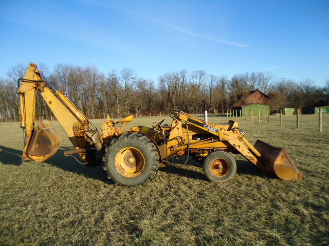

Hello, I am the proud new owner of what I believe is a Case 530 CK.
However, the seller thought it was a 1953, and the 530 CK was '60-67.
Looking at tractordata serial numbers, the one on my dataplate isn't even close, it is a 4063xxx. It certainly looks like a 530 CK from other pictures I've seen. I have attached a picture of it. I don't think it has a "shuttle" though, no lever for it that I see. Could this be an older 530 tractor that a backhoe was attached to?
This is my first equipment, will be using it to build a house, level the ground, digging etc.
I have almost no experience with hydraulics, I hope you guys can help me out, as this thing is old and will need a lot of work I'm sure.
My first problem besides the ID, is the engine will stall when the backhoe tries to actually dig, i.e. put a real load on it. It operates fine just moving the backhoe around. What might be the cause of this? the pump is bad?
The gas engine itself seems to run good and rev up, and drives around OK.
Also have one of the stablizer arms that doesn't lift the tractor, it just kinda hisses when the load is on it and stops moving. The cylinder leaking?
Appreciate any help, quite excited to play with my new big boy toy! :)

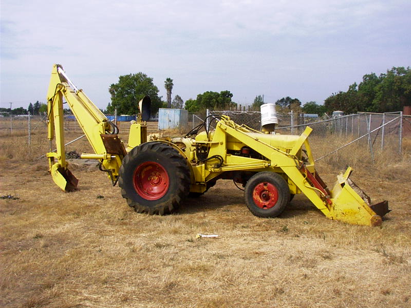

It looks a lot like the 310B I had. If you notice the decals, I too thought I was looking at a 530, until I saw the number on the ID tag.
How many lugs are on the rear wheels..?? Early 310's had 6 lugs, later production had 8. Just looked at Case/IH to confirm, but all 530's ad 8 lug rear wheels.
As far as the engine stalling. when digging, I found I needed to run the engine at at least half throttle. That is a big pump on the front, and if indeed a 310, a lot of pump for a 30 some horse engine. Then again, you may want to check and see if the by-pass valve is working. On mine, it was located in the conglomeration of plumbing, near the loader controls.

It does look the same as your 310B, I think mine has 6-lug rear wheels,
and as it seems I don't have the "shuttle", but just a gear selector, so it would not be a 530CK, although they look pretty much the same.
So I think I must have a 1958 or 1959 310B.
Few 310B compared to the 530CK, so I hope parts are not an issue!
The Hoe tag is there, similiar 40xxxxx serial number as the tractor, the model number is not visible, so can't tell is 31 or 32, just like no model number on the tractor plate.
