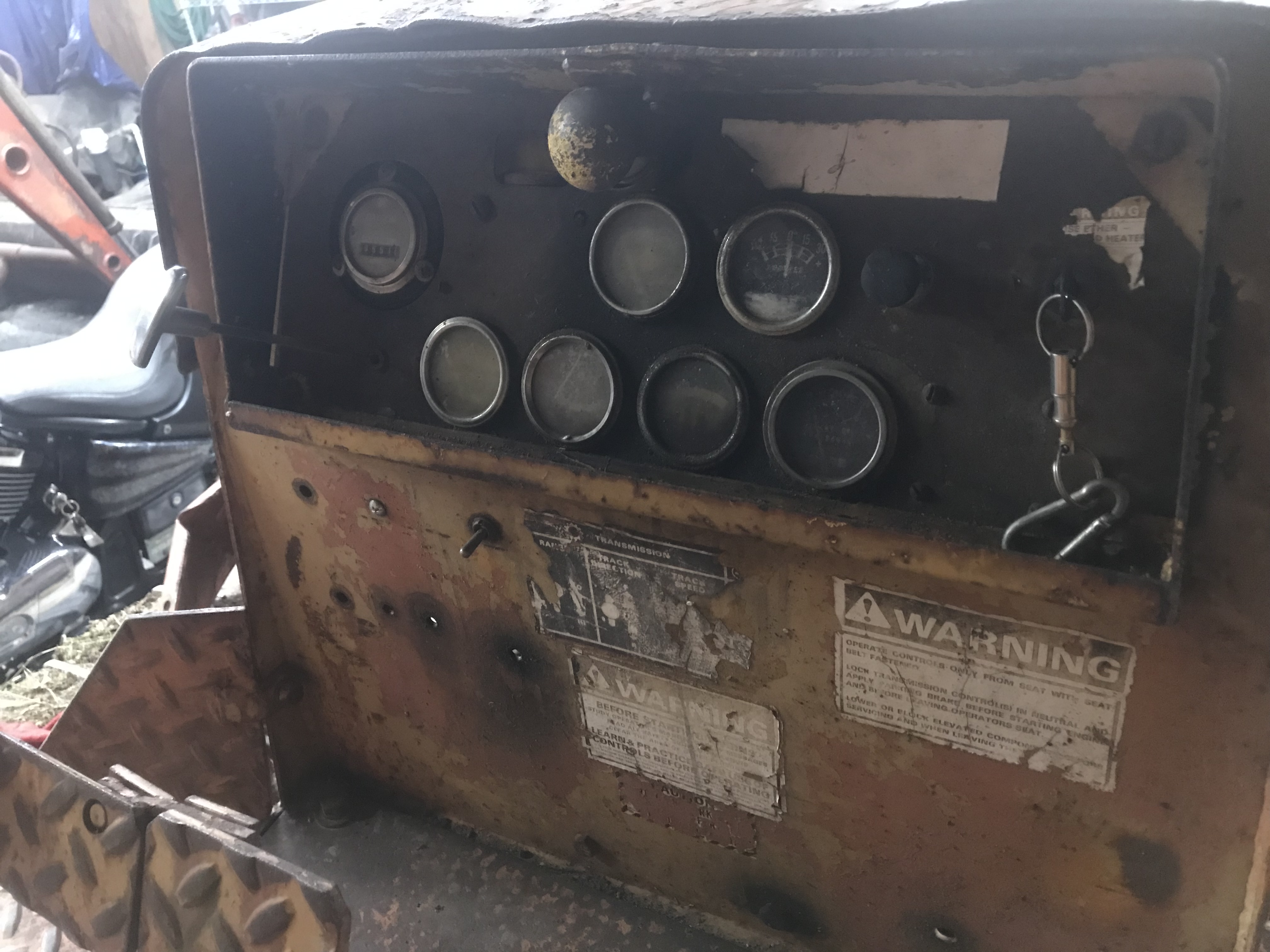

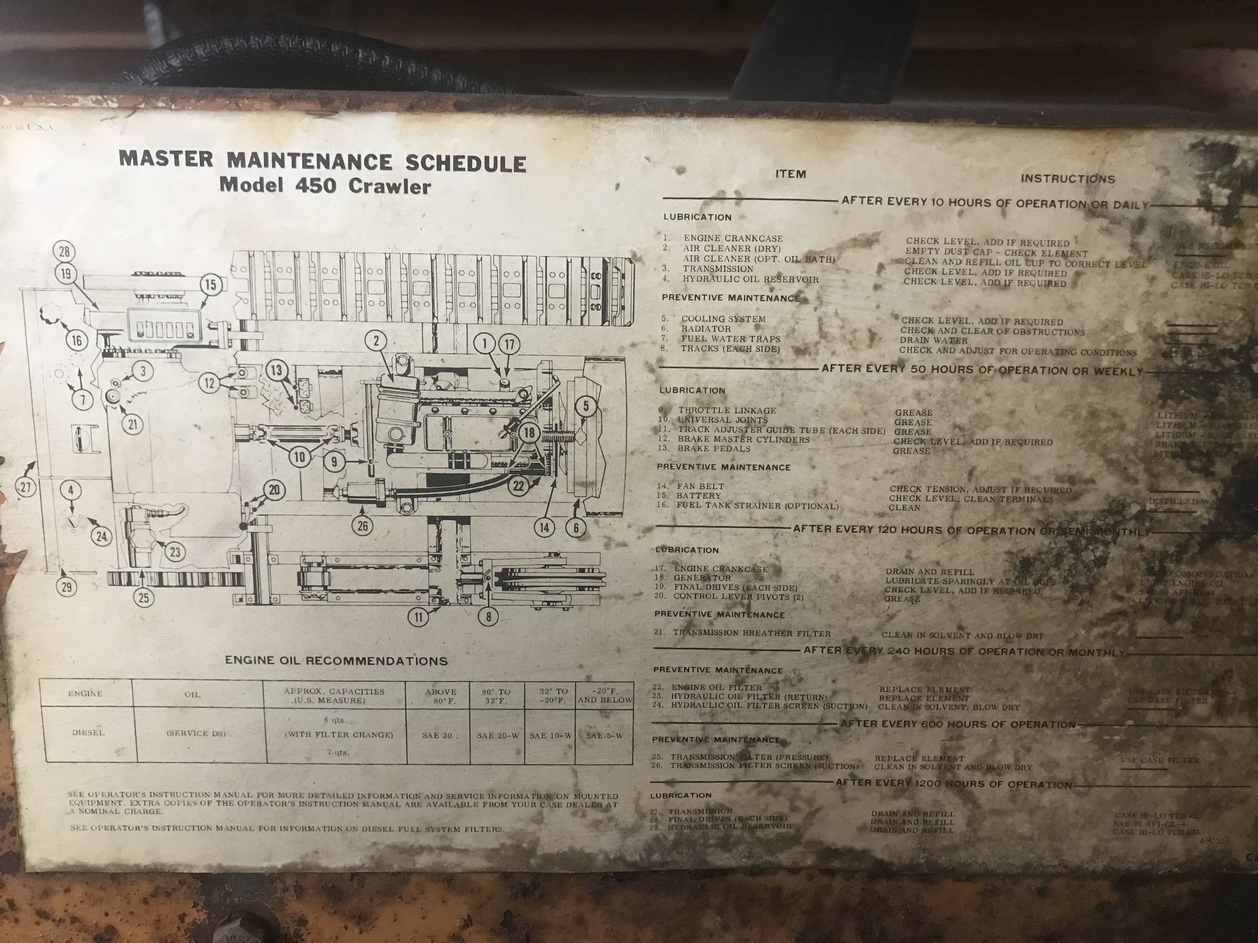

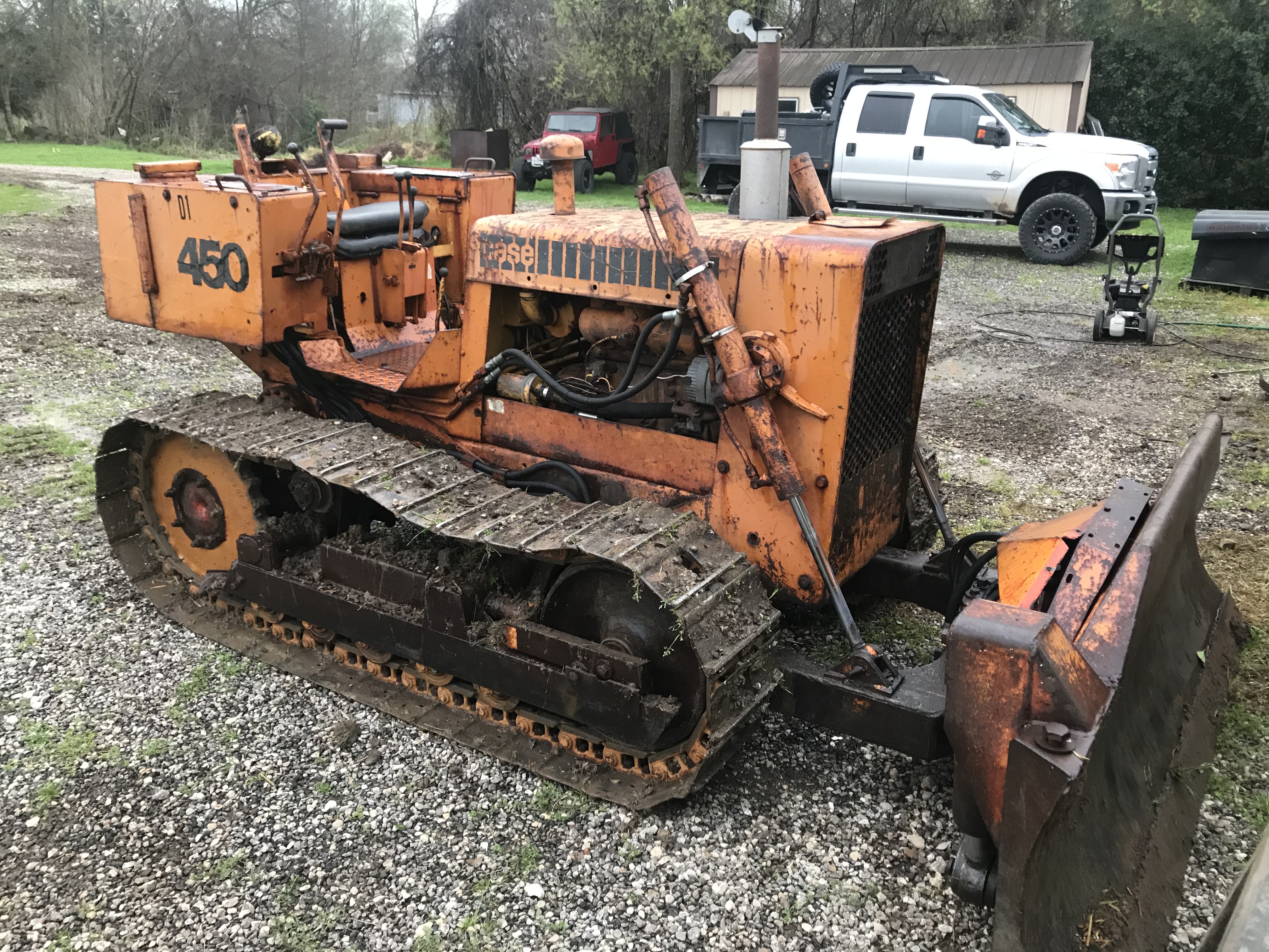

Good morning all,
I致e recently purchased a mid 1970s Case 450 dozer with 4 cylinder diesel, and hydraulic 6-way blade.
It appears to have been painted a couple of different shades of yellow/orange over the years, and the serial number tags are missing come to find out.
This makes it a little more difficult to order parts for. Are there any Case equipment experts in here that might be able to help me ID the serial number range for this dozer by any other means?
Thank you.

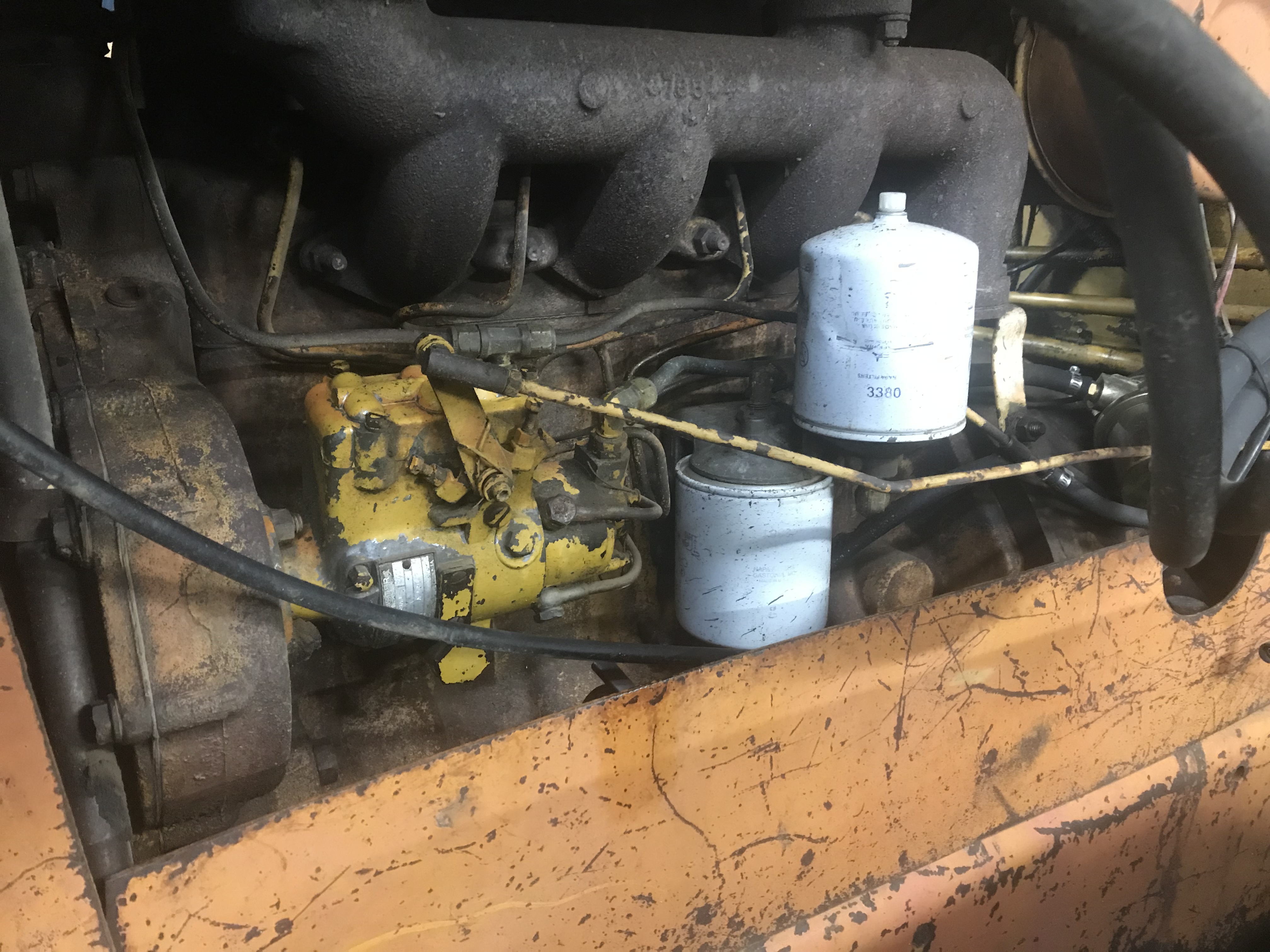

Nothing yet besides I want to change all the filters and fluids on it etc, and buy the right service manuals etc because they are “before Ser no. XXXXX” and “after ser no. XXXX”
   / Case 450 Dozer #4
Filters are easy to get at NAPA, that's what I use.
The manual is good to have, but it sure is expensive.
CIH HYtran is now what's recommended for both the tranny and hydraulics...

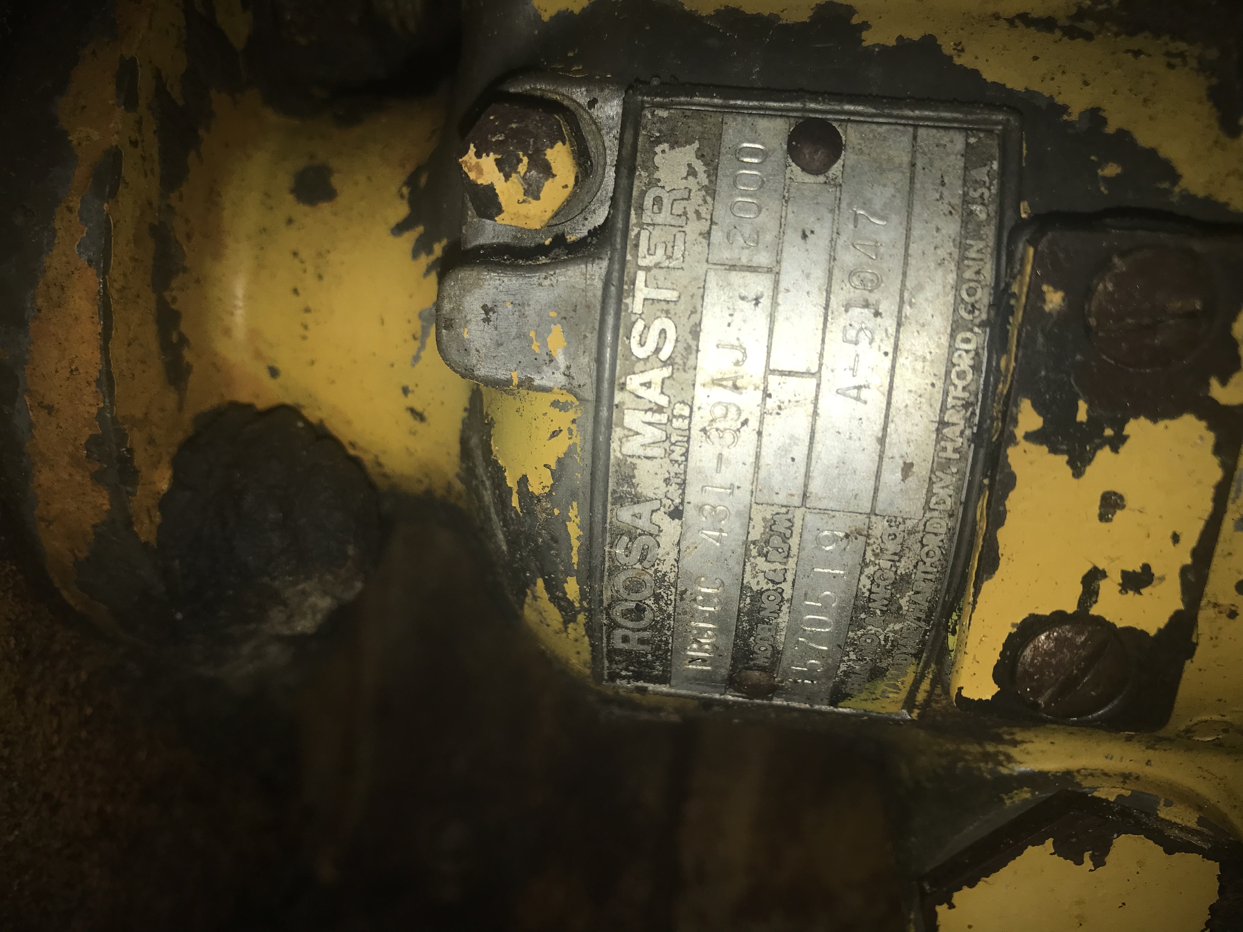

Here is a link to Case Construction.Official Case Construction Equipment Online Parts Store and Parts Look Up. Parts for Case Equipment and Construction Equipment. Parts Store for Case Wheel Loaders, Case Excavators, Case Skid Steers, Case Original Parts. I selected just 450, and it has all of the 450 series listed. Check the early versions near the bottom of the list. Select one, and when the pages open, select "general" in the menu. If you look, it shows where serial numbers are located on the chassis, engine,and transmission. It may at least help you narrow it down the model in a serial number group. It looks like there are 3 different groups of the 450, and some years overlap. Case was great about using apparent part over run, into the next generation, up to a certain serial number. So finding the serial number on the engine & transmission should get you the information you need.
