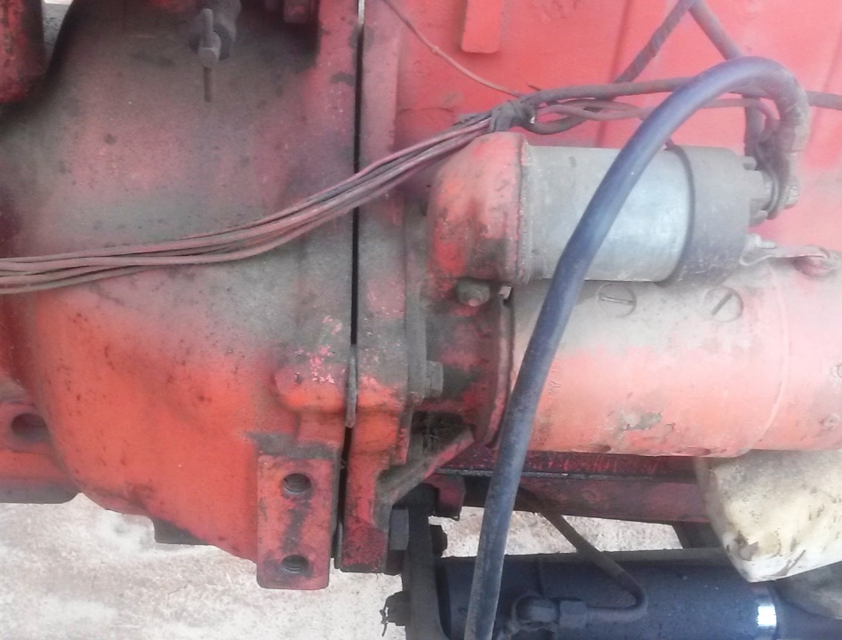

This is unbelievable today was the first time I really took a look at the tractor
Any wonder why the guy said somethings not right?
I've seen some crazy things in my time I've witnessed guys doing some pretty dumb things
Most of the shade tree guys I've known would have known better than to do this.
   / Case 431 clutch issues #8
Ain't that a dandy..!! Gut instinct is telling me maybe whoever did the work, probably didn't align the splines for the hydraulic pump drive tube before taking it on in, to align with the clutch disc splines. If it's like similar model Case tractors, the hydraulic pump is located in the torque tube, and is driven on part of the pressure plate that does not disengage, providing live hydraulics, back through a hollow tube, much like an independant PTO. If that is the case, and the tube is damaged, you can probably find one in a salvage yard.
I'd have to guess the part of the p/p that drives that tube is sprung inward, probably bottomed out on maybe the clutch disc..?? Hopefully, it didn't damage the hyd. pump. Pretty sure that far in, the main shaft should be at least partially in the pilot bushing.
Most definitely want to see some pics, once you get it split..!!
I forgot all about adding an update to the clutch problem on the Case tractor.
When I separated it everything was splined up properly but whoever had installed the clutch had put the disk in backwards and had screwed with the pressure plate adjustment bolts.
I flipped the disk then adjusted the 3 bolts to have the correct fork release height. Put the tractor back together and everything worked as it should. The only thing I was out was a little time
