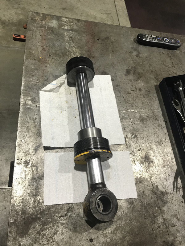

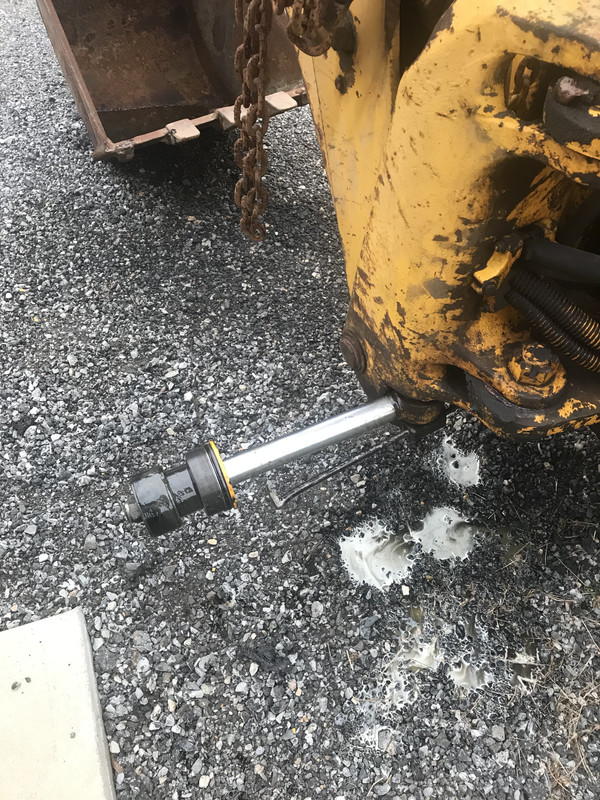

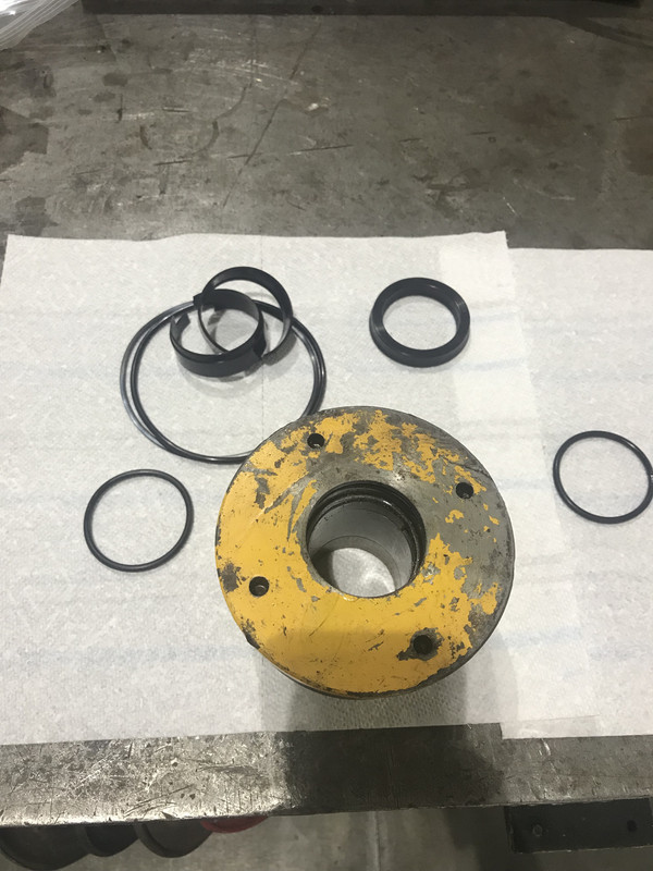

Repacking my first hydraulic ram. Leaking at gland at ram/ram wiper. As an aside, I thought I ordered the right parts however what I got is not what I needed. I got just the o-ring no wiper/seal. Maybe These can be ordered based on gland/rod dimensions/diameter??

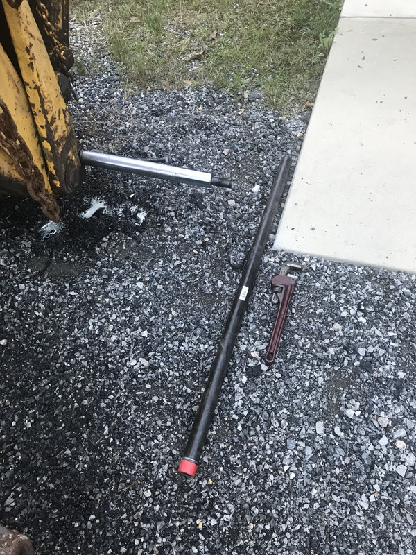

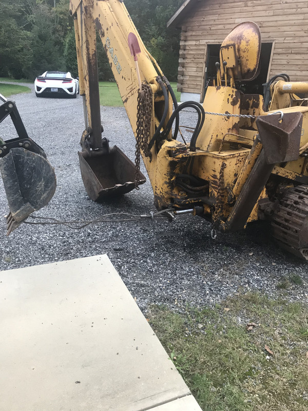

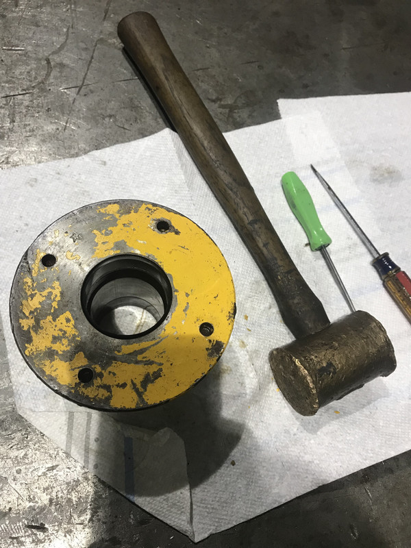

Anyway, extracting w some help. I did remove the lines but it was just a little bit stuck and I couldn稚 quite pull it out by hand. Popped easily
Ram back on to break nut free.
Free

I needed the wiper seal a few weeks ago and took cylinder cap to local hydraulic shop and they matched it up and he even popped it into the groove for me without damaging it.
   / Case 310g hydraulic ram project
Thx
May have to do the same

Rain, had a few minutes so i popped all new seals, rings, wipers into the hydraulic ram. First one, didn’t go bad. Will see how it does under pressure!
   / Case 310g hydraulic ram project #5
With hydraulics, keep everything clean and don't scratch nothin'.
Did you find missing parts locally?
Took the suggestion and went to a local shop. They measured and were able to select what I needed

Today I reinstalled the rebuild case hydraulic cylinder ( works great but now I found one on the bucket to do!) and investigated some excess rear sway in the dodge. Found one raised bracket that ties the rear-end to a link broken. Thought about welding but wrote to BDS for a replacement

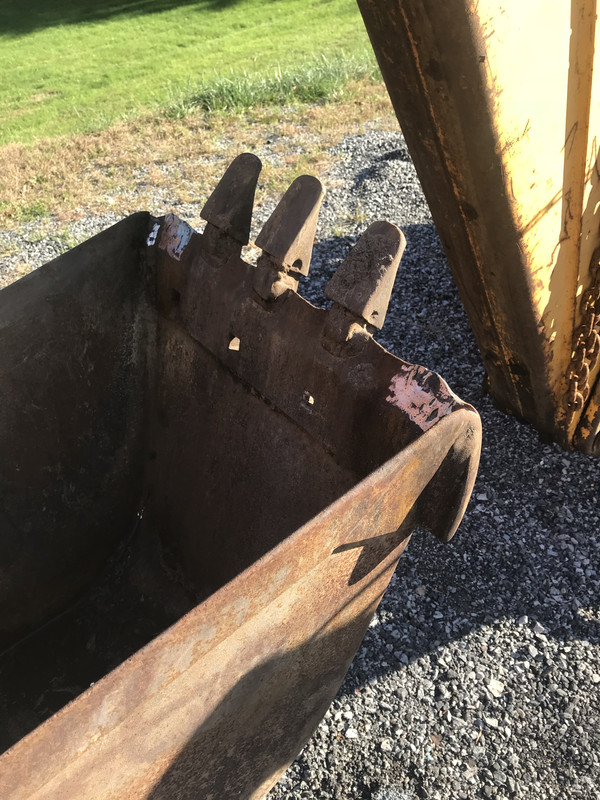

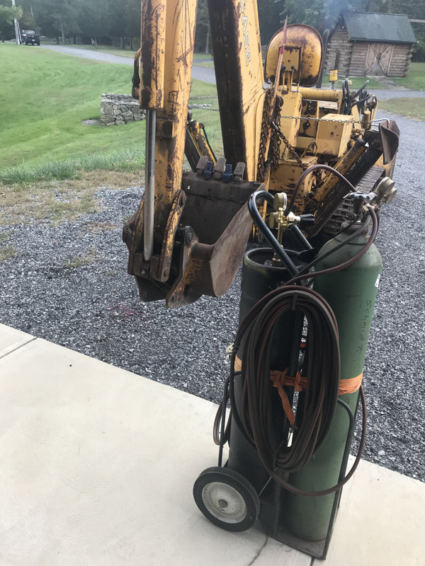

Started some dentistry on the backhoe
Also clearing some stuff for the sawmill

Put some tiger teeth on my bucket a couple of years ago. Huge difference in digging stumps.
I’m trying to match the 3 that are still present. Standard chisel tooth. The front of the drott has some worn bolted teeth. They are solid and I may shape them as a shank and add teeth/pin
