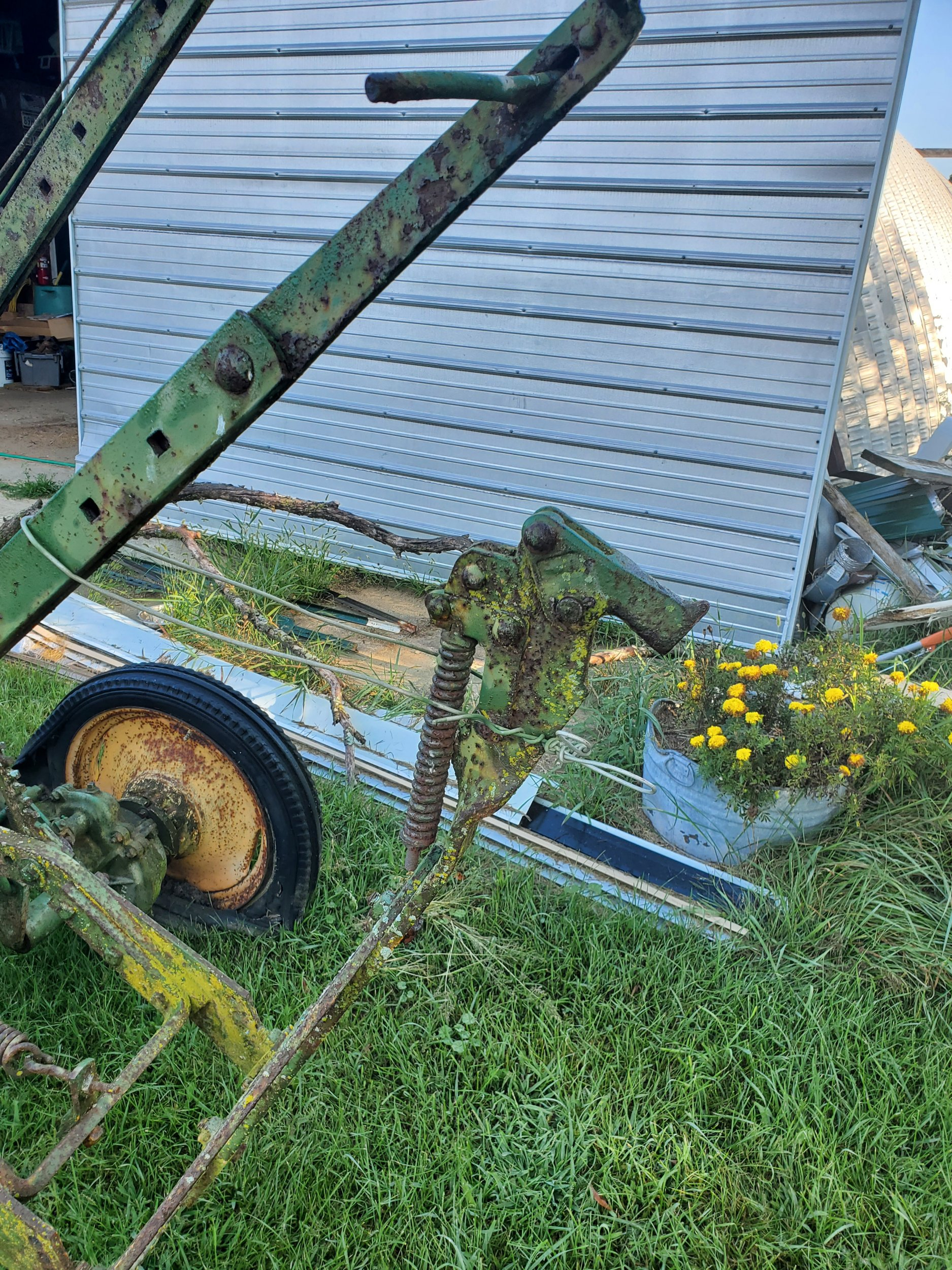

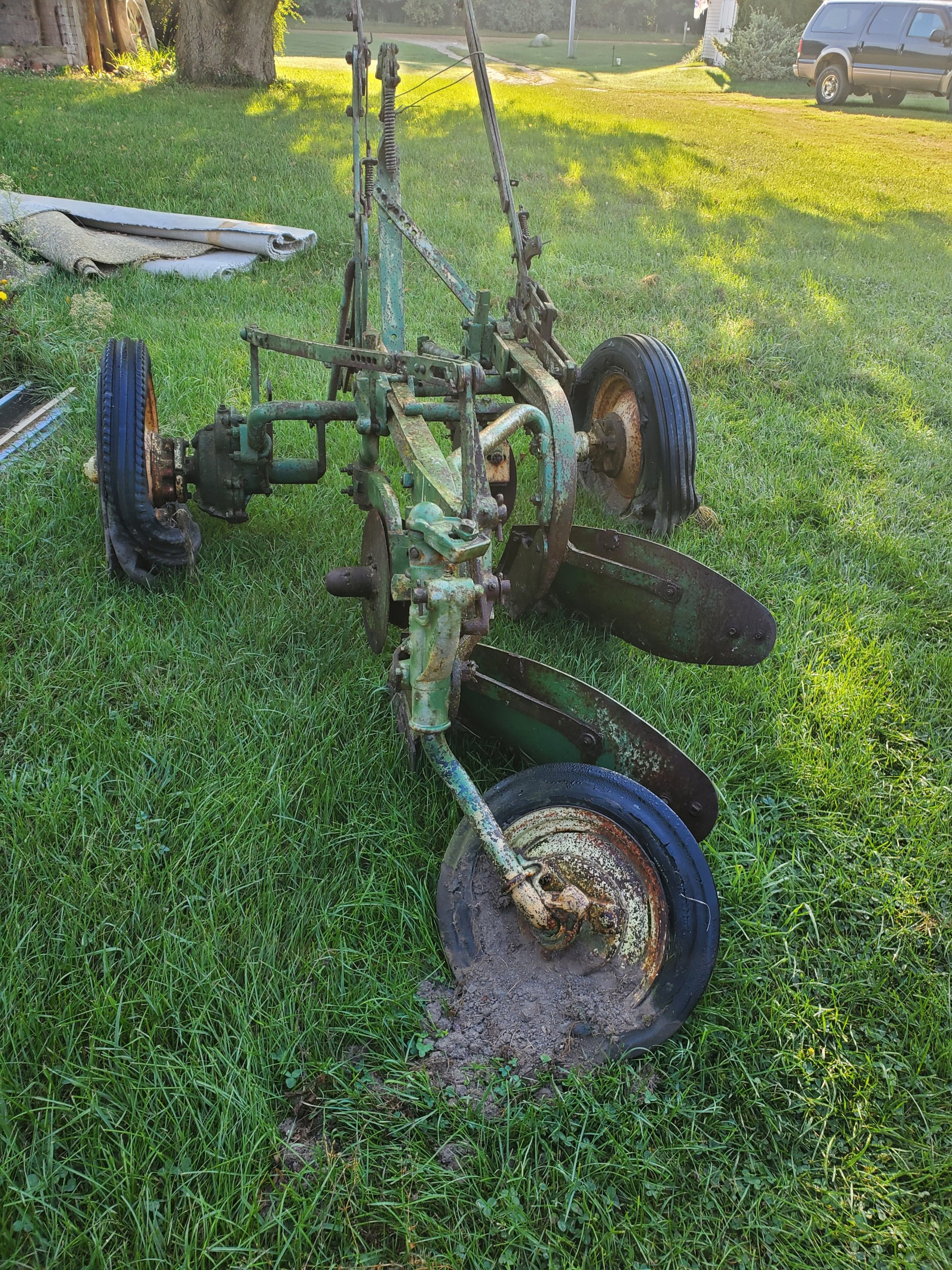

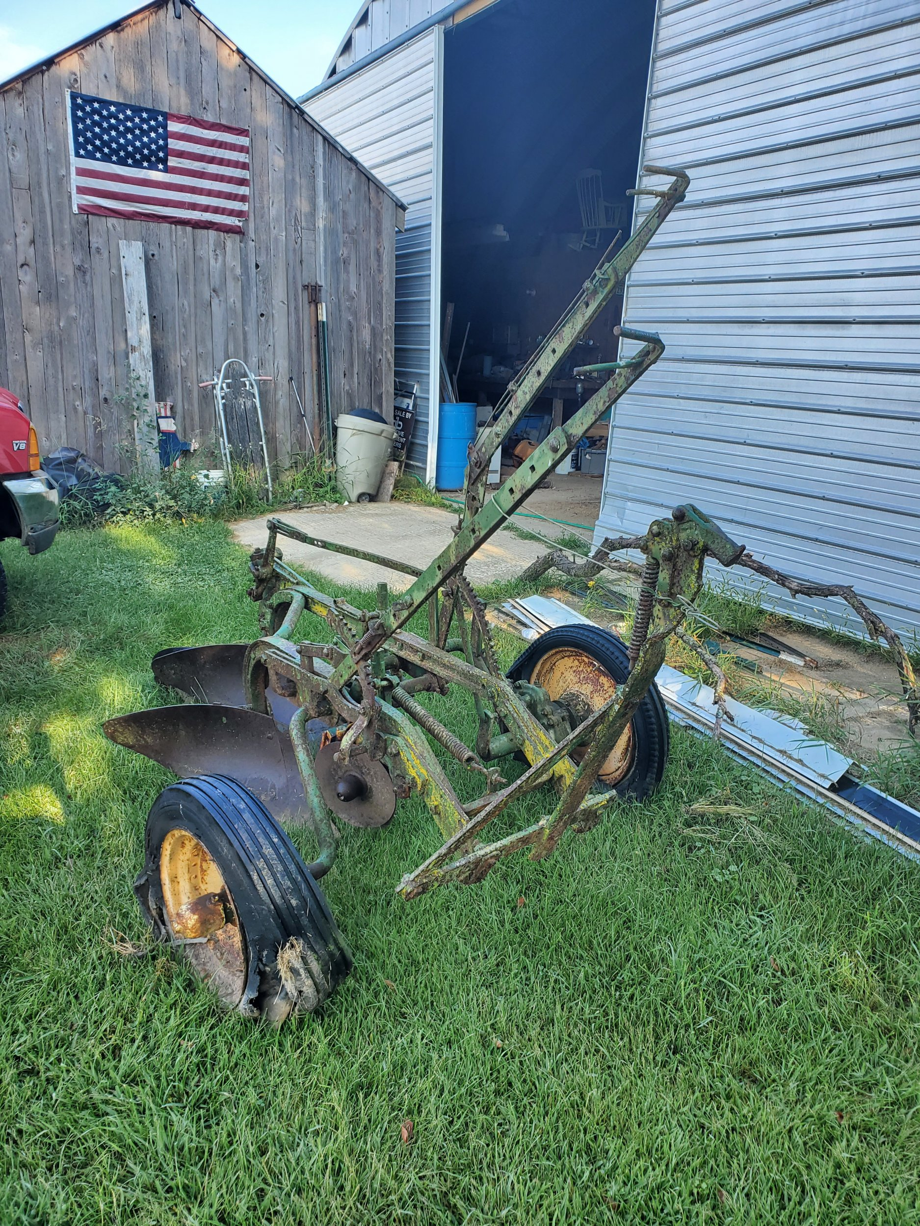

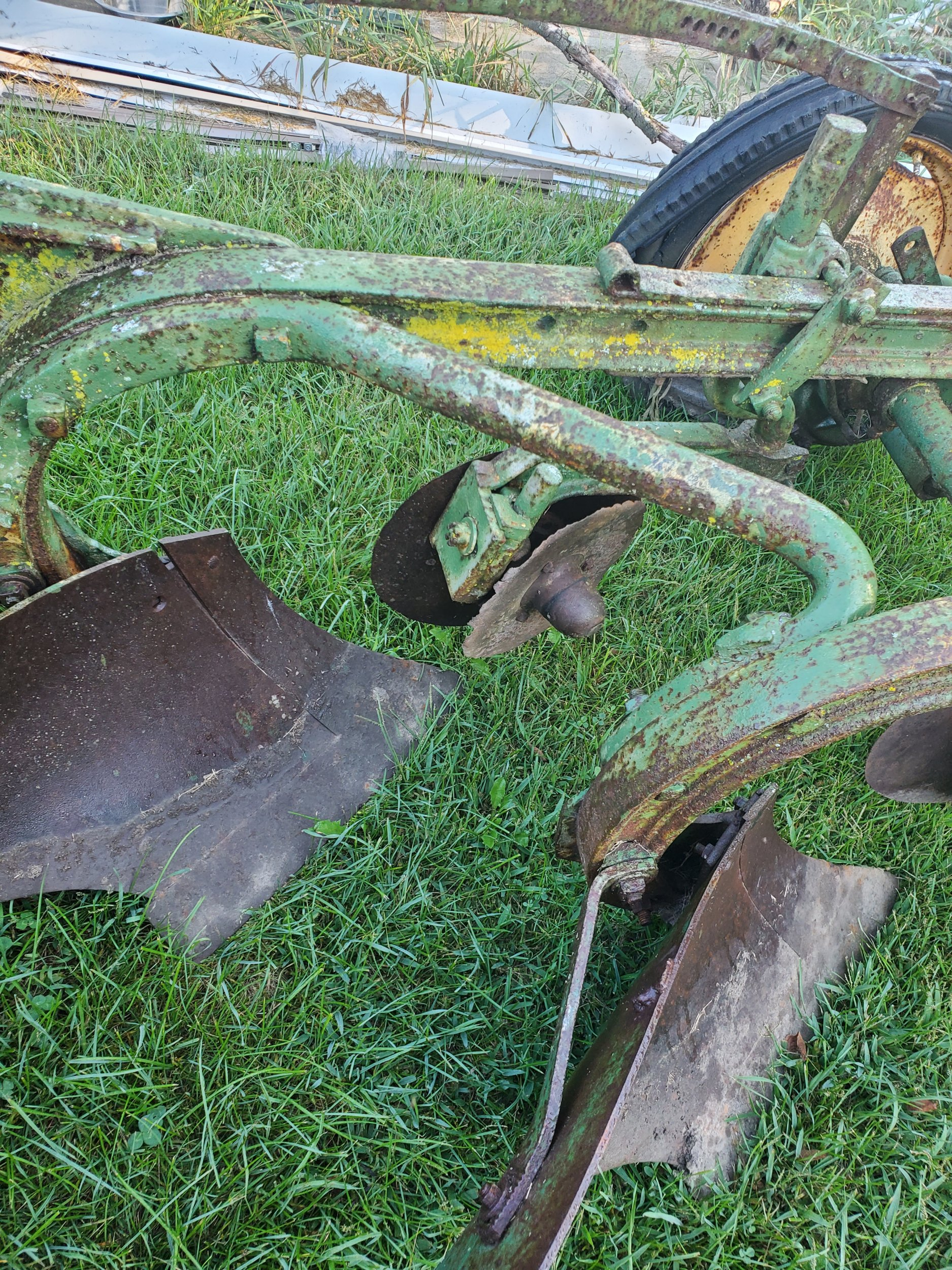

I just recently purchased a 2 bottom trip type plow at an auction found out it is a case. I would like to know what type of hookup is on the drawbar and what type of connection it takes to hook up to a tractor. Also where can I find coulters for that plow. Here are a few photos of my plow. I would like to know what kind of hitch it takes for this and where I can get parts like the rear tire, coulters, etc. Thank you!

You should post some good pic's of it for better assistance IMO . Also i have bought coulters from DN Equipment - DN Equipment for some older plows . Once again welcome !!!

I owned a set of Case MTA EX-14's at one time. 3-14's. That particular plow was made for Case tractors with Eagle Hitch. Because the Eagle Hitch did not swing from side to side only straight up and down the plows "pivoted" off a center pin. They about half way work on a 3 point hitch tractor if you blocked the pivot pin to hold them steady. The coulters on those plows were concave not flat. More like a disk blade. In my humble opinion ONLY and as a long time Case equipment collector and restorer sell the Case plows and but a set of Ford 101 plows if you plan to use them much. IMHO Case made two pieces of equipment that would work right, plows and a sickle bar mower.
