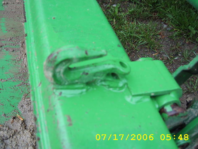

If your hooks were welded properly, don't be shy about using them--I had mine done by a friend who I used to work as a sternman for... :D
I've watched him work, and he puts it on generously & well--chipped slag away at least four times on each to be sure to get good solid penetration...
I trusted the welds he made that held a ton over my head on & off all day, so I trust the welds that hold my implements against/in front of the loader.
Two of these held a bouncing MX-5, and 800# of swinging logging winch... as mentioned, if yours were done by a pro your loader will fail first! ;)
