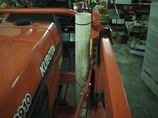

Here's what I did. I can carry a shovel, or rake, or lopping shears, or whatever will fit inside a 4" piece of PVC. I attached the pipe to the upright of the FEL with zip ties, and the bottom of the pipe rests on the frame of the FEL. Works fine and doesn't interfere with the movement of the FEL.

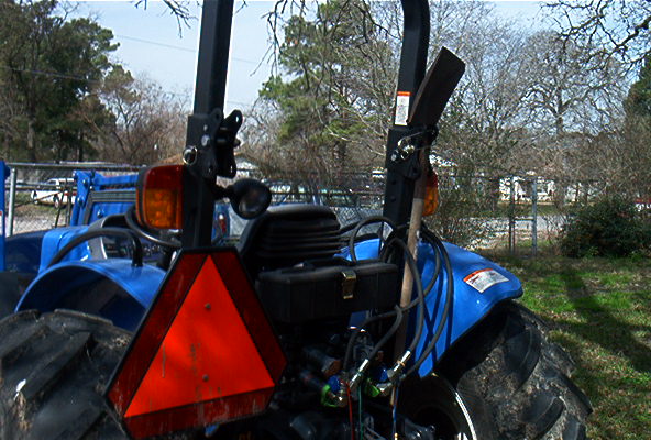

I hook my shovel on the ears protruding from the hinge on the ROPS and use the hairpin clip that came on the hitch pin to secure it. This is on a TN 65.

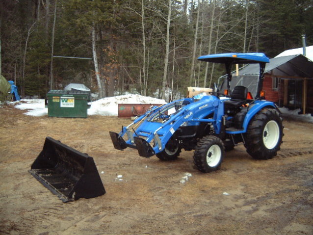

Most all loader frames that I have seen, have a hollow cross tube, in front of the grill area but behind the bucket either round or square. Most of the time I just slide the handle of the shovel in the tube. It has never fallen out even while digging into and loading gravel. It's always right near the bucket for easy access. The hollow cross tube on my TC35D happens to be square and is the lower cross member of the quick tach frame. Pic attached. It is the only black tube / cross member you can see.
Other times I just stand it up in my weight box.
