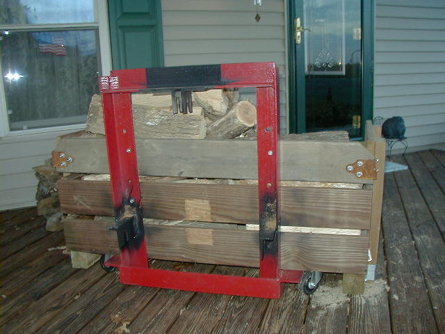

   / carryall #2
now THAT is a great idea for moving fireplace wood!
i really like the casters :) i will have to whip me up one of these. [i currently just dump the logs into the loader, then i have to restack everything...]
   / carryall #3

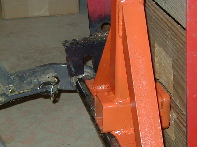

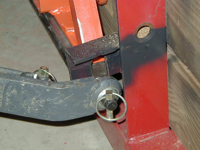

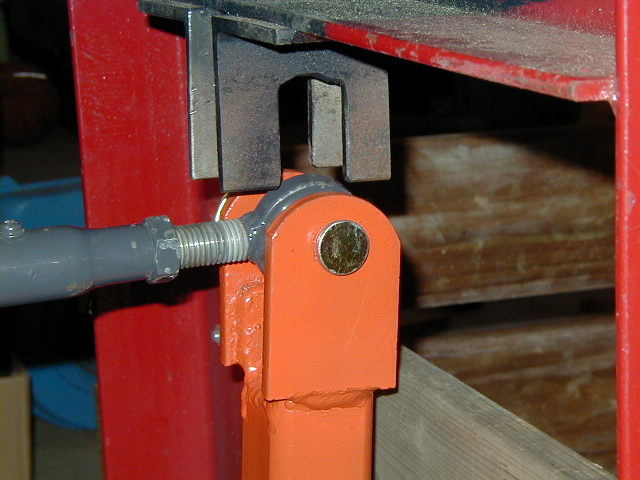

I use a carrier similar to yours, for the 3pt, but do not find the need for casters (thanks for the idea!). However, yours appears to have a quick tach system (I see the slots in the top connector but can't see what is welded on the upright posts near the bottom) which would indicate you let loose of it and might roll this 'box' around on the deck, or elsewhere. Could you tell us more? Will it roll with a load of wood?
   / carryall
have some more pics of the (box) that are close up, maybe will be clearer and it rolls fine with a load on the deck, i can back up to the deck and lower it and just drive away then roll it wherever i want.
