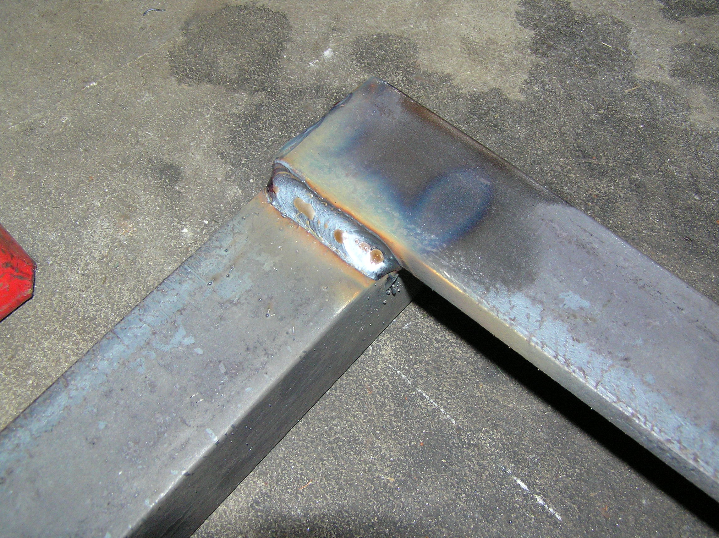

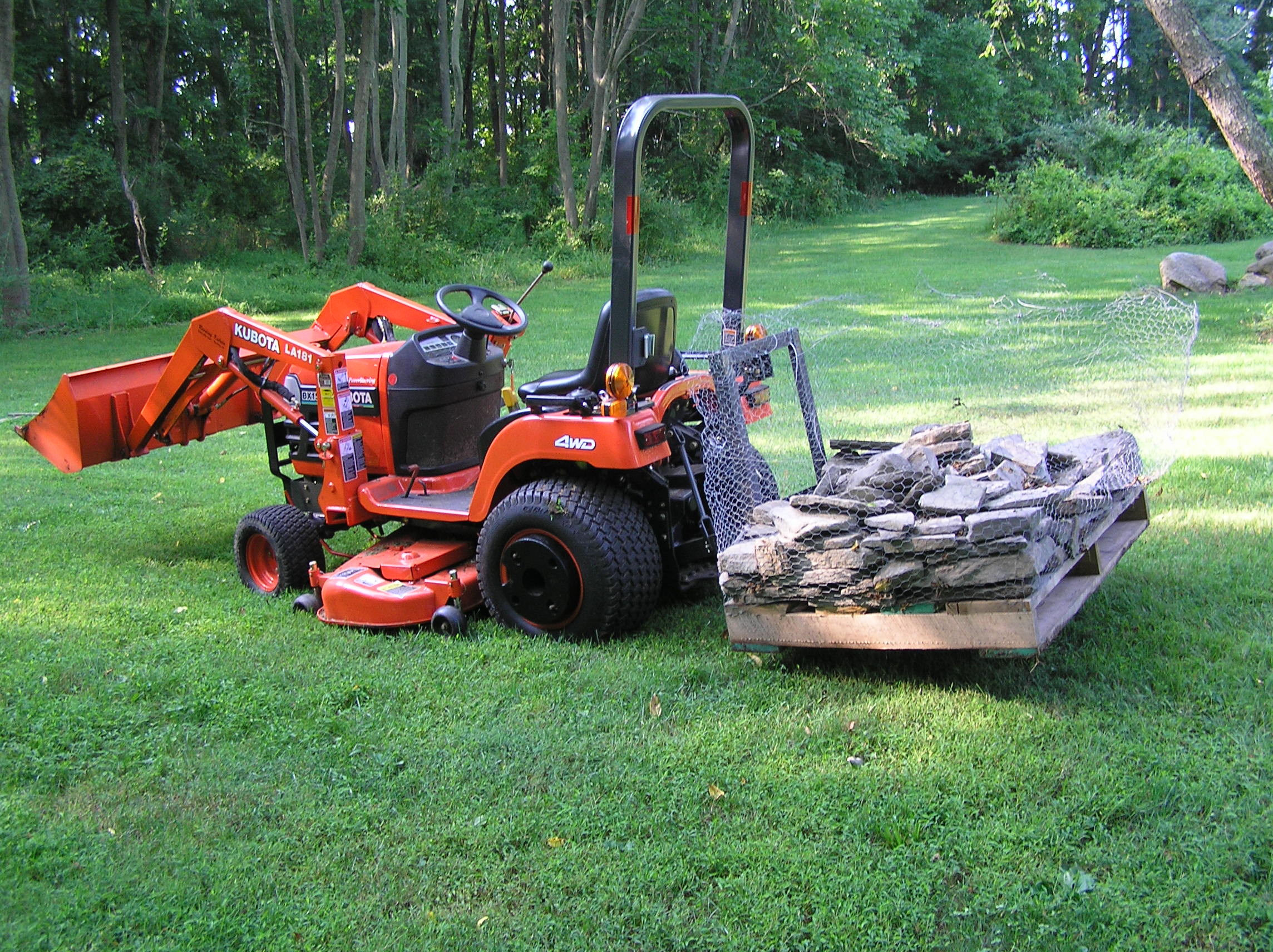

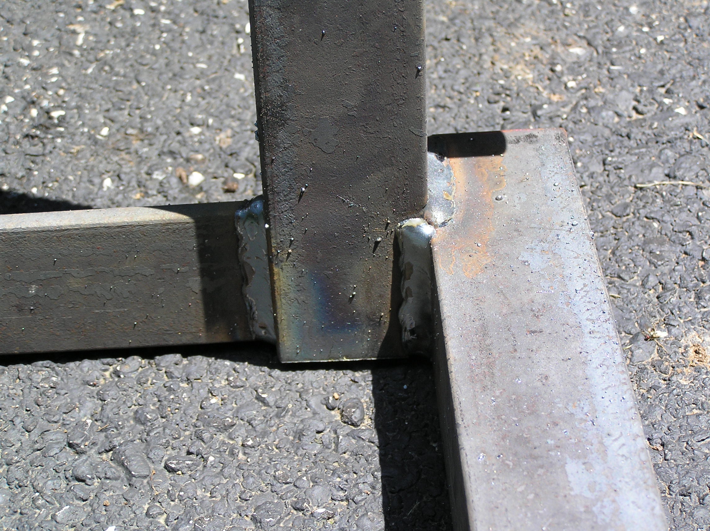

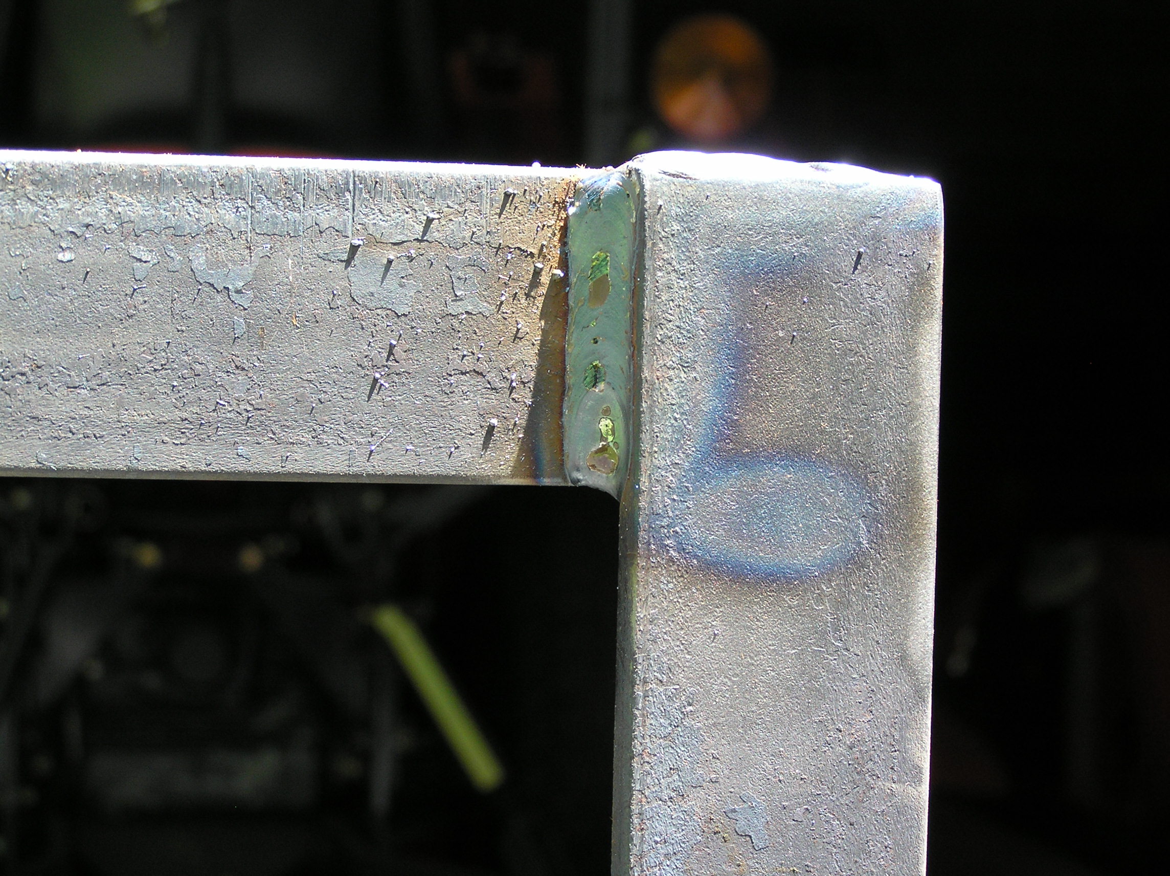

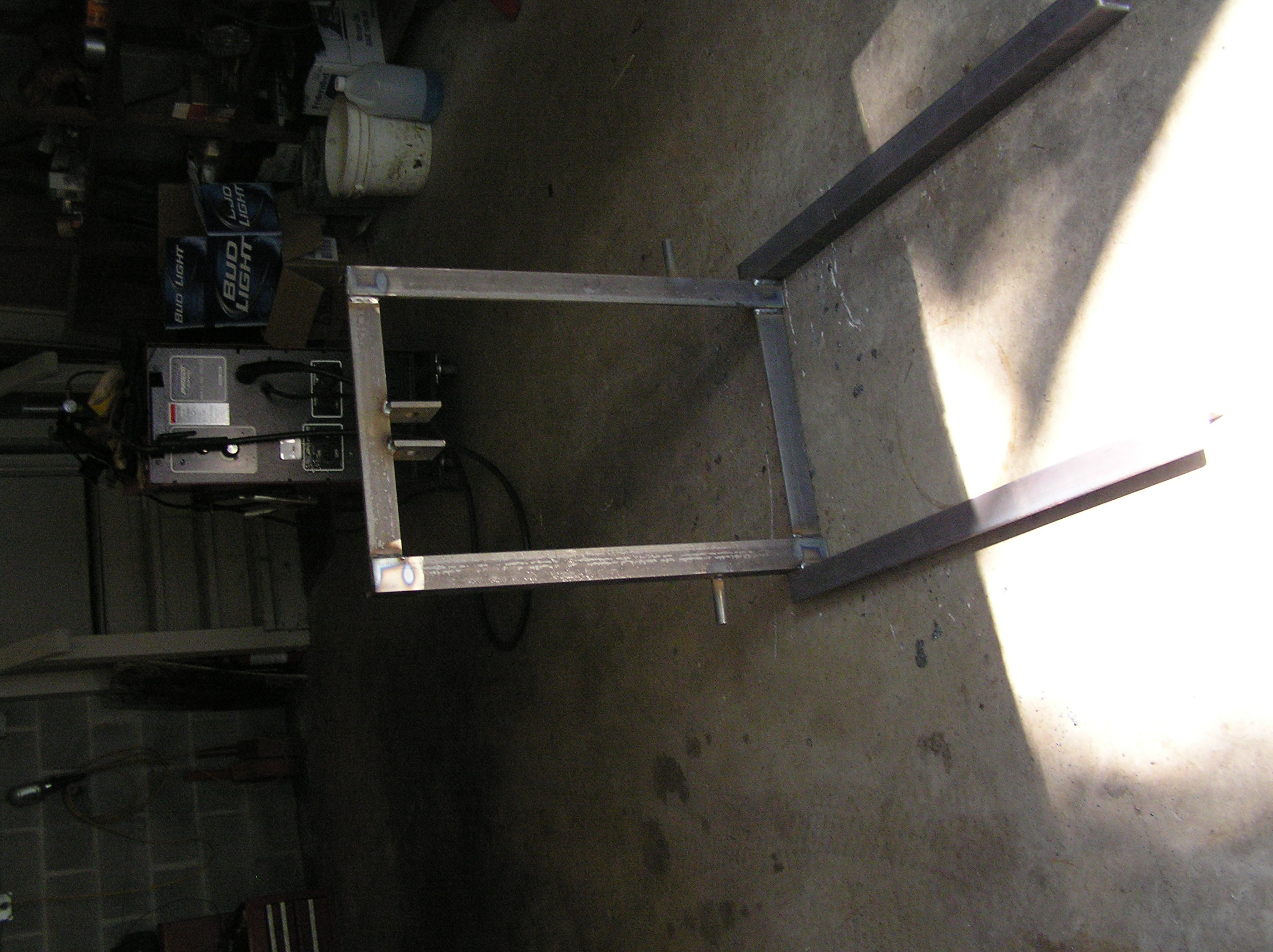

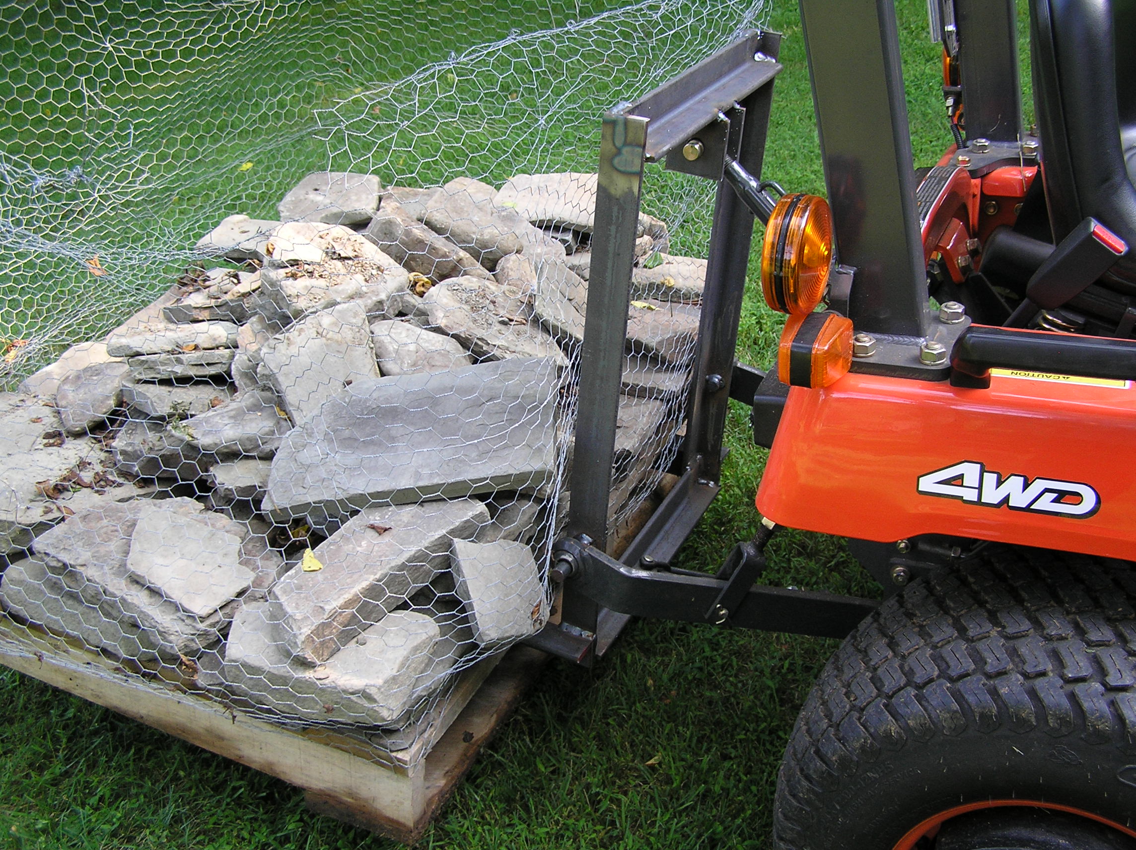

I finally got some time to put a 3 pt carryall together. I needed to move some pallets around that were in my way. I got some 2x2x3/8" angle cut to lenths for me. I basically copied my unit from a website picture. I paid 60 bucks for the metal and the cuts. So I just had to lay it out together and weld it up. I had some round bar laying around so I cut some 4 inch pieces, blew holes through the side pieces and inserted the bars thru and welded both inside and out. I tried it out before I painted it, and it worked like a charm. I couldn't pick the pallet of stone up at first, I had to take rocks out of it and fill my bucket up. Then it came up ok and I moved it out of the way. I figure the carryall can take all that I can lift and then some since it didn't bend or break. I plan on using it to move pallets of firewood into position during burning season. A big pallet like box is coming next for using like a wagon.

Nice job. Don't you just love that warm fuzzy feeling when you get to build something in stead of buying it?
