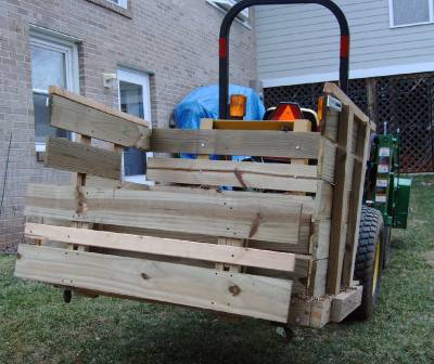

Has anyone built a carryall for a 2305 or 2210? With an I-match?
Since most of my implements have an L (low profile) I'm not sure what will work very well.
I'm envisioning something that I could store in my shed that all my yard tools, saw, fuel, etc. could be stored in/on. And it could roll around on a dolly and then hook up to I-match to haul around the property and off load to work. Using the FEL to cart stuff around takes a lot of time and I always forget something.
The trouble is that I can envision lots of things but I am fabrication challenged.

You can always get a set of plans from How-To-Plans and modify them to work with an I-match. I have used these plans to build 2 carry-alls and used them as a basis for a much heavier duty version.

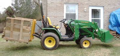

I just bolted a pallet onto the bottom part of the carryall, using the predrilled holes. Then I bolted some 1bys to the vertical part of the carryall, again using those predrilled holes.
For sides, I bolted some 2bys around the edges using lag bolts and then bolted some other 2bys to those to form some holes to insert vertical 2bs into for the sides and back. Put hinges into the back part about half way up.
Here're a couple pics attached. My 4010 is the same weight as a 2210/2305 and same overall height, just has more clearance between the wheel housing and ground.
I put castors underneath to enable me to roll it around.
Don't think the KK carryalls are iMatch compatible. I've read herein where some have modified them. With the castors, it makes it really easy to attach and detach it.
