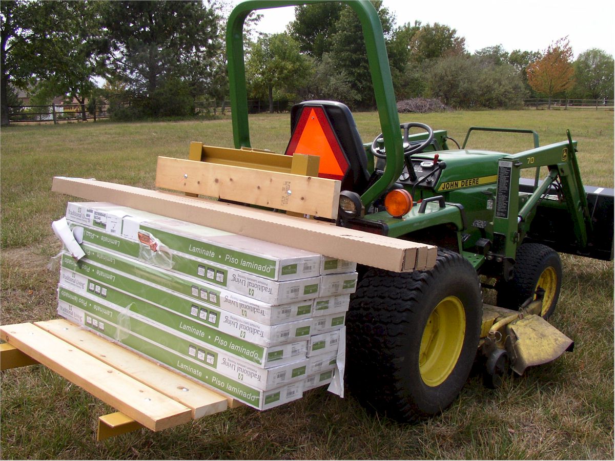

Mulch mover rear shot.jpgMulch mover side shot.jpgYou can get them for about $80 at TSC (old price; don't know current). The carryall is one my counterbalances, especially if filled with about 1/3 to 1/2 full of mulch. I added a pallet to bottom and some sides. Back has a folding section.

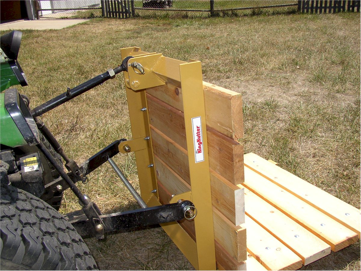

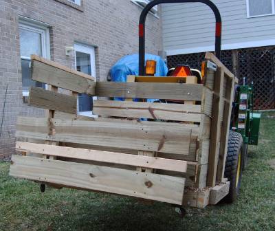

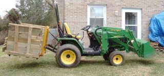

Carry all. Next to a front loader one of the most versatile attachments. Last year I put one together. King Kutter frame purchased at Orscheln. Good welds and quick hitch compatible. I had spare two by six lumber so just needed bolts and nuts. Width is 40 inches because the ten foot length lumber cut in thirds is 40 inches. Board spacing is good for attaching various equipment.
