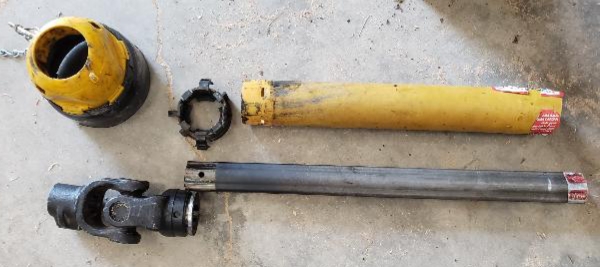

I lost the top link pin while out mowing. I lifted the mower and it rocked back allowing the PTO shaft to hit the front edge of the deck. I compounded the error by then backing up forcing the shaft harder into the mower deck.

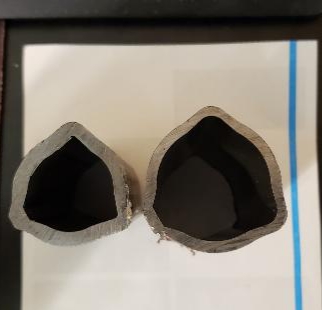

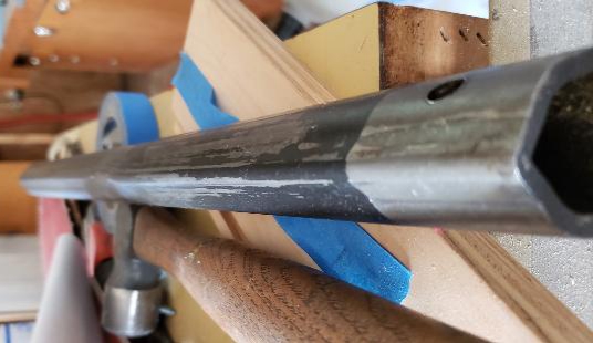

The plastic PTO shield tubes are completely toast. Likewise the shafts. The outer shaft appears fine, the inner shaft has about 15 degrees of twist about half way down.
The good news: Apparently no other damage.
The shafts are pinned to the u-joints, so it should be easy enough to replace those once I know what to buy. The plastic guard parts, I reckon I need some education on what to do there. Seems to be a few different styles. These are made by ANA Cardan best I can tell.
Initial questions: The shafting is triangle shafting. Is there just a couple of standard sizes? Being of Italian manufacture, might there be metric and imperial shaft sizes?
Can I use a different manufacturers plastic shield system?

It's AMA Cardan. A Italian manufacturer that distributes to all over the world.
Yes you can just replace the tubing and the plastic covers. The tube dimension is a standard deal. It's not something that you choose between metric or imperial. I can't help you with sources in the US, but I'm sure someone will help you with that.

Most likely the Agri Supply complete shaft will be the most affordable choice as long as it is strong enough. If you can measure the distance from the outside of the cap to the opposite cap and the diameters of the cap I can look up what the HP rating of your shaft is. You have a Bondioli & Pavesi style of shaft. You would have to look close to see who made it so you can find a guard. Guards are not interchangable between brands.
