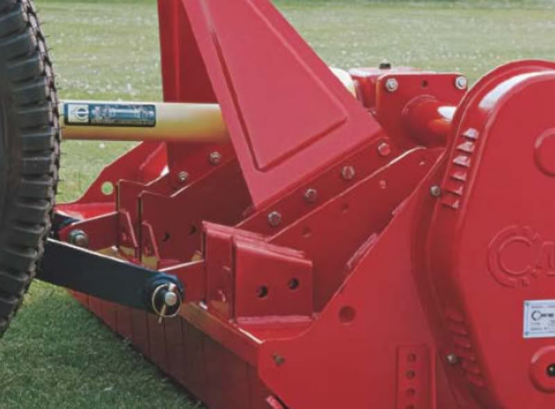

If you click the thumbnail you can see that there are two positions to mount the top tower on the Larger Caroni flail mowers. The bottom mounts swap by just pulling a pin and moving it over. There is about an 8" to 10" difference in the two. I have the TM1900. If it is set up to mount in the left position the left side of the mower is in line with the outside of the left tire of the tractor. I need to use the right side mounts which position the mower about 20 to 22" beyond the right tire.
However, I have a problem with a bridge. In this position I can just get through. Not enough space to make you feel good about crossing so I ordered the shift kit.
If you don't have a clearance problem and can get it into your garage (another problem, 9' wide doors, it goes but I worry about the trim if I am not careful) You might not need the shift kit. I have been told that Agri Supply is going to stock the kit starting about the end of the summer so you might want to try it first. It is an add on so it can be mounted at any time.
