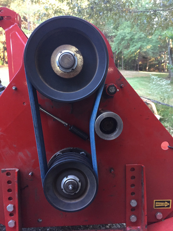

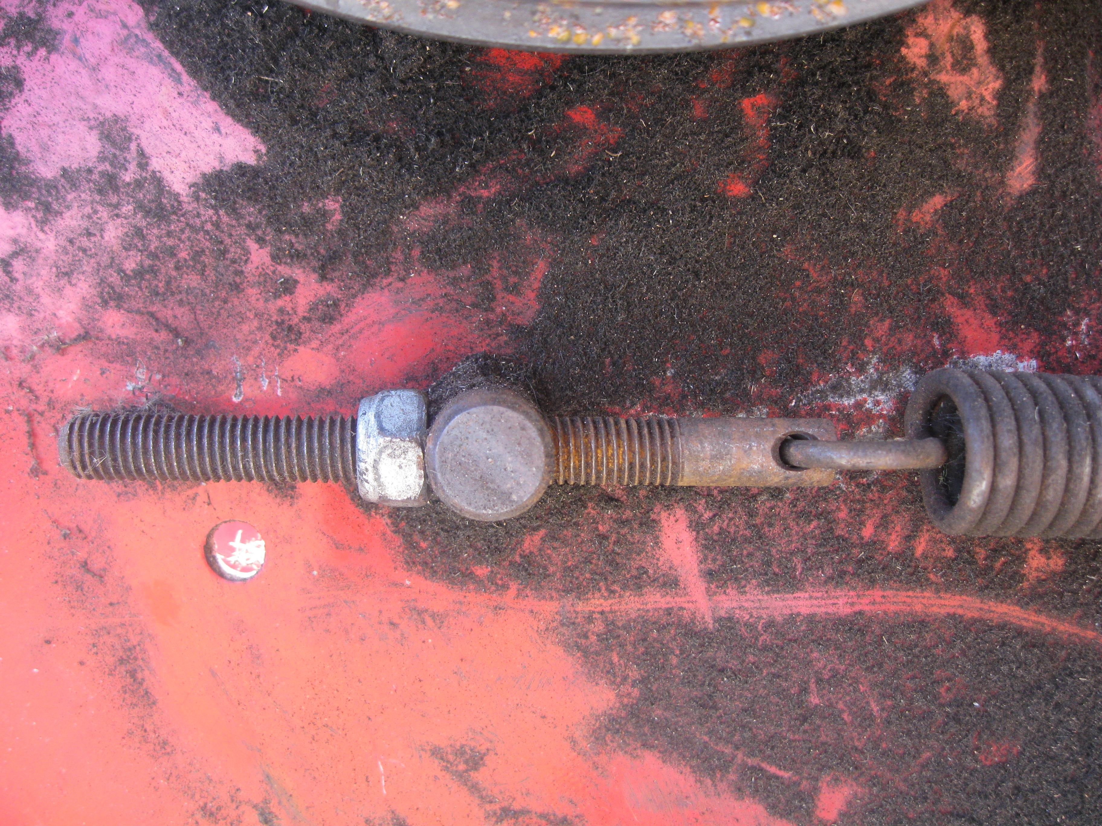

I have the 1900 and everytime I use it, maybe once a year, belts break after a few hours. I keep everyting greased and have about 3/8" play in belts (width of belt looking at it from side). Here is a picture of where my adjusting bolt is on thread. If someone could please post pic where they have theirs adjusted maybe it will help me with mine. I remember seeing a picture on forum before but can't find it. Thanks

Your V belts are much too loose. If you purchase a Gates V belt gauge from amazon you will always have the correct tension on your belts otherwise you chould have no more than 3/16 of an inch of slack on both belts.

After reading the long post on caroni flails, it looks like some are adjusting the tensioner spring all the way, I will definetly go tighten, maybe all the way.

From your picture, I have a different guess. Something else is wrong, look at all of the rubber shavings left behind. Maybe the routing or width or....

I was having the same problem last year, belts breaking right and left. Possible reasons included, mowing speed too fast, too slow, mower set too high, too low, misaligned pulleys, too much/ too little belt tension, too much grease, not enough grease, dull blades, wrong blades, wrong drum rotation, pulleys rough, pulleys dirty. Ugh! I was so frustrated that I was ready to sell the Caroni. As a last resort I decided to install 45" kevlar belts instead of 46" belts. That was almost a year ago, dozens of hours of mowing time, 20+ acres mowed and still going strong.
I recently ran over a piece of steel cable hidden in the weeds and choked the tractor down. After removing the cable from the mower I checked the belts, expecting them to be trashed. To my surprise they still looked new even though they were almost a year old.
The 45" kevlar belts solved my problem of breaking belts every few hours.
Here's a pic of the 45" belts installed. Not a lot of deflection by the idler pulley, less belt to idler contact , less back flexing of the belts and less heat could be reason the belts have lasted so much longer.
