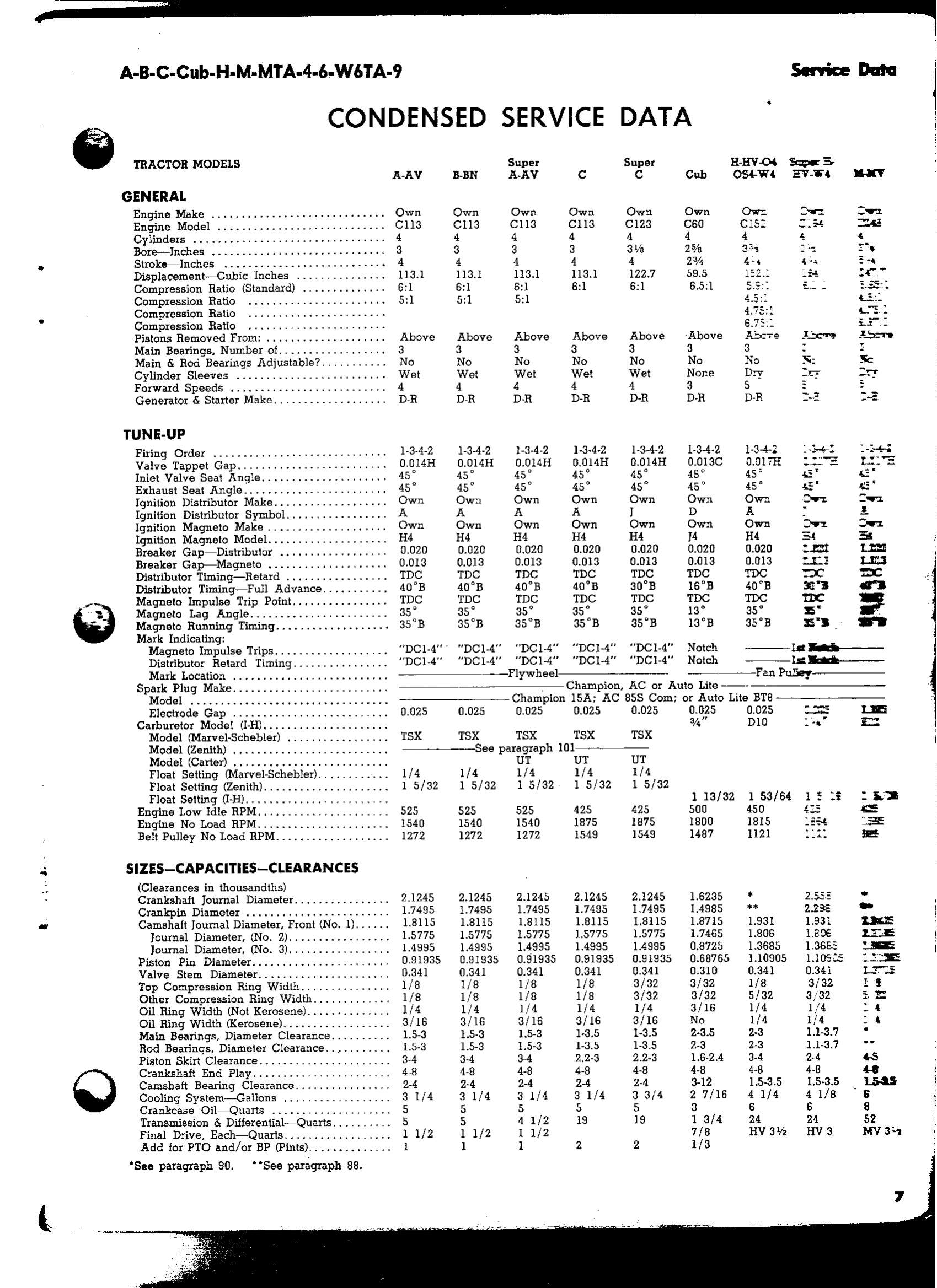

I'm overhauling a 1954 Farmall Super C carb. It's a Zenith 8-04 #12911 385608R91. I cannot find any literature on setting the float travel distance. Can somebody tell me where I can find that dimension?
   / Carb float setting #2
The setting is 1-5/32".
I've attached a multitude of specs, and that is included just below half way down the page.
You should be able to print this page for later reference, for..., whatever...
Also for maybe some that have never done this, and want to, I've attached a picture of what/where to measure.
Hope this helps..!!

Thanks (again) for the information, DJ54. Especially the diagram. I'm sure I would not have thought to include the thickness of the gasket.
Let's see........5/32 is a bunch of those little, bitty marks, isn't it?
