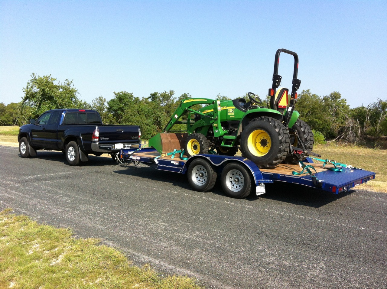

   / Car Hauler or Equipment Trailer -- What is the difference please? #8
Car hauler.
Here's my 18' 7k trailer with my JD 3520.
