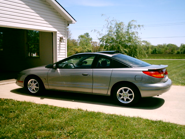

Ok, I probably know the answer but here it is. I have a 1999 Saturn SC2 with the 1.9L DOHC engine and it burns oil. It has burnt about 1 qt every 1000 miles for the last 20,000 miles. I have done some research on the net and found out that this engine is known to have ring problems. I have not done a compression check yet but I am guessing this is the problem. The car runs great and looks good plus it still gets 31 mpg town and 38 mpg highway. By the way it has 111,500 miles and is a auto.
The engine is still used in the Chevy Cobalt and I am hearing problems on them also. It calls for 5W30 oil but says it can use 10W30 above 32 deg. I have used both oils with no difference in oil consumption noted. I tried some Sea Foam in the oil and I also tried some Marvels Mystery Oil, not at the same time, with no difference noted.
Is there anything I can try to help this engine out? I have always used conventional motor oil and have never tried the high millage oil. What is the difference? I have also seen a product called Restore that claims to improve compression, does it help or would it help in my situation? Any suggestions would be appreciated but I have a feeling a rebuild is going to be in order or just let it keep burning oil.
