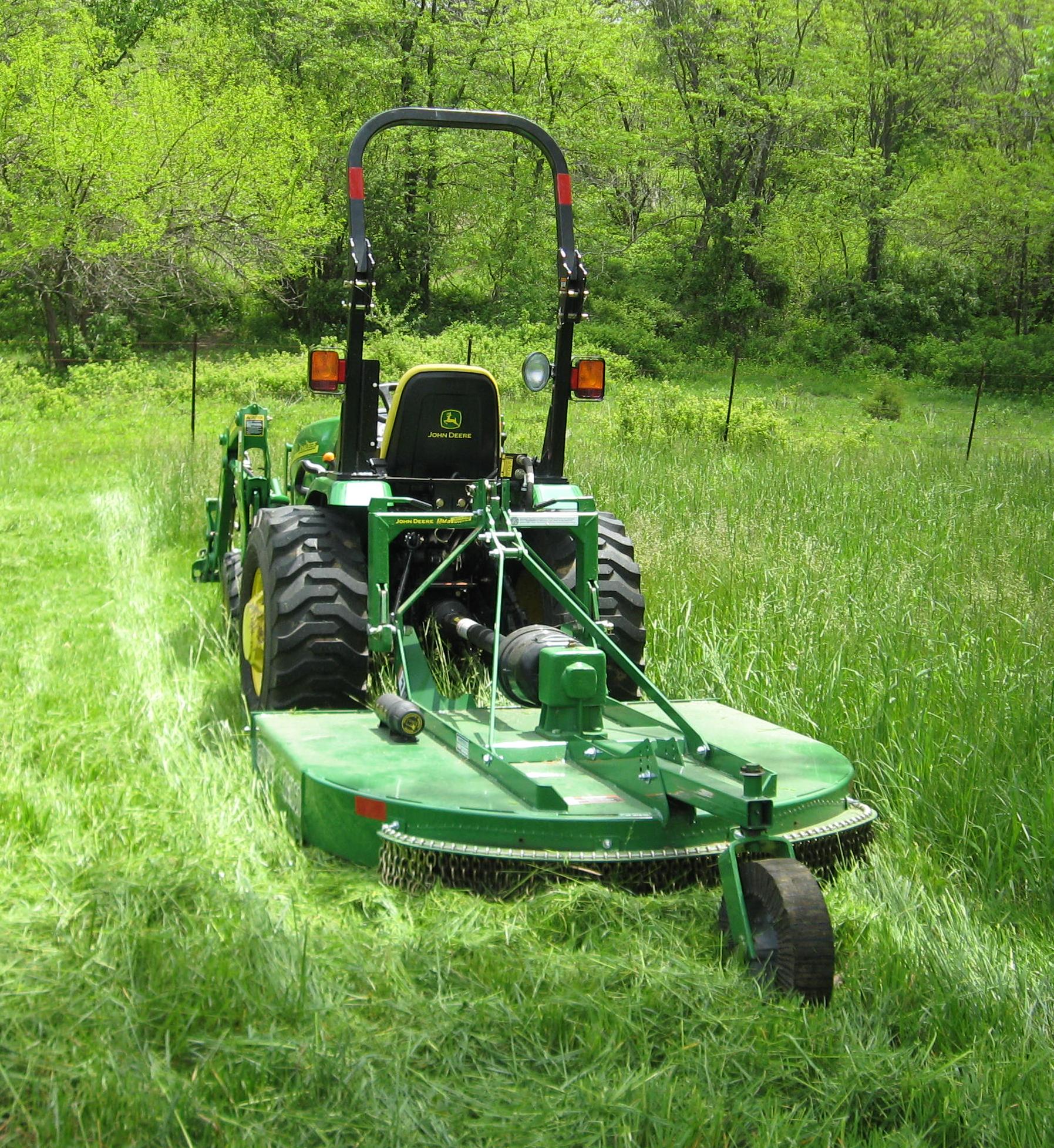

Tom,
I use a 2520 with a Frontier RC1060 rotary cutter on a 4 acre pasture without problems. I have very hilly property and keep the loader frame on, without the bucket. In that configuration, I can stand on the back of the RC and the front wheels of the tractor won't come off the ground.
If I were going to mow without the loader frame, I would use some front weights on the bracket.
No problems power-wise.
