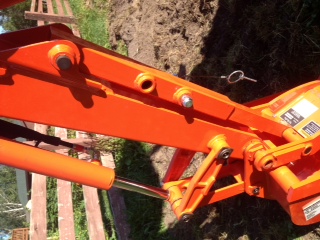

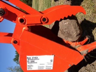

I used my BH65 16" Backhoe bucket and BH1976 thumb to dig and remove a rock. Now I cannot get the holding pin to budge; it feels like its welded to the dipperstick. Any tips? (I have a call in to the dealer, but its a busy time in Northern Minnesota).
Thanks, Dianne

I have a BH65 too, but the factory thumb (not sure if that's what you have). The pin was stuck when I first got it and using a big hammer and a properly sized punch / pin and WD-40 I got it out. Hit both sides with penetrating oil and let it sit, if you can rotate it do that. I also discovered that you can pry on the handle too. I now rub my pin with grease every time I grease the hoe (10 hrs or so) and that keeps it free.
So here is the bucket and thumb and the silver "pin" in the second picture is just in there. I will get a BFH and try to loosen it up. Thanks all. Dianne
   / Can''t get the pin out to return mechanical thumb to original position.
Worked great. I got a 4lb sledge (always good to have) and a punch (thanks for mentioning the punch, wouldn't have worked without it). Good to go. Dianne
