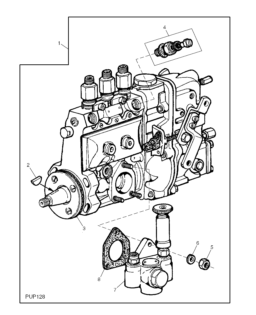

During this past cold spell the fuel gelled up in my 5203. Filled the tank to the top with new fuel, added fuel treatment, installed a new filter and it is 45* here today. I have been trying to bleed it as per the manual, and haven't had much luck. I finally got fuel to flow properly out the bleed screw in the filter housing (after about 100 or more pumps of the primer), but haven't been able to get any measurable amount to come out of the bleed screw on the injector pump. After 200-250 pumps I've gotten maybe a table spoon of fuel to come out of the injector pump screw. I'm wondering if maybe the primer pump is shot? Any other ways to go about it? Any thoughts or advice would be great, thanks in advance.

Are you 100% sure you have good fuel flow from tank to the fuel filter?? If so for difficult bleeders I blow compressed air in fuel tank neck with a rag filling up remainder of filler hole. I only carefully give it short bursts of air so as to push fuel through filter to injection pump. If your 5203 doesn't have a hyd controlled trans I would tow start it. I once owned a 3000 Ford that I could wear my fingers out pumping primer pump and it wouldn't start. Hook a chain on the 3000 and pull it not very far and it would crank. Does your tractor's pump resemble the one in photo?

I'll give those two tricks a try if cleaning the hand primer out doesn't help. The injection pump on mine is a rotary type pump with the injection lines coming out the back. IIRC it is a Stanadyne pump. The hand primer pump is on top of the fuel filter/water separator. I'm pretty sure the fuel flow is unrestricted, when you open the drain valve on the bottom of the fuel filter fuel comes out in a good stream.
