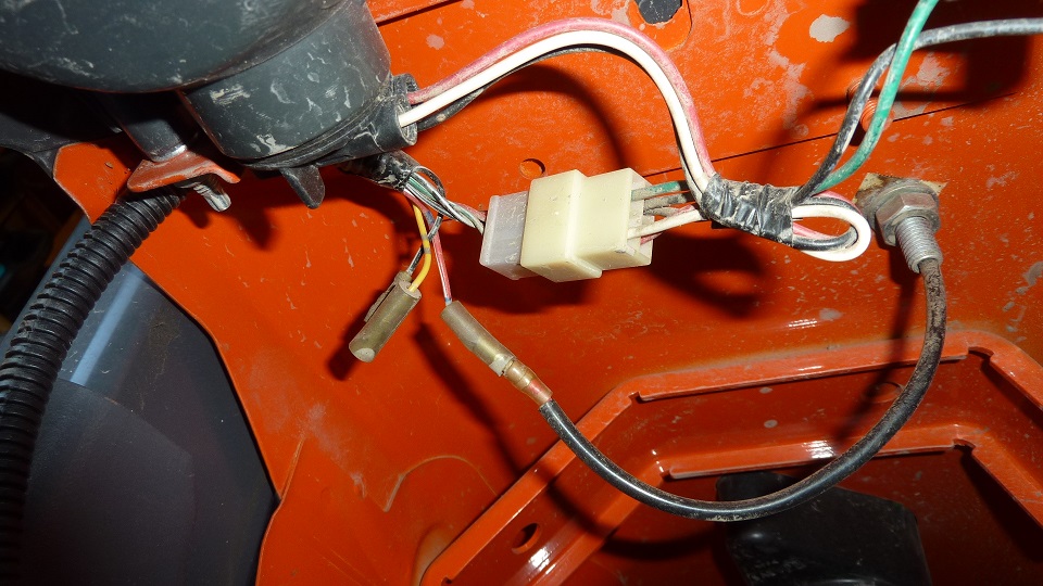

I have an M6800 and would like to hook up a rear work light with the supplied wires under the rear fender. I have done this before but can't remember how. I can see three connected wires running to the rear taillights and one male pigtail hanging loose but that one is not hot. I'm at a loss.
It seems there were two wires hanging down before but I don't find that. Where is the hot wire? Is it part of the three connected wires? This setup must be the same on all M Kubotas and probably all Kubotas. Any advice helpful.
EDIT--Here's a picture. Just three wires and something hanging down that is not hot. I now the hot would be a female connector but not sure where it is or if I tie into something else or?

The wiring on my MX5800 is different. There are two wires hanging down under the right fender, an orange one with a female connector and a black (hidden by the orange in the pic) with a male connector.
The manual illustration seems to indicate the orange wire is for remote use but doesn't mention the black wire. I haven't tested the MX yet but on my L3430, the orange wire was only hot when the tractor was running. Hope this helps.

bdhsfz6--very helpful. Suppose that male connector is a ground? No info like that in my owner's manual.
I found two wires taped together between the fender and the roll bar and tucked waaay down there. That must be intended for the work light since one is hot all the time, key or not. There is a hole in the fender near there so my guess is that these wires were intended to be run through the hole and under the fender but just never were.

The black wire likely is a ground. I know from experience that the chassis ground is notoriously unreliable on 3 PT or towed implements.

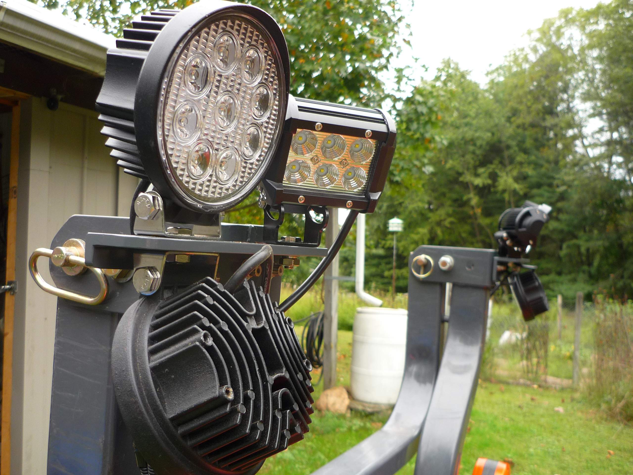

Sixdogs, you probably know this, so apologies, but I throw it out just in case. If you already have a halogen fixture of the right wattage for the 10 amp circuit, you might as well use it. An LED work light will draw just as much current as a halogen work light rated at the same wattage. It just produces a few more lumens of light per watt. Color temp of the light produced is another issue, though, and can be a matter of personal preference. Some of the LEDs are too cool in color temp for some folks. Others say the lower, more blue, temperature gives better contrast. So need to keep in mind the claimed Kelvin rating. I love the four 45W LED work lights from China that I retrofitted on my Kioti, and the prices seem to keep dropping.
Assuming nothing is already on that 10 amp circuit, I'd limit the total wattage to 90w max (e.g. two 45w fixtures). At 12V, Ohm's law technically says 120W at 10A, but that's in theory only. I've heard that automotive-style fuses are often designed to blow at around 80%-85% of their rated capacity, as a safety margin. The OEM circuit for the four OEM 35W halogen work lights on my Kioti was fused at 15A. Theoretically that would support the four 45W LED retrofits (12V x 15W = 180W). But I kept blowing the fuse after 30 minutes or so, even with the higher operating output of 12.7V - 13V. So ended up putting two of the new 45W on a new circuit, and added two new, additonal, 18W LED side work lights to the original 15A circuit. FWIW

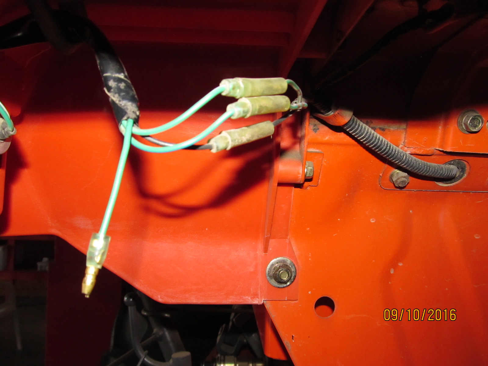

bdhs--My picture is the top one and the wire with the male pigtail is the one I wonder about being a ground. What do you think?

Edit: Forgot to mention the suspected ground wire. Using a tester, with hot wire on, use the suspected ground wire to complete the circuit and see if the tester lights up or registers voltage?? If so, it's a ground circuit. If not, it's not.
The wiring for the full size M's is obviously different than the MX series. If your green wire is a ground, it appears to be a heavy enough gauge to handle a 10 amp circuit. As ovrszd suggests, it should be easy enough to test if you have a volt or ohm meter. In any case, a ground is far easier to come by that a spare hot lead.

Good advice. I'll find one of my lights tonight and post a picture.
