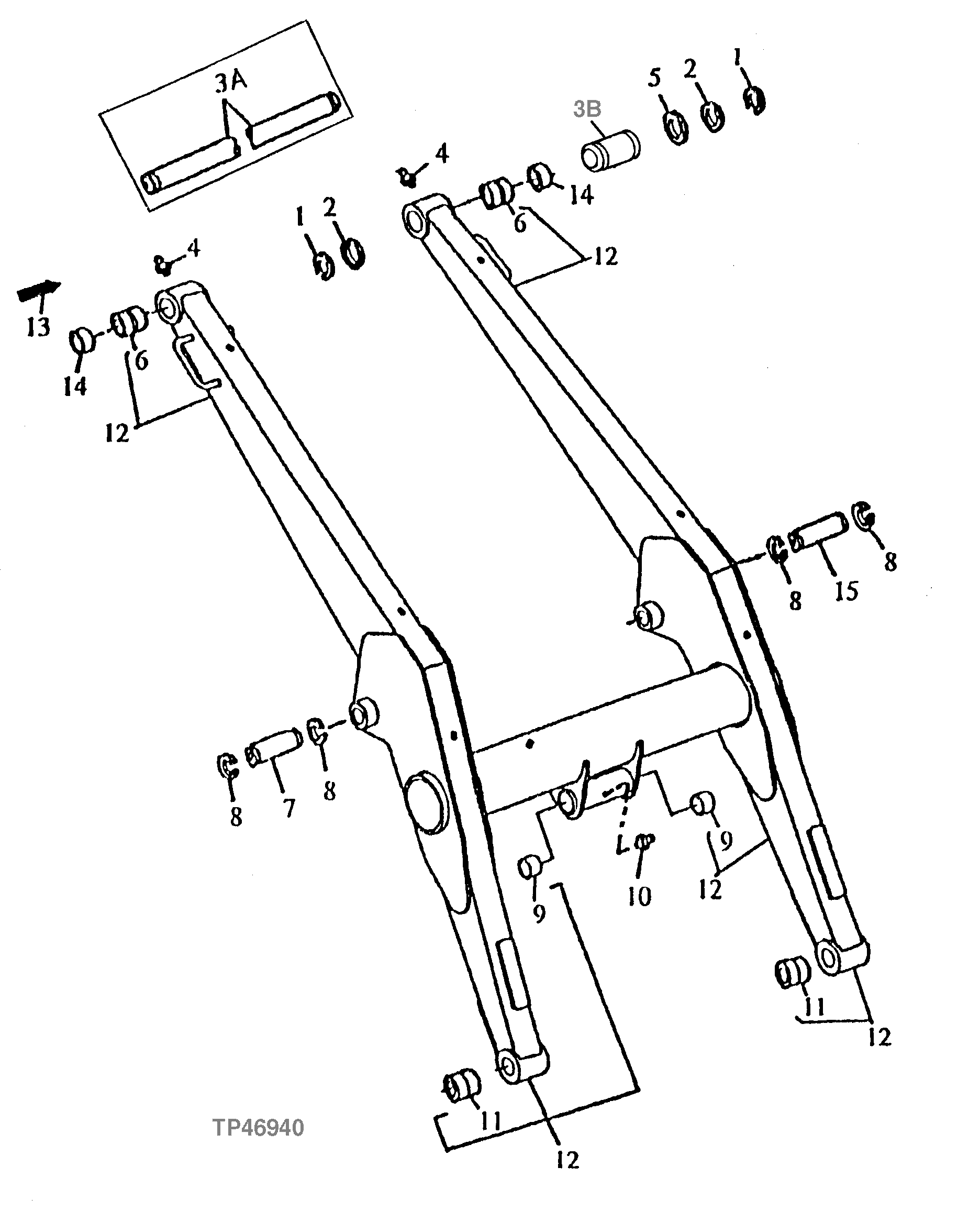

Which pin do you need? JDparts shows bushings for both ends of the boom.
   / Can't find loader pins for 1974 John deere 300b #7

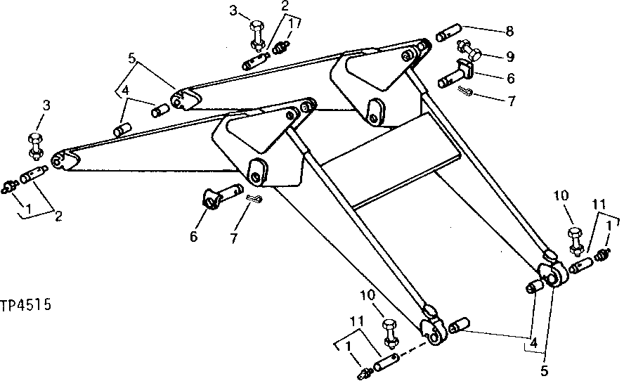

John Deere 300B or 300D? Title has one thread has the other. Drawing posted in post #6 is 300D. Here is 300B:
