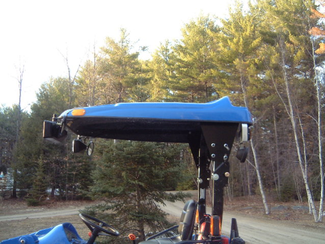

My canopy is a Firebird brand. (non insulated) Pic attached. By design it already sits well above the top of the ROPS (see pic 2)
With the camel hump built into it it could be lowered but the ROPS hinge bracket are in the way. I could actually raise it maybe 3" more if I wanted to.
I am 6' 2" and sitting down in the seat, I have about 1' above my head. If I stand up, I have to bend my head down (chin to chest)
