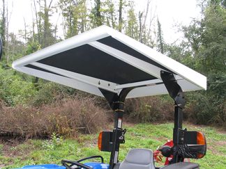

My NH canopy is a bit different. It is the steel canopy with a smooth finish with some type of rubber matting underneath that appears to be about 1/4 in thick.
For the price of the canopy - it should have been lined with gold or had a free tank of fuel thrown in with purchase /forums/images/graemlins/grin.gif
Maybe you can see detail on the attached pic

Shazzam.. that canopy looks darn nice.. I'll bet it was a pretty penny.
Both of my NH cannopies are what the dealer called 'the old style' Just bent/ formed aluminum diamond plate, and some sort of fiberboard backing, and brackets.. course.. he only charged me something like 320$ as well.. and had the service guy install them (free) before delivering the tractor to me. I was happy... I don't care if they are old or not.
