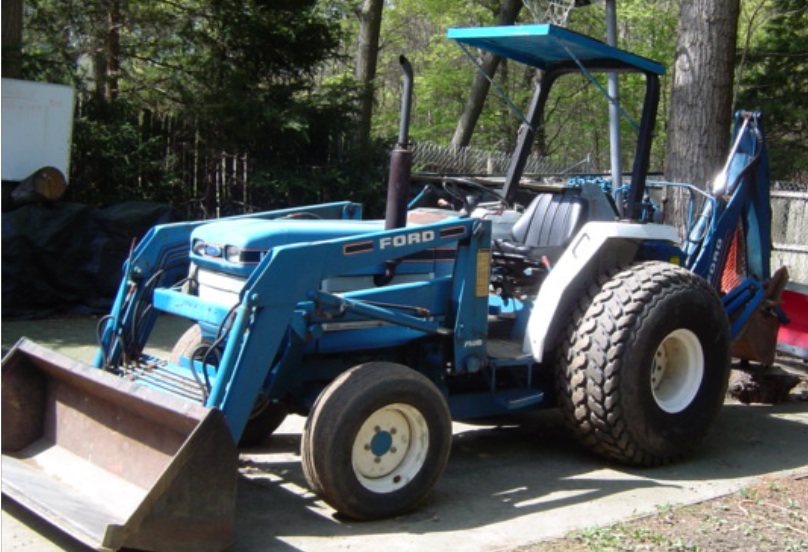

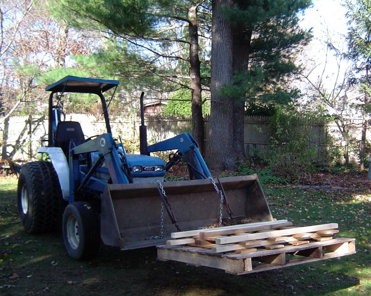

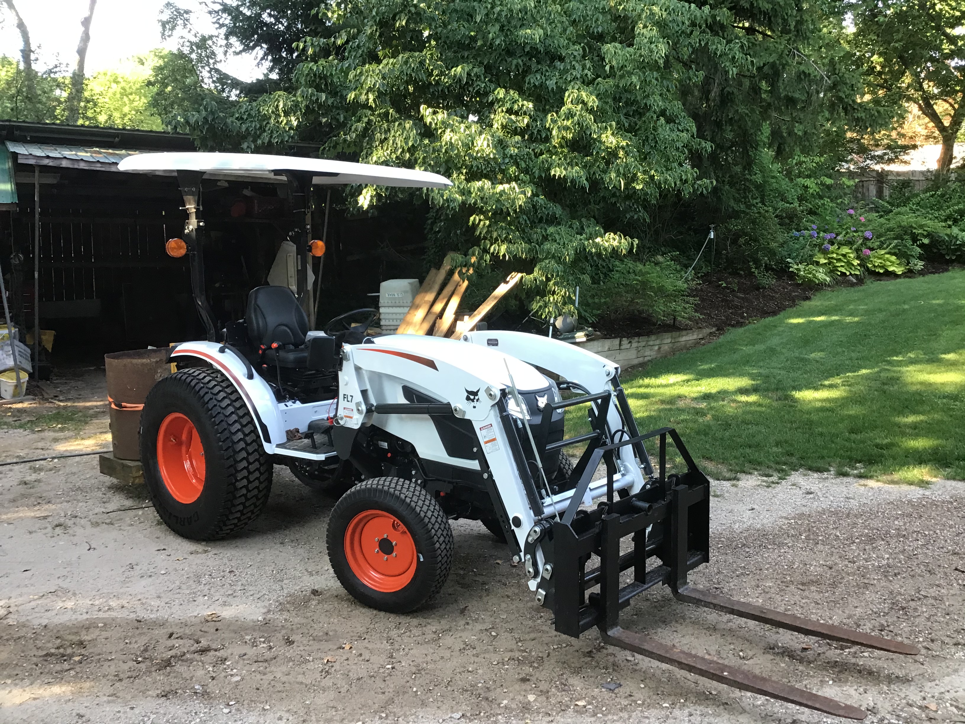

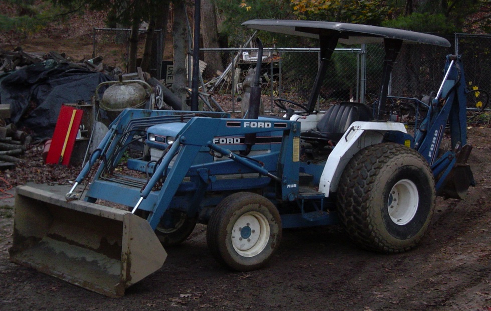

I made a canopy for my ford 1920 tractor out of a junk CJ7 Jeep hard top.

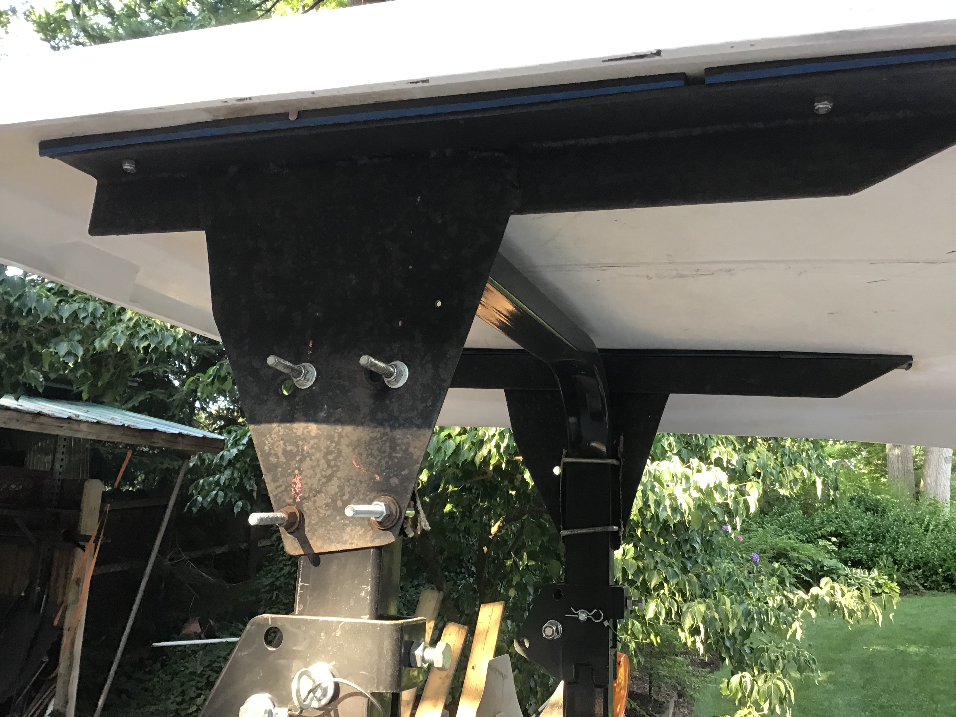

Removed broken glass and cut off sides. With a little sanding and Ford gray painting was ready to go! Bolted it onto the ROPS with bolts from Ace hardware.
The engine went and I gave the tractor to my brother who has the exact same tractor for parts.
Bought a new bobcat tractor 2025 model.

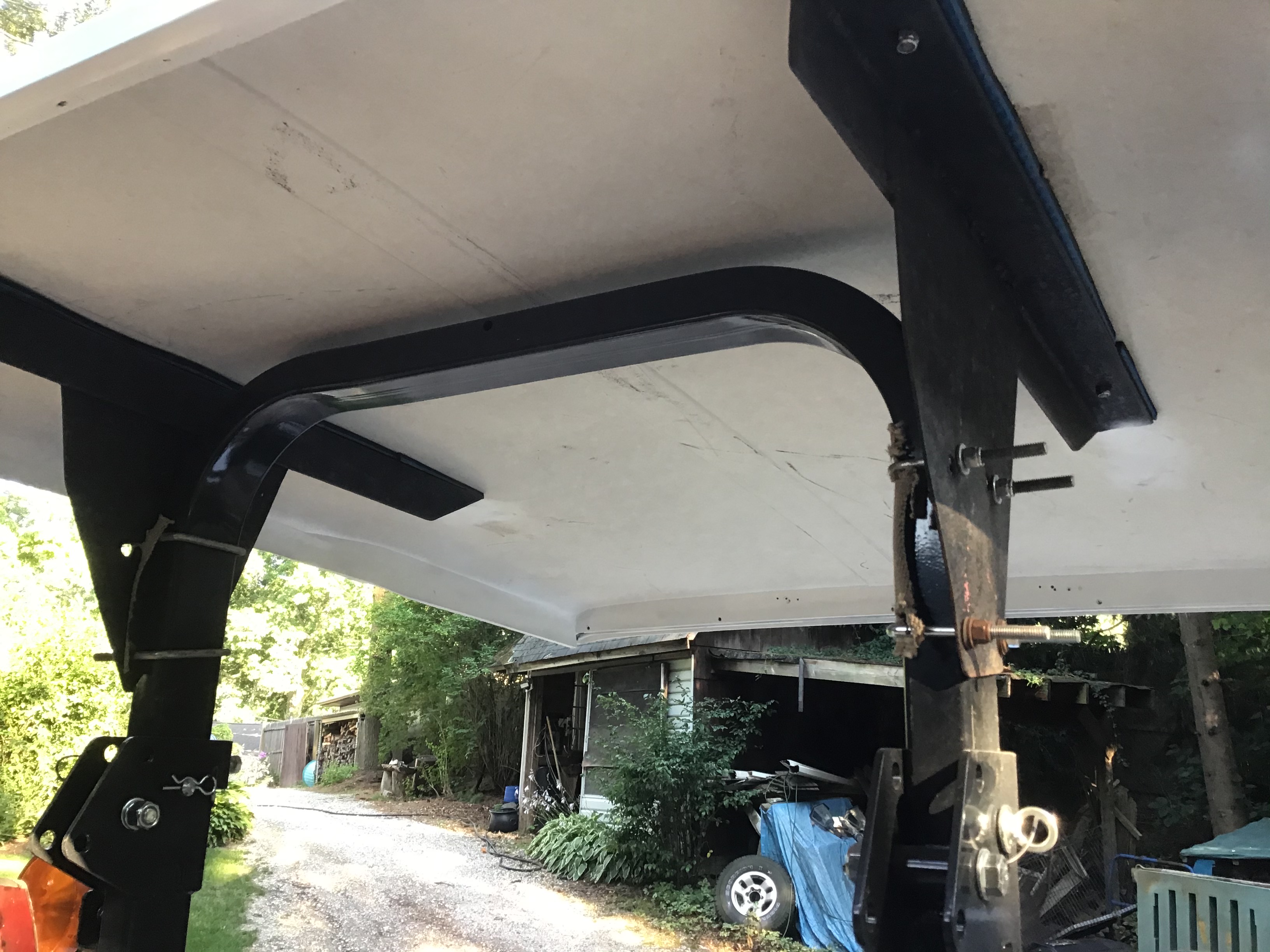

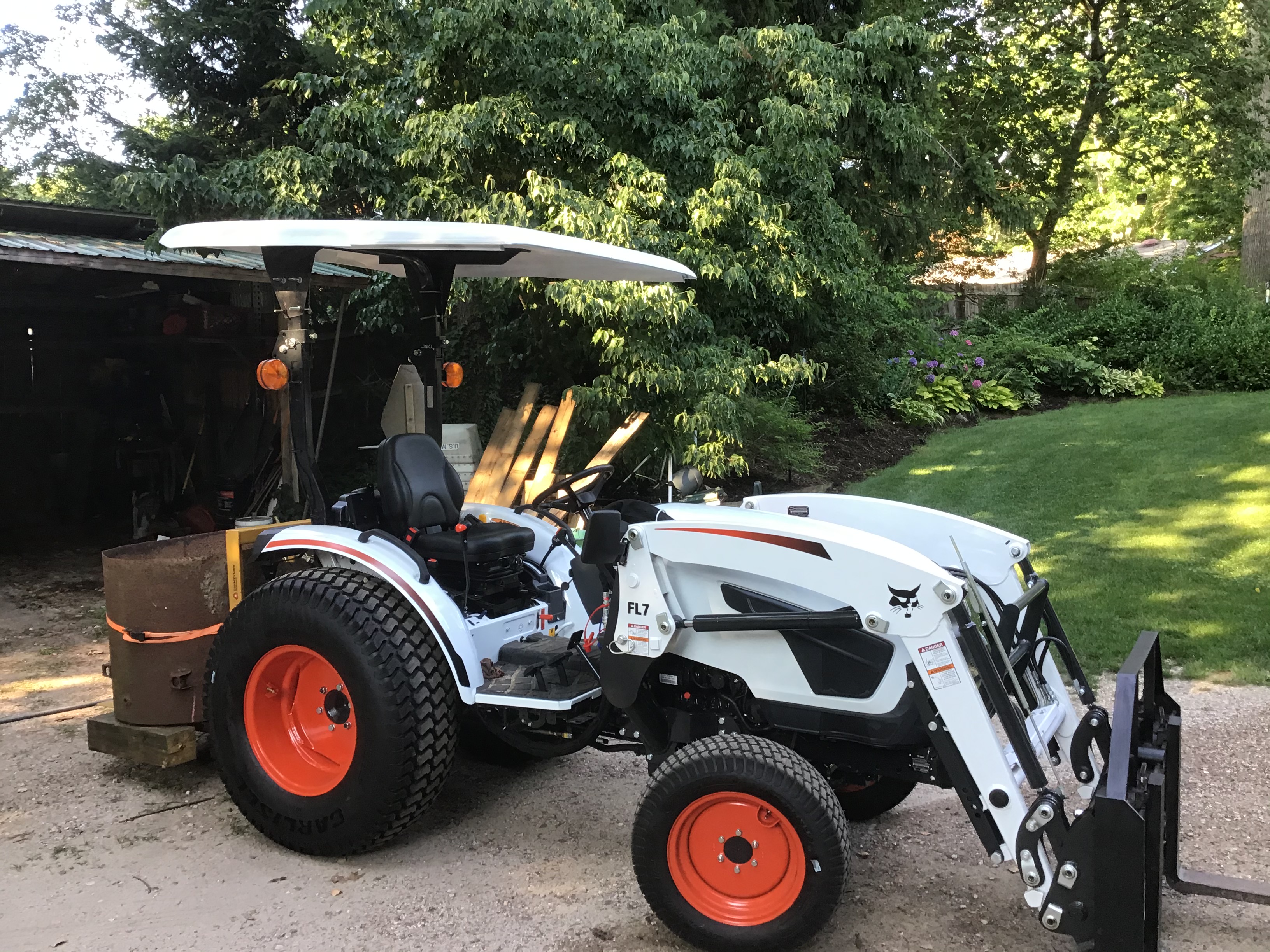

I had to redrill a few holes to mount old canopy to bobcat tractor. Repainted Ford gray with white gloss paint and I'm good to go.
I'm posting this after reading of others making their own canopies and thought it would be good to share.
Looks pretty good and will protect from falling branches too.
Mike
Some pics for you
Canopy that came with 1920 tractor, JeepCanopy on 1920, same canopy on bobcat tractor repainted in next post

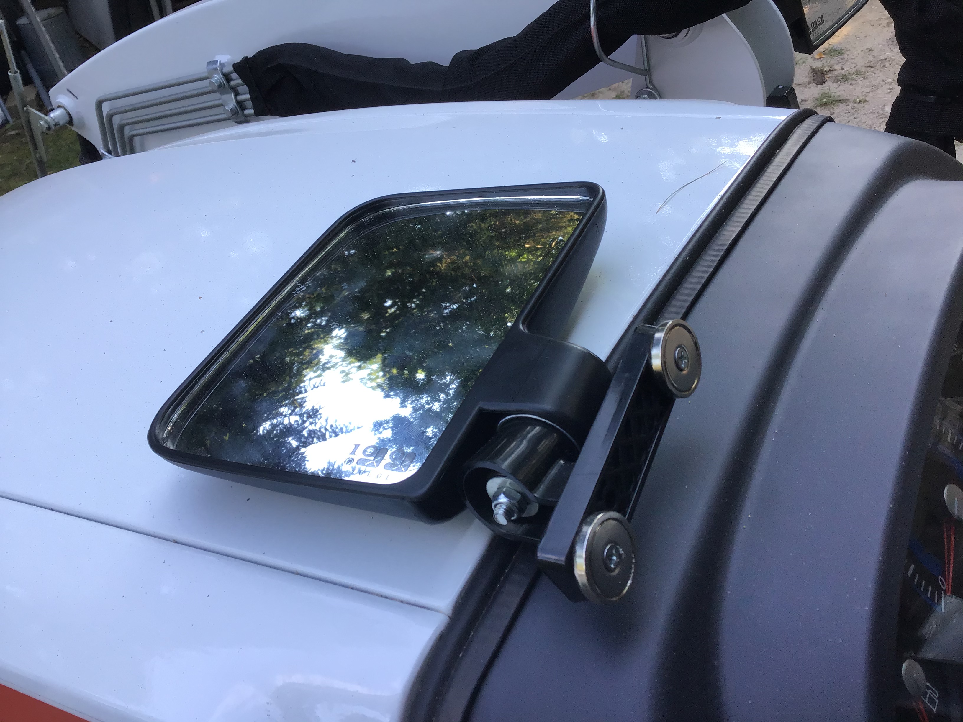

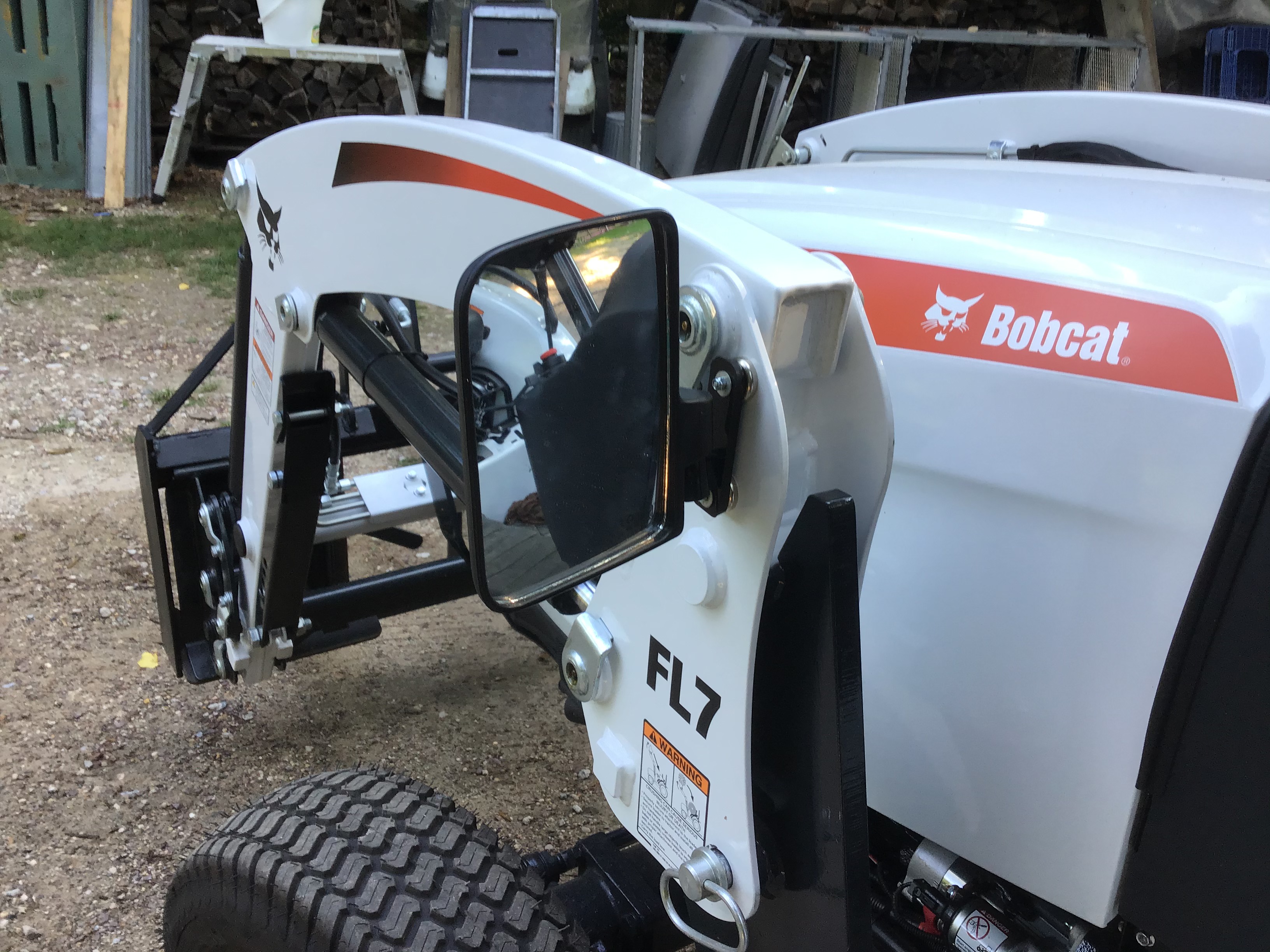

I also added side golf cart mirrors with magnets I added to em
Cheap ($15.00) and haven't fallen off yet

Looks good! I like your brackets for the canopy. I have been thinking about mirrors too, I might take your idea using Magnets for the mounting.

Looks like same mirrors I used on mine but bolted.

Nice canapy, good use of an old top.
I like your mirror mounts with the magnets,
but I would add a lanyard of some type to them otherwise I know that I would end up driving over them when they get knocked loose. :D
