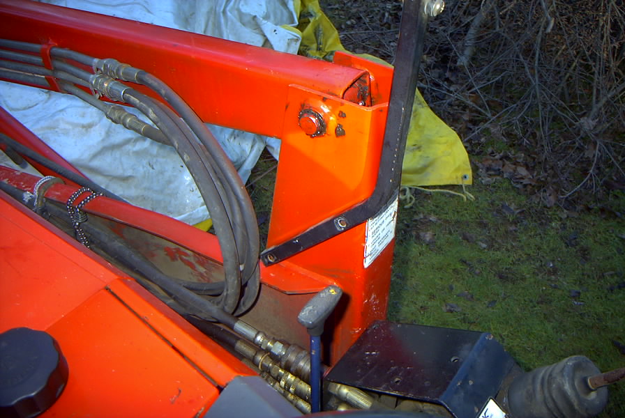

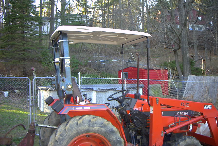

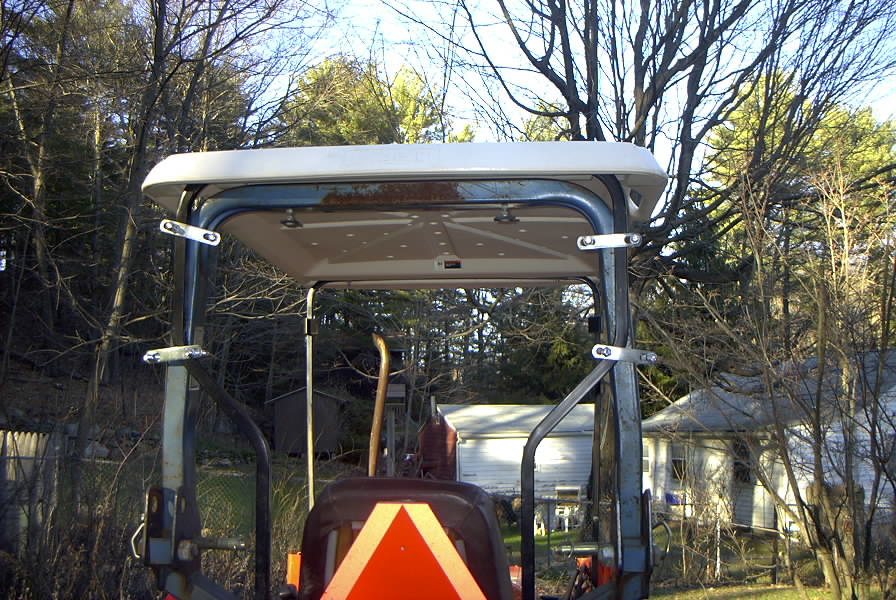

Hi all & HAPPY NEW YEAR!! Since old man winter is a bit slow in coming here to NYS, I decided maybe it was time to add a canopy before the snow arrives. I went to my local golf cart repair shop and bought a hard shell cart roof for $100. Sure beats the aftermarket model for $300.
Anyway, I'm in the process of attaching the front & rear supports and would appreciate suggestions from the brain trust out there. I've learned from reading this forum that there are a lot of great ideas out there and that it's best to get input before the project is complete. So here goes:
Rear supports: I just clamped the steel channel to the ROPS (see rear support pix)
Front support: I'm thinking of drilling & tapping two 1/4" holes into each side of the loader support (see front support pix)
My goal is to make it easy to remove the roof when trailering & traversing the woods or other areas where it might snag.
I have another question too :confused: should the roof be installed level or slightly elevated in the front for runoff purposes? (see side view pix).

Looks really good to me. :)
One thing you might want to consider is putting a thin piece of rubber between the canopy brace and the ROPS bar just to make sure it does not rattle? Of course if it doesn't rattle then there is no reason for it!
   / Canopy - looking for input #3
You could use a piece of 1x1 square tube and bolt it to the loader plate with two 1/4" bolts down the centerline of the tube about 2" apart and the front canopy tube would slide into it and stop on the top bolt. This would give the upward support and still be easy to remove. Good looking top. Do happen to know the dimensions. I want to build one myself.

Nice work ! But i would suggest that you go with 3/8 holes in the front insted of 1/4 inch. Quarter inch dont take much vibration to break.... Looks Good !! Curious as to how the canopy will fit on there...........

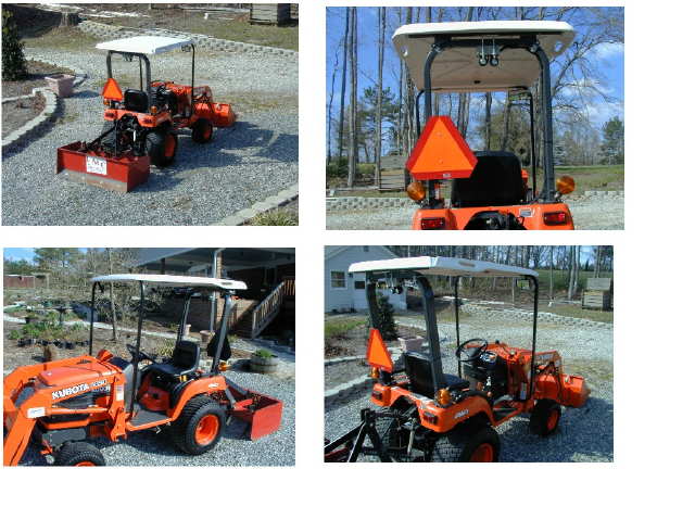

Thought you might like to see how I did mine on a BX 2200.
Bob

Bob, thanks for the pictures. A couple of quick questions & comments:
1. How did you secure the canopy's front frame to the tractor / loader?
2. Can you easily & quickly remove your canopy?
3. I see your canopy is tilted rearward - that answers the question I posted.

im just NOT a big fan of the front supports for a number of reasons
1) dont like the look
2) dont like the fact they are likely to be in the way of something
3) dont like how you would have to unbolt them to remove the loader.
so instead simply take some 1" sq tube and modify the frame that holds the top like so.
this allows you one (clamp on if you perfer) mount at the rear.
1) makes it easy to remove
2) keeps the front supports out of it
3) looks better (IMHO)

My front supports run to the floorboard, then turn 90 degrees toward the tractor. On the BX 2200 there was already a hole in the floorboard with a bolt through it. A longer bolt was used to run through the same hole to secure the front supports.
It can be removed fairly easily, but is a little awkward holding a large top like that with one hand while loosening the bolts with the other hand, then holding everything so it doesn't fall on top of you. As you know, the top does not weigh much, so weight is not a problem. My wife and I can easily remove it together. I thought about rigging up something in the garage ceiling to hold it, but have never gotten around to it. I only removed it one time, and that was when the BX 2200 went to the shop for warranty work.
The top does not touch the loader or any loader mounting hardware at all.

Yes, it is tilted toward the rear a little. The thinking was that rain water would run toward the rear. In a light shower it works, however, in a heavy downpour, I still get wet. The best part about the top is keeping the sun off of my bald head.
Another poster stated he did not like front supports. I like them because the front support can be a handhold for getting on the tractor; a rearview mirror can be mounted to the support, as can a tilt meter, cell phone, radio, hook for your gloves, or whatever else you want to hang there.
I did not design this set-up. In 2003, Danny Williams was an active TBN poster who came up with the design. I asked him about the attachment to the ROPS as well as the front supports, and he made a set for me. I paid him for all the materials and the shipping, plus a little extra.
I have not seen Danny on TBN in quite a while. He was making his own FEL, and I wanted to when finished.
Good luck with yours. If you need better pictures from me, let me know.

I think front supports would make your top much more stable and keep some things from whacking you while in the brush.
