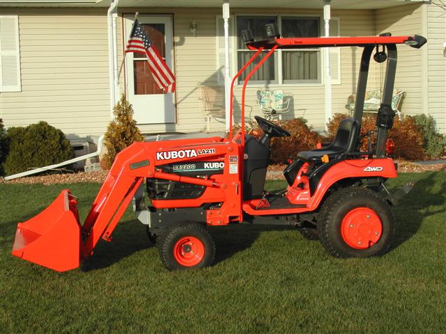

Just thought I'd post this. This was the roof of a Curtis Cab that came in damaged to my dealer. I bought it for a good price, but it didn't come with any mounting equipment. Welded up a front mount that bolts onto the front of the operator platform, using the existing bolts. I used my previous light mounts to bolt on angle iron to the back which in turn was used as the rear mount for the canopy. This made no permanent alterations to the tractor, and can be completely removed if I want. This pic is from the side.

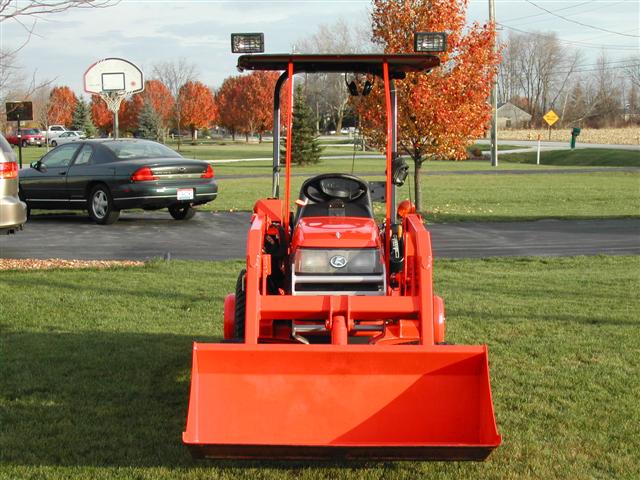

Here is the canopy from the front

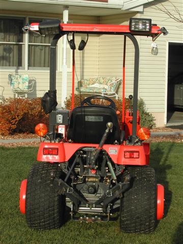

from the rear....

looks good...wouldn't work for me....gotta fold down the ROPS to get into the garage.

Nice job....can you add a windshield for winter use?
   / Canopy install for BX
Actually, I could. Alternatively, I could also add a golf cart rain cover fairly easily as well. Someone here posted that as a project and this is where I got the idea for a front support. For now, I probably won't add either, but it would sure be easy enough to do if I decide I'm getting too old for the weather... /forums/images/graemlins/blush.gif
