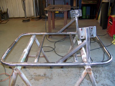

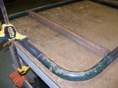

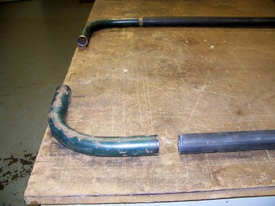

I was cleaning out the horse pens the other day and bumped a tree with the FEL in wich that bump made a bump on my head from a limb that fell out of that tree. So I said to myself no more. I had some 90s off a hand rail and some pipe so this is what I came up with.

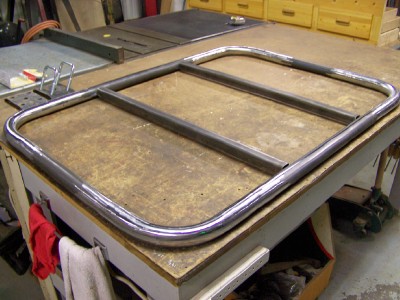

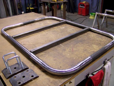

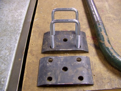

I wasnt sure on the size of normal canopies but had enough material for a 4 footer. I had some trailer spring plates and used them for the bolt on brackets.

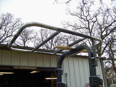

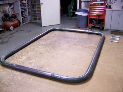

Test fit. Got lucky I guess.

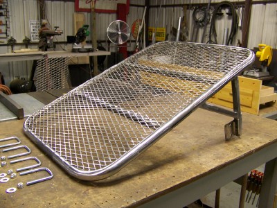

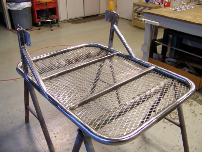

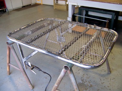

Got the expanded mtl on last night and it realy got heavy. now I just need to figure out what color to paint it??

Looks good. Ever thought of using aluminum to plate the top (rivet) insteat of the expanded - that way it will shade and protect you for the same if not less weight! Looks great though!
   / Canopy/head protection #6
John D said:
Got the expanded mtl on last night and it realy got heavy. now I just need to figure out what color tha paint it??
Paint it Kioti orange & I'll PM my home address! :D MikeD74T

Rocker it was your hood guard that gave me the idea for the expanded metal. I have an old golf cart top that will fit it but I want to be able to see through it.
LMBO Mike. I do like orange but it just dont go with green too well. jb
