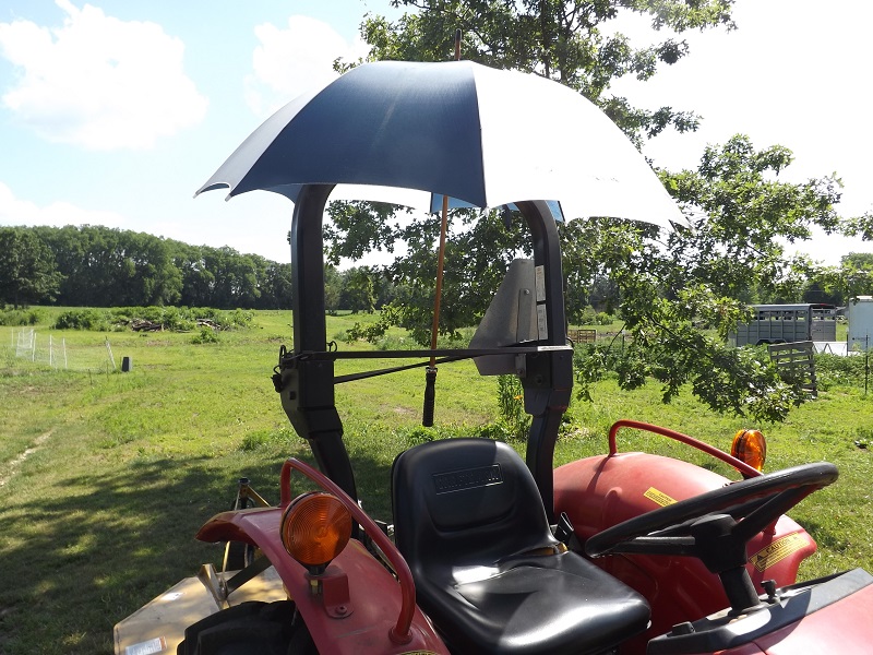

Has anyone mounted a canopy on the ROPS of their Yanmar? West Tennessee sun can be stifling from June through August, and I was thinking about taking a flyer on one for my YM2000B.
Do you mind sharing pics and reviews?
Would you buy it again?
If so, why?
If not, why not?
Thanks!

If you already have the ROPS, you should be able to attach to it. Just do not drill holes in your ROPS. There are a wide variety of ‘U-bolts’ available at hardware stores. A bit of tubing can be worked onto them to to reduce rattle noise if desired. A bit of silicone caulk should water proof holes in the wood for the bolts. You might wish to add a bit of 1x2 or bigger close to the edges for reinforcement and allow some rear overhang for a bit of counterbalance.
All in all I see no reason why wood would not be an option if the ROPS is present.
If no ROPS, I question if you would get the necessary support from a wood frame that would fit in the area and still allow free access to the tractor function.

I have ROPS.
My post regarding wood was made in jest to point out my total lack of skill in metal working.

I have ROPS.
I have seen guys make canopies out of lots of crazy items so why not a piece of plywood? Makes as much sense as a dumpster lid.
