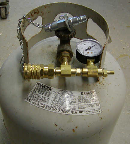

I made this "carry tank" from an old propane tank. I left the tank open in the sunlight (after it was empty) to let any traces of propane escape. Then I pumped it down with a vacuum pump, opened the valve to let the air in, and then pumped it down again. The escaping air after five cycles was not flammable - it does, however, still smell a bit like mercaptan (odorizing agent for propane).
I put a pressure valve on it, and made a Male-to-Male adapter to allow me to fill the tank from my hoses that have quik-connects, or I can use the Schrader adapter on the right (similiar to a tire valve) to use a tire pump or gas station hose for inflation.
A tank at 100 psi. can drive about 90 - 2inch 18 gauge brads. You have to pause ~2 seconds between shots since the tight valve doesn't allow fast equilibration. You may also get some minor change in the driving depth of the brad as the pressure drops. It is, however, just the ticket to trim out two windows or one doorway without having to drag out a lot of hose, or do a small job at a site without an air compressor.
One of these days I'll get around to painting it a different color, and label it as "COMPRESSED AIR - NON FLAMMABLE".

Chris..... do you know what the safe maximum amount of air pressure you can put into one of the propane tanks? Since the new design has been mandated, there are a lot of the older ones available just for the taking.
