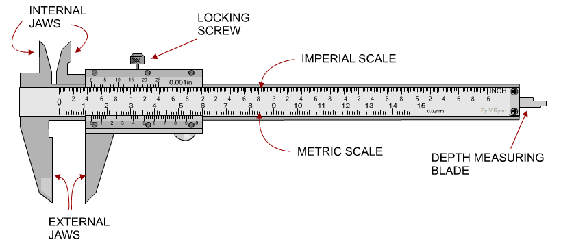

This is what I use to see what size wrench is needed, vernier calipers:

11/16 = 17mm
