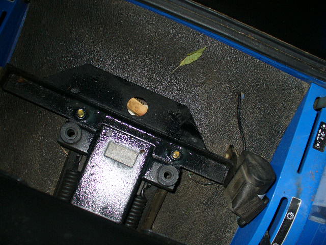

My new 40da has the annoying parking brake beep my 35d did not have. Is there a way to get rid of it?
   / Can you stop the beeping? #2
I stop mine by setting the parking brake whenever I park the tractor. :D The owners manual has the electrical diagrams, so it wouldn't be hard to see where to add a switch to squelch the beep. By the way, I ocassionally need to stand up when looking to see where the edge of the bucket is, my tractor gives me about 1 second then shuts down the engine. I would like to add a switch so I could suspend that function on ocassion.

There is a little little switch under the seat that detects if you sit on the tractor or not, once you stand up, tractor shuts down if parking brake isn't set and tractor is in neutral. Anyhow you can jam a piece of wood between the switch and the frame, so the tractor thinks you are sitting in it all the time, thus never shutting the tractor down if you stand up. My 2004 TC55DA hasn't got that beeper in there, but i am sure there's gotta be a way to disable that critter somehow. Not that I want to encurage anybody doing this tho...
through that hole in the middle goes that switch. press it down and jam a piece of wood in it. Done. tractor will run and run... ;)

I have a bigger problem with the seat switch on my TC45DA, when it's cold, like 10F or colder, the seat foam gets so stiff that I (at 220#) do not depress the seat enough to close the occupancy switch. The engine shuts down even though I'm sitting squarely in the seat.
The seat switch has 4 wires , the inner two control the engine shutdown, and the out two control the beep. I wired in an auxillary switch on the inner two, so that when it's that cold, I can close the switch and operate the tractor. The aux switch is under the seat on the right side where it's convenient to flip in cases where I need to lean over to see the bucket corners while operating. It still beeps to warn me, but at least it doesn't stop. You could easily put such a switch on the outer two wires to stop the beeping.
