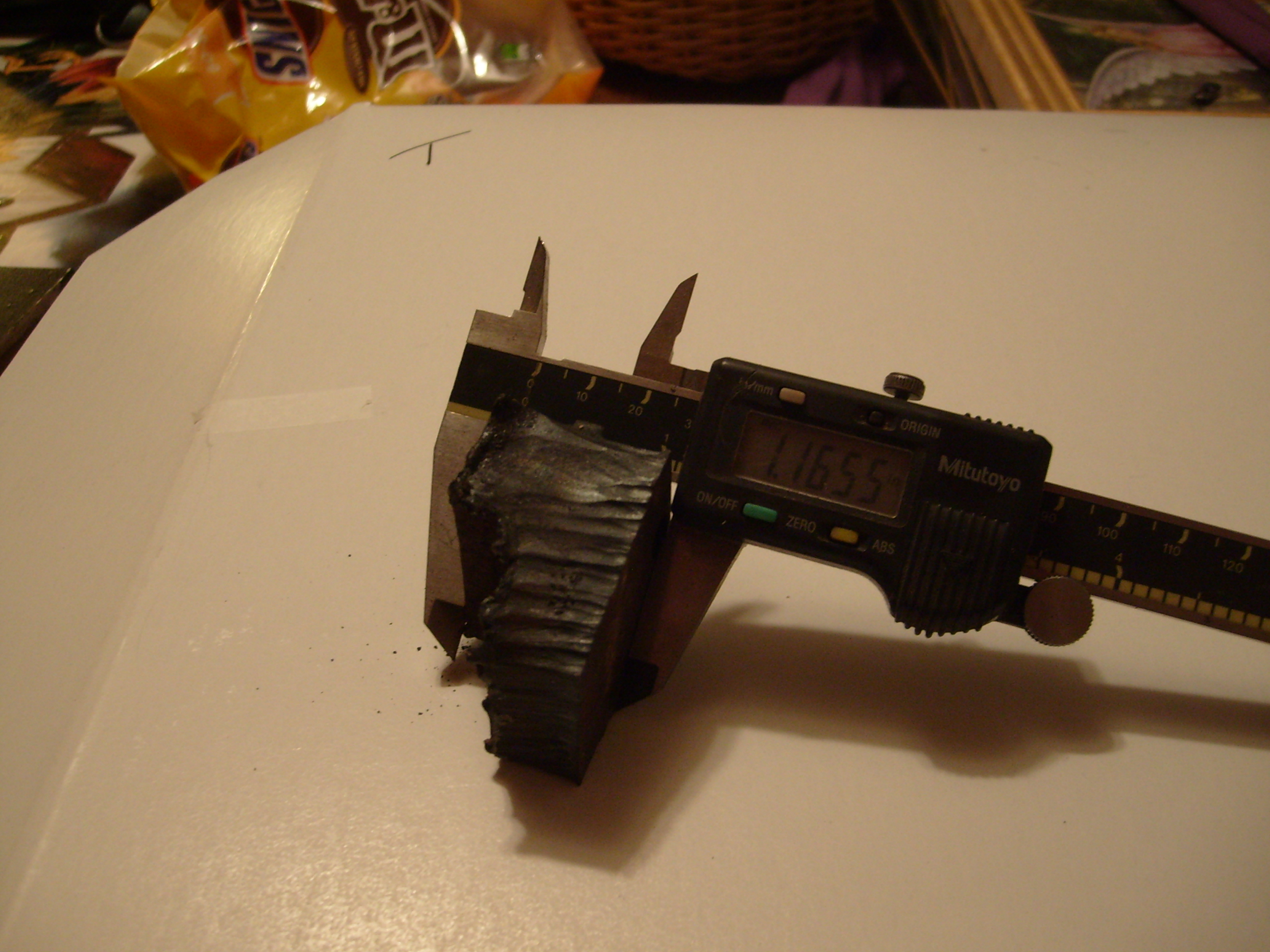

I am dreaming of the plasma cutter I see in my relatively near future.
I am going to go new because ..... all my other stuff has been bought used, and I commonly see advice on this bulletin board and others that a plasma cutter is a good tool to buy new.
My question:
Does the ease and quality of cutting thinner material suffer if you are using a more powerful machine than needed for that cut.
Most of my cutting will be in the 16 ga. to 5/8" range.
I have a couple of projects in mind that will involve ca. 3/4" or 1" steel. .
Will I be sorry doing cuts of thinner material if I went with a bigger machine - say rated 3/4" for normal operation (and thicker for occasional cuts).

Do you have a budget? I have an Everlast 60 and it will cut 1" thick steel. It's not going to be a perfect cut but for what I want it's fine. If I had more uses for one I would have gone with a Hypertherm 45 or maybe even a 60. They are built close to us in NH and the owner (I think) has offered tours to TBN members. The Hypertherm 45 is about 3 times the cost though. This is a piece of a flywheel that I cut.
   / Can you have too much plasma cutter? #3
I have the Hypertherm 1000. It cuts thick and thin with ease. Just adjust the power. I don't think you can buy too big. Have had mine sever 1 inch steel and 1/8 alum.

If money is not a big concern then go with a Hypertherm Powermax 85. To go larger I think you need to have 3 phase power. The 85 will make a nice cut in 1" thick steel all the way down to thin sheet metal. Honestly if I had the spare money I would probably go with at least the 65 and set up a computerized cutting table.

I have a hypertherm 1000 on a CNC table and for hand cutting I had a smaller hypertherm 350 till it broke . I replaced it with the Hobart 40i from farm and fleet and I love that little thing. 5/8 is about the max on any 220 v machine for a nice looking cut. everything else is going to be a hack job and need grinding.
   / Can you have too much plasma cutter? #9
If you get a plasma over 80 amps and cut sheet metal, You will can install smaller amp tips for a nicer thinner cut than what an 80 amp tip would do even when turned down to a lower amp
   / Can you have too much plasma cutter? #10
Just assumed they all could dial in the amps. Is that not true?
