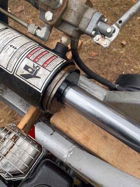

I have 35T Husky(Speeco) splitter with a blown rod seal. I am sure the cylunder is Chinese but I would like to reseal it if I can get the gland/head out.
I dont see any holes for a spanner or a retianing ring. There is a socket head screw and washer in the gland that looks like it would be for bleeding air but may be a lever point for unscrewing ? Here are some pics with and without the cap screw. Any suggestions so I dont have to buy a new $400 cylinder are appreciated.

That socket head bolt may be a way of grabbing the gland to unscrew it, as you suspect. Also look for a small slot in the side of the outside of the cylinder barrel, a half inch or so from the top to see if there is a wire lock.
Once off, it is easy to find the wiper and gland seal by size. I recommend the special tool to install them.

I believe you remove that bolt and then push that rod gland assembly back into the cylinder a ways to expose the retaining ring.

Yes, that is how it is built.....see video:

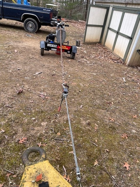

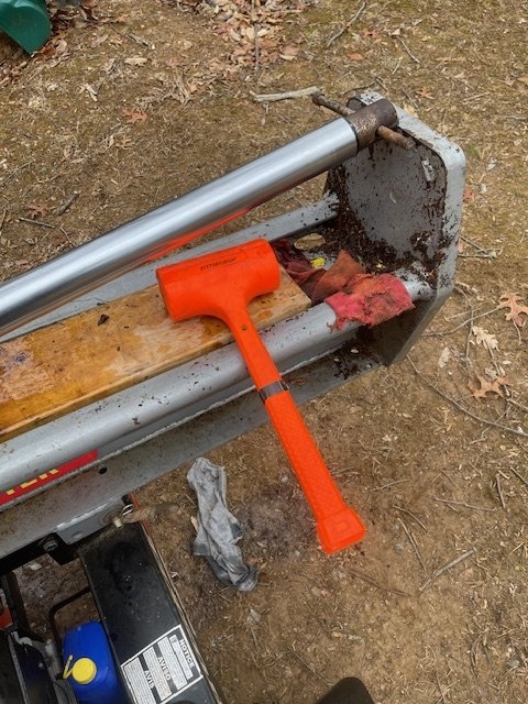

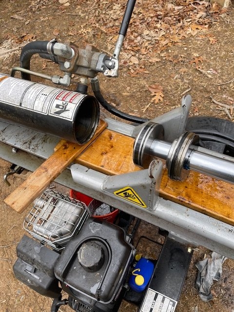

Ok I got it apart. I removed the screw and tapped the gland into the cylinder with a block of and hammer and pryed the retaining ring out.
I then started the splitter up and used the hydraulics to push the gland out as far as it would go.
I had to use a come along and big soft blow hammer againts the pin I had in the rod to get it fully extracted.
Now I need a good source to identify and buy a kit for the seals & O-rings
